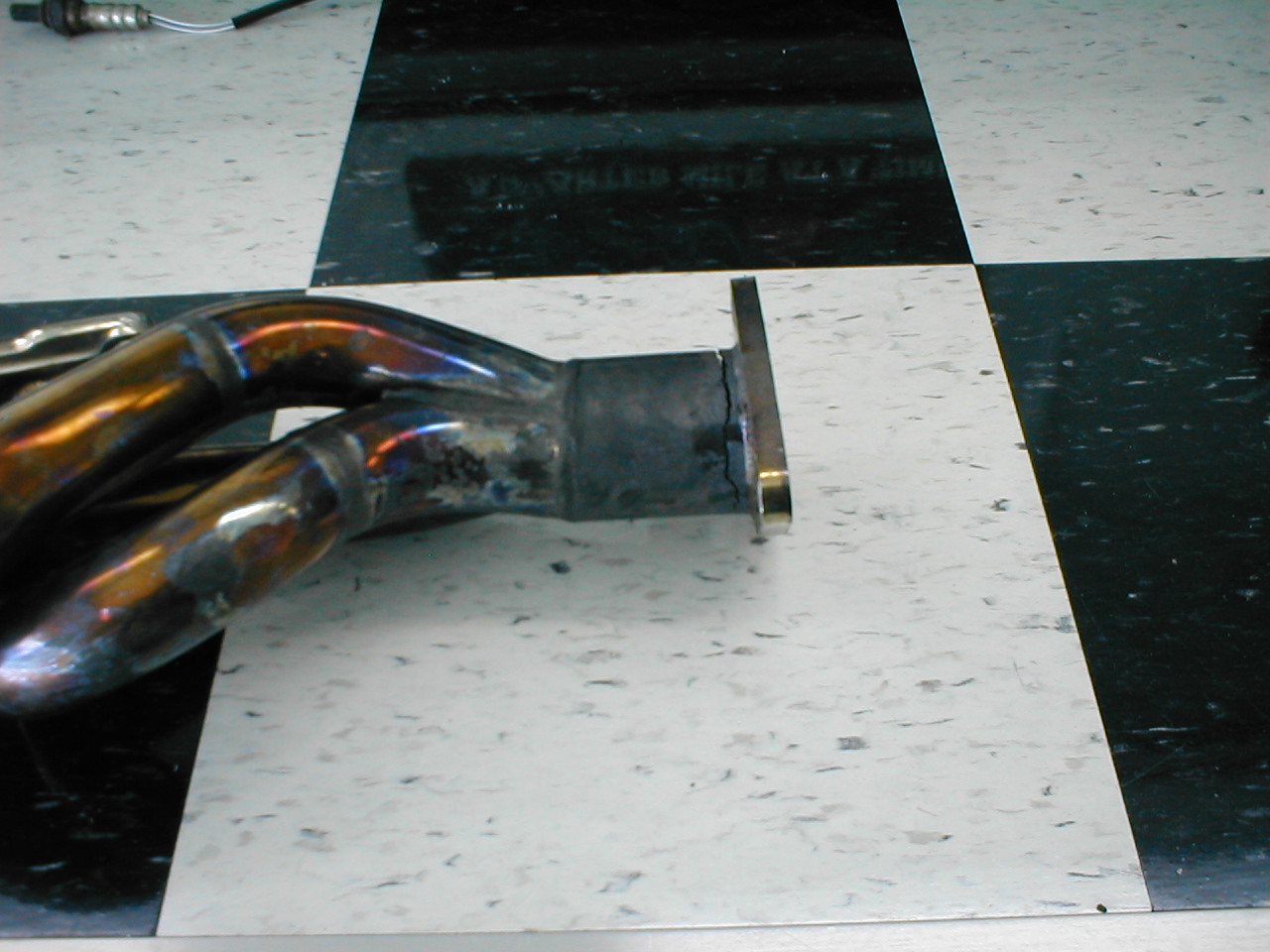

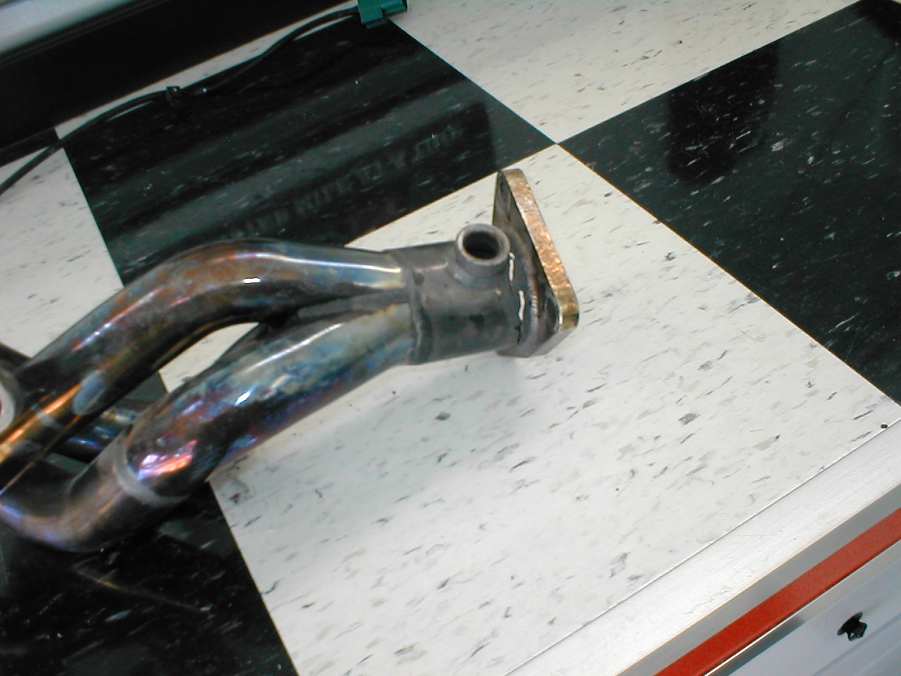

Today, I found the Passenger side Header was cracked at the collector flange. After removing the Header I see it's cracked about 80% of the circumference. It's also cracking at the other end of that same piece where the tubes meet the collector.
After further inspection it looks to me as if the collector tubing is different material than the the rest of the header as this piece only has turned black with no shine, and different than the Drivers side.

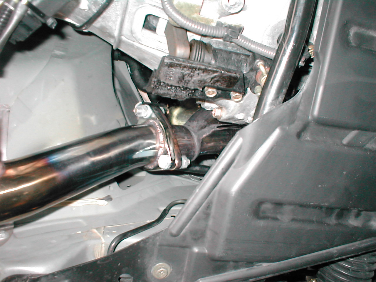

The Drivers side (installed) still has shine to the collector like the rest of the Header. This Header Looks Fine, No cracks. All looks like same material. Hard to see in the pic.
These Headers are AlphaWearks Headers.
Opinions of Pro's.......????

sure doesnt look like the same metal to me man.
And id bet thats your issue t be honest. im sure someone else who has done the same will chime in, but thats MY first idea for sure. very very hot area of the world of your exhaust...

the difference in color could be because the exhaust gas was getting all over it from the crack

That crack will definately cause that side to get super hot and discolor way different. I dont think you can saw its different metal from just the look.
too bad you dont have EGTs. I wonder if your passenger side has been running way hotter.

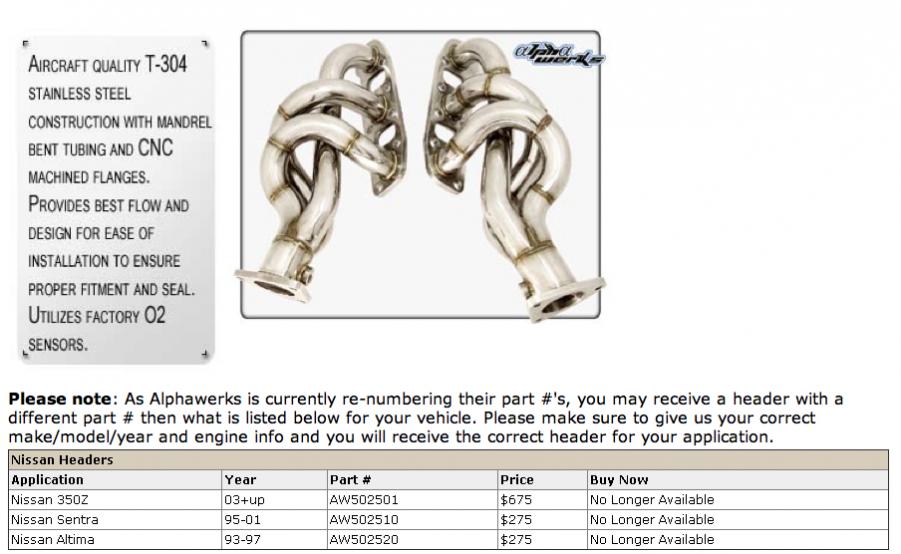

Check out there Add
Originally Posted by Boosted Performance
Check it with a magnet. If it is 300 series stainless it would not be magnetic.
Attached Thumbnails Hay JEFF, Like I Said, It's Always Something-screen-shot-2011-11-16-at-6.51.30-pm.jpg

its pretty common for headers and exhausts to use mild steel flanges and stainless pipe.
the first thing i would look at with a crack in the header like that, is mounting and alignment. the engine moves, of course, and exhaust piping expands, and the exhaust needs to have quite a bit of play to allow engine movement and heat expansion.
make sure your exhaust is not mounted too solid to the chassis. Make sure the motor mounts are in good condition. make sure the exhaust lines up well enough naturally so that there isnt a ton of preload on it when you snug it up... all the preload can absorb a lot of the play the system would have had.
flex joints on your test pipes would help if you dont already have some.

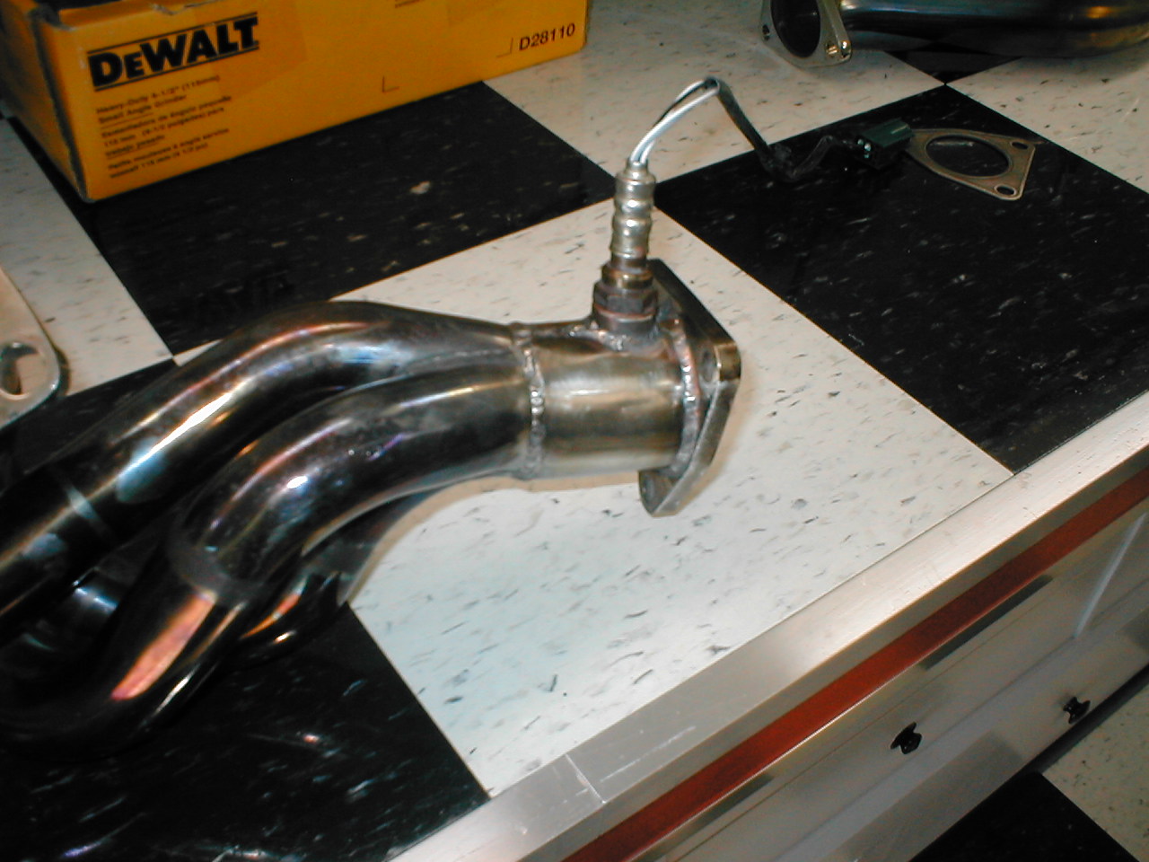

All Fixed.......
The guy did a nice job, tig welded it inside and out, then put a doubler sleve over, that was longer and tied into the main tubes..
