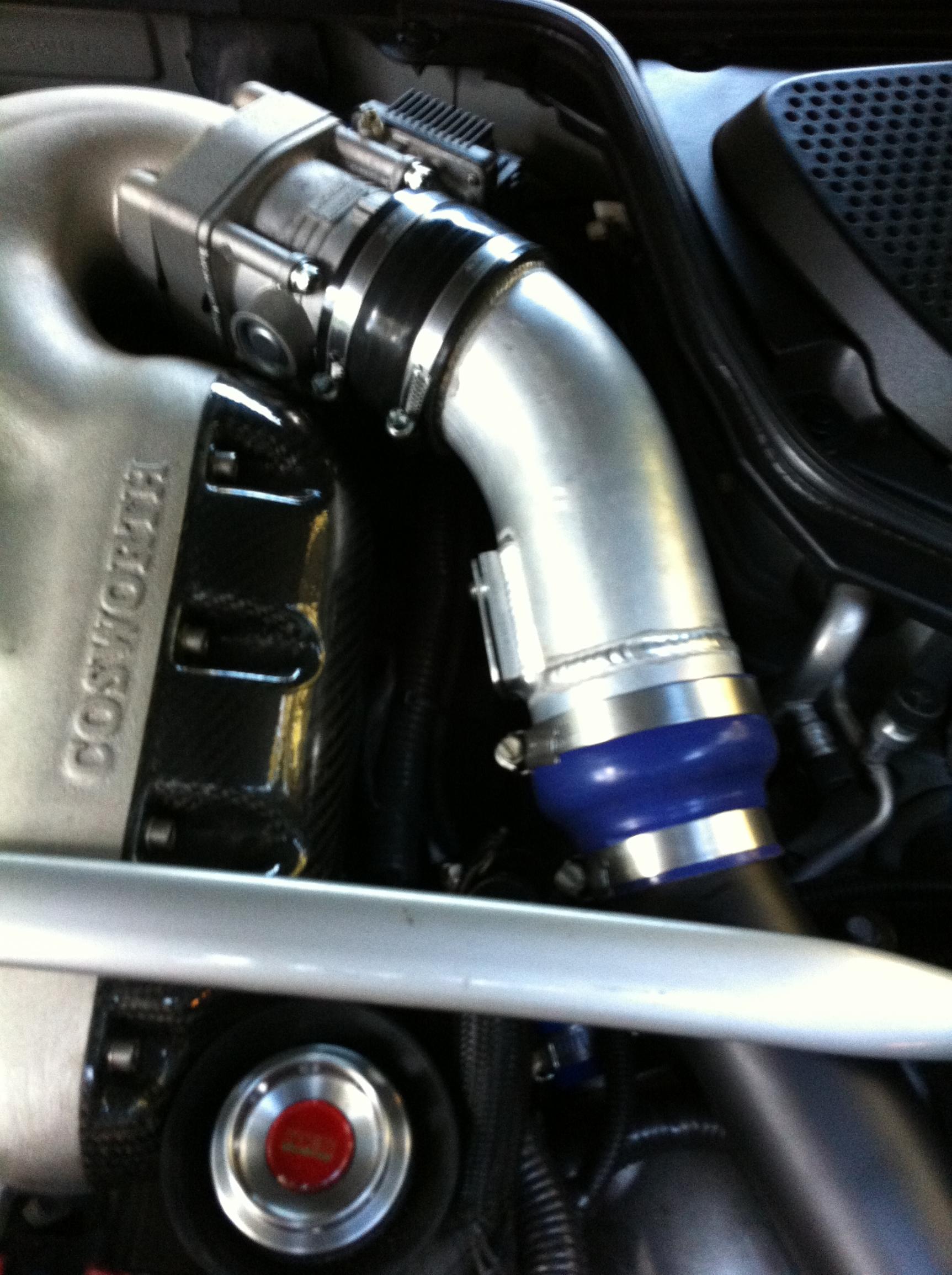

Hope the OP doesnt mind me asking a MAF related Q. I have an '06 fitted with an HKS S/C, DW 600's, Cosworth Plenum. I dropped the supplied Fcon in favor of the OEM ECU being tuned by my tuner ( he has written his own software ). He achieved 340HP on the factory MAF. The car has been running really well. Then i got the notion of relocating the MAF from pre blower to just before the TB ( post IC ) I had an 80mm inlet pipe fabbed with a new MAF flange welded in. With the new tune under way my tuner, just before he called it a day couldn't get an idle , said it was all over the place. So until tomorrow i'm reading up and i found this thread. What i have found is the ID on the original OEM pipe and the HKS pipe is 70mm not the 80mm that i had fabbed up, and the IC pipe now steps up from 60mm to 80mm at the TB.
I'm just trying to do some research here so does the change in the ID or a sudden step up of the inlet pipe playing havoc with air flow around the MAF?
Thanks in advance.

Sudden drastic changes in piping size can screw up the clean airflow through the MAF, particularly if the change is really close to the MAF sensor...
Thanks in advance.

Thanks for that , the step is within about 5-6 inches of the re located MAF.
Here is a pic of the new pipe before i drove it to the tune shop. MAF not yet in.
