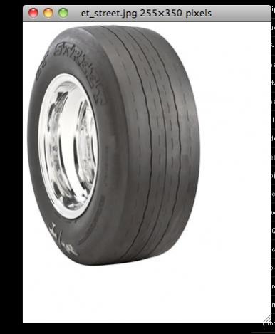

Micky Thompson ET Street
http://www.mickeythompsontires.com/s...?item=ETStreet
Attached Thumbnails Launching your boosted car?-screen-shot-2012-01-29-at-1.39.13-pm.jpg

alot of ppl run 15's and such but honestly i never had a problem with my 17" mickey thompson ET streets (3743) mounted on flix ftd wheels..they ran straight with no slippin around half track because they dont have a huge sidewall and they stuck just fine at my power level and i was on stock axles pullin 1.6 60ft's all day.

+1, ET Streets are pretty much the go-to tire, I love my 26x11.5x16's even with >2deg negative camber they launch like butter. M/T advertises they need little/no burnout but I disagree.. mine don't hook hard off the line and stay straight at the 1/8 unless I do a good 2nd gear burnout.
Even M/T themselves recommend against DR's on manuals.

That's the nice thing about ET Streets, If you do get some spin, it's a controlled spin. They don't let loose on you and go to redline. And you can control the amount of spin you want by the Air Pressure.
