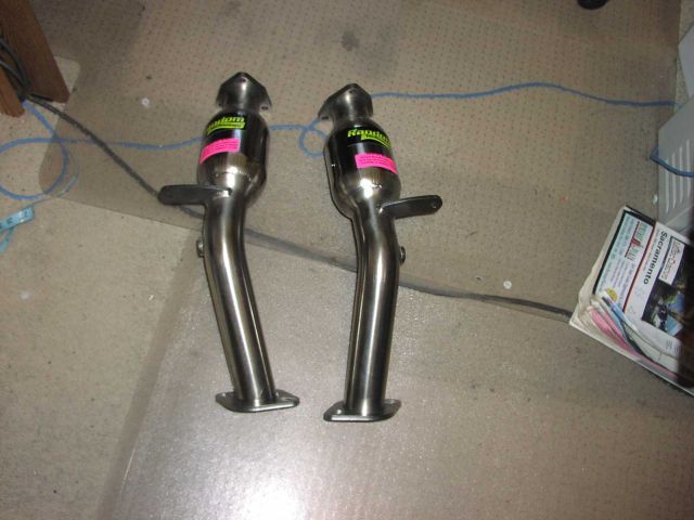

Sorry it is Niobium I think and I forgot the pic for others. An A5T rpm readings will vary from a 6MT I suppose because the computer shifts early for you in round town mode whereas a 6MT you control it not the computer. Plus I had my shift points altered.
Lots of variables.

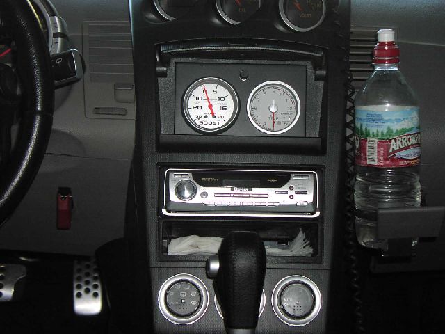

I think that 1600 F would not be high enough, I think my guage is 8 C x 100 which is 800C on my car with my guage.
I think this is where the confusion came in. The guage says 8 but it's times 100 = 800 but only reads 8.
You can mix and match if you like. I have an Autom Meter Boost guage and I love it, it's very accurate.
Just call ATI or GReddy and know because don't you have like 3 guages in your stock pod now? You gonna go boom too?
I thought I taught all of you about this FI Big Bang Theory haha!

12 sec - your Greddy gauge reads in C.....that means the "8" your gauge says is really 8x100C= 800C..your gauge reads to 1200C (12x100C), or roughly 2192 F
On pump gas, the highest I generally like to see is around 830 or so on the leanest running cylinder, almost regardless of the car we are working on (exception being a rotary, which inherently run hotter)

Let's just do it like this ok?
See how the GReddy EGT has a redline indicator after 8 and toward 9? This is bad like redline bad.
Just buy the Greddy and stay below 8, then we all don't have to calcualte C to F or discuss the effects gamma rays have on man on the moon marigolds.
