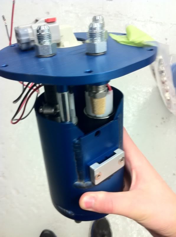

New CJM dual hanger fuel pump
New High Flow Fuel Rails
New ID2000 injectors in hopes of running e85
Kenne Bell Boost a pump for the CJM

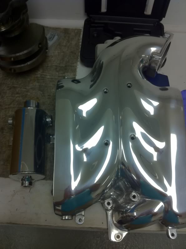

Cosworth plenum with CF end caps (ended up buying new metal end caps because previous owner destroyed the seals on them with resin)

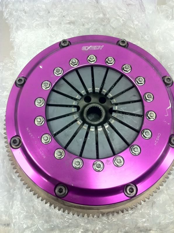

GTM Spec Exedy Triple Disc Carbon clutch

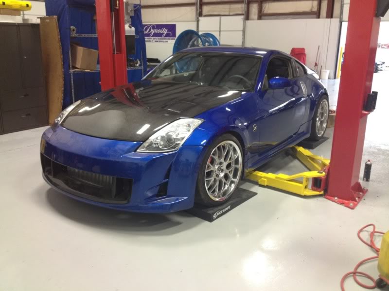

Drove up late last Friday night to take delivery of the car. After a day full of 100+ dyno pulls and hours of inspection, all in 100+ degree heat with awful humidity, I took the car out with the Dynosty guys to some local meets. Drove around all night, doing normal driving and some very hard pulls. No problems whatsoever! Then drove the car 2 hours back home to my garage. A strange, but awesome sight!!
Driveability is great. It pulls very hard and the curve is beautiful, especially without even using the electronic boost controller. I would change to a lower spring pressure in the wastegates, but to get to them, the motor has to come out This would allow me to run a littler higher boost and to also modify the curve some. But that will have to wait.

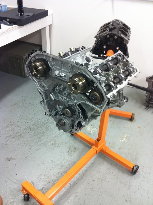

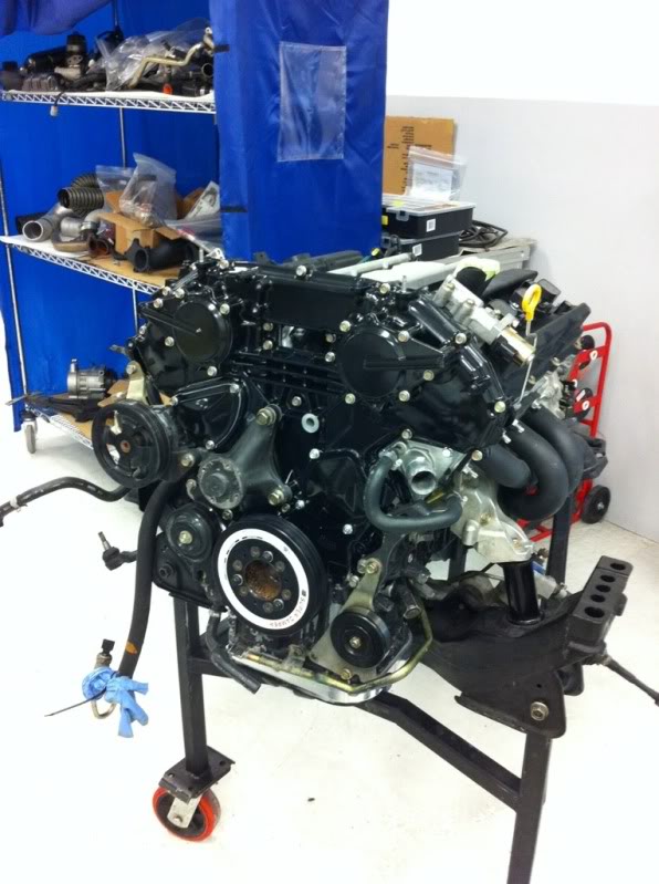

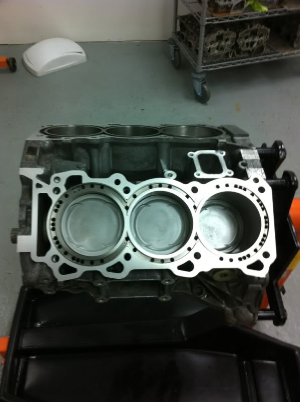

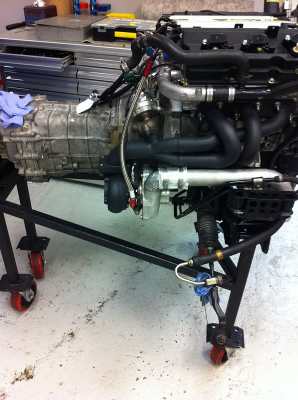

Here are some pics along the way.

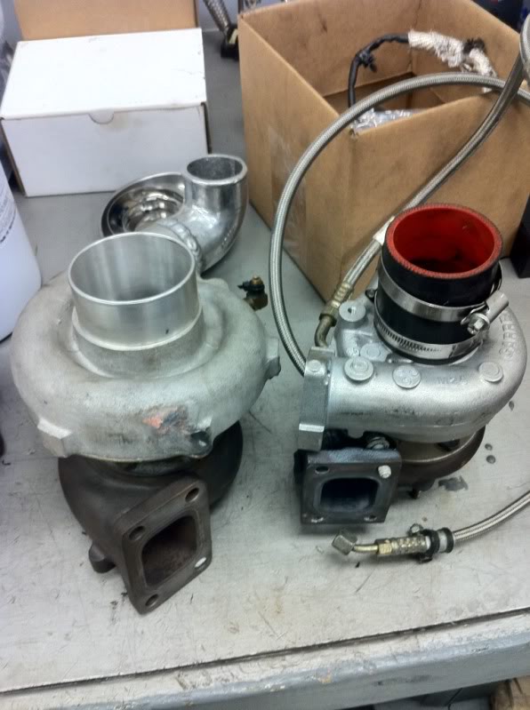

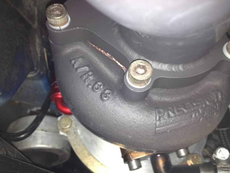

PT67 vs APS extreme turbos

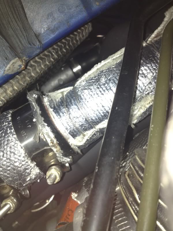

Charge pipe is now covered in heat wrap since pic

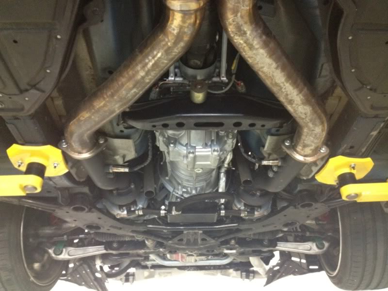

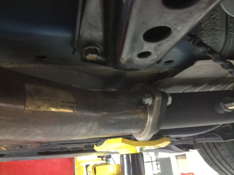

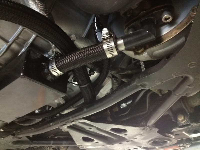

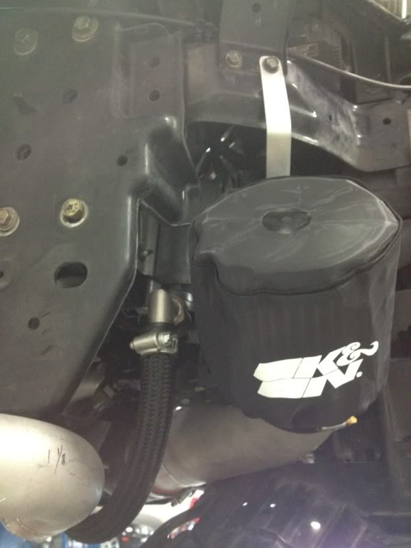

Various pics from under the car;

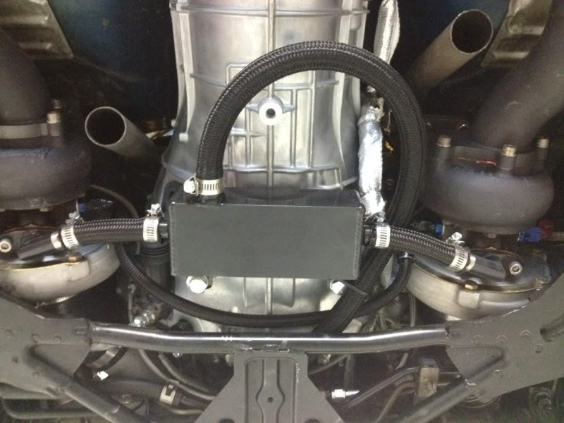

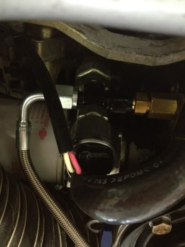

Oil pump behind driver's side intake

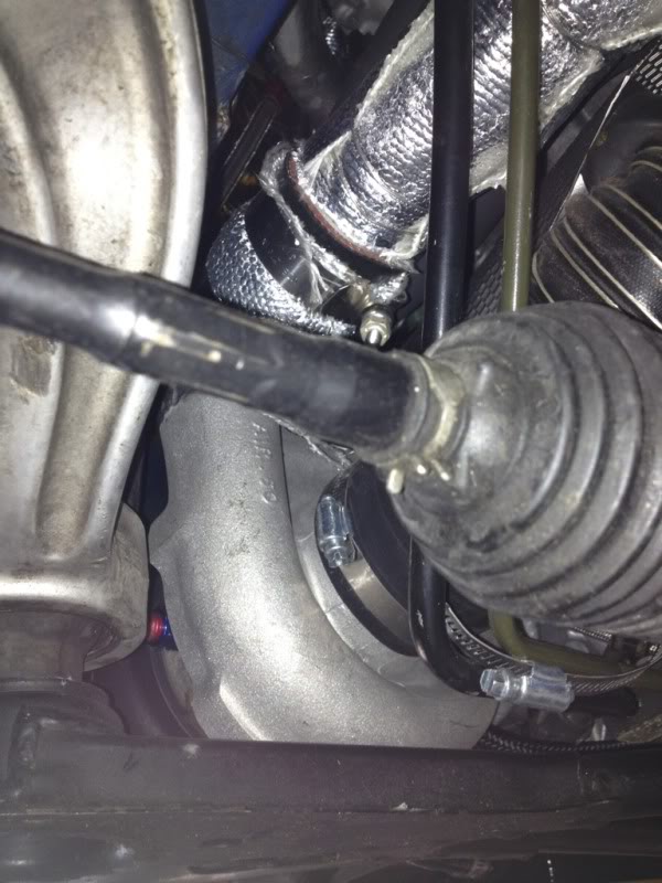

APS 3" and downpipe
Everything is so tight and wrapped in heat wrap lol

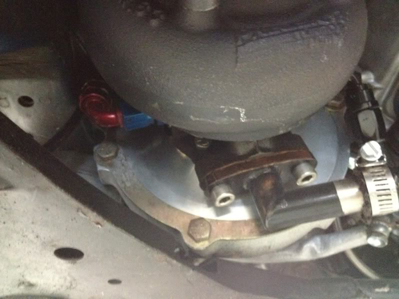

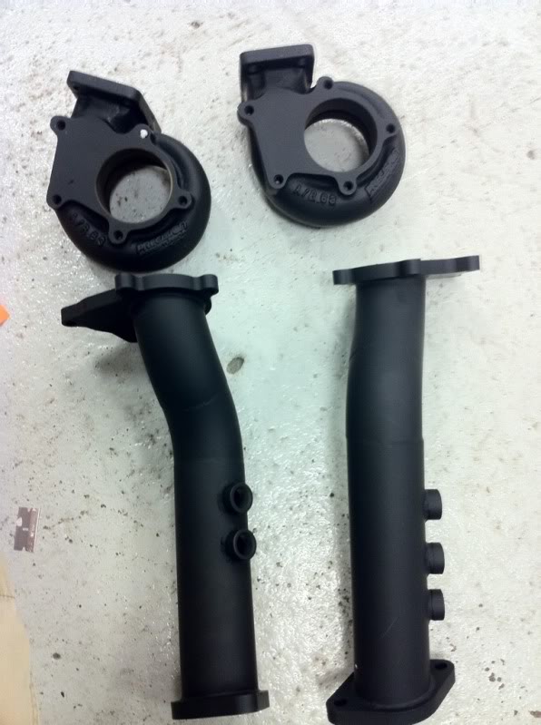

Looking up seeing wastegate and open dump

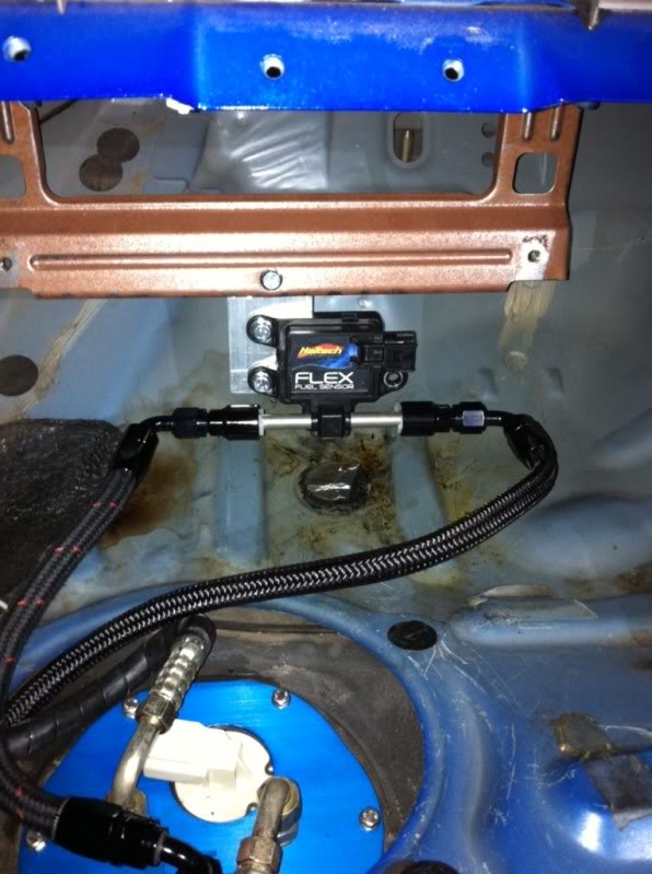

Haltech Flex Fuel Sensor

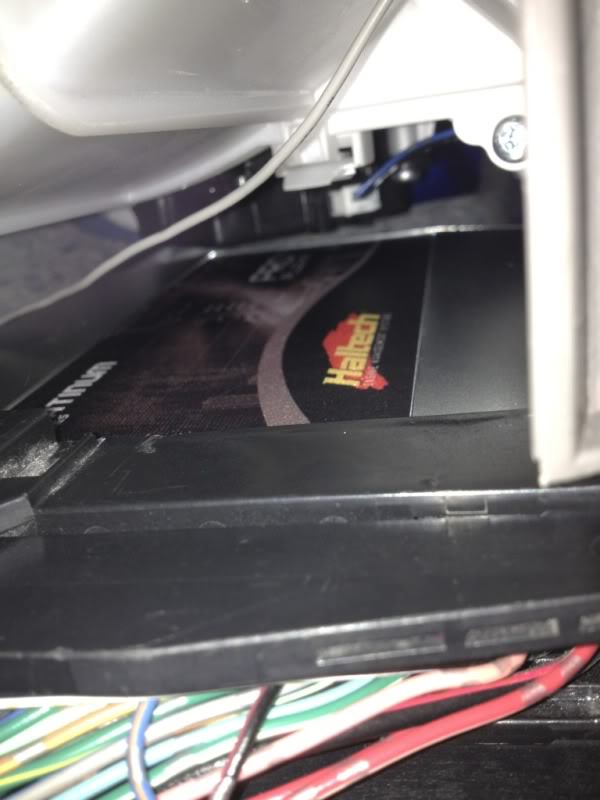

Haltech

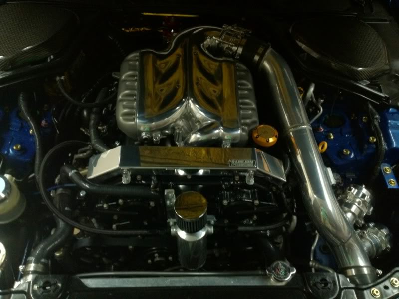

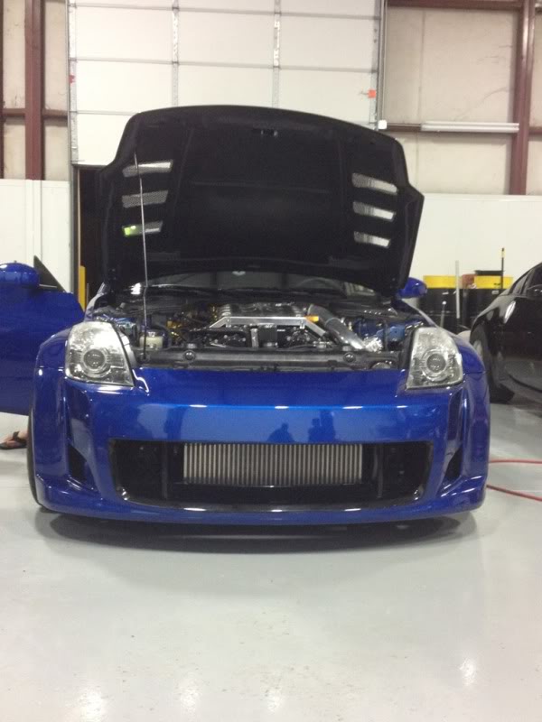

From the front, you see no pipping at all. You only see what looks like an intercooler core.

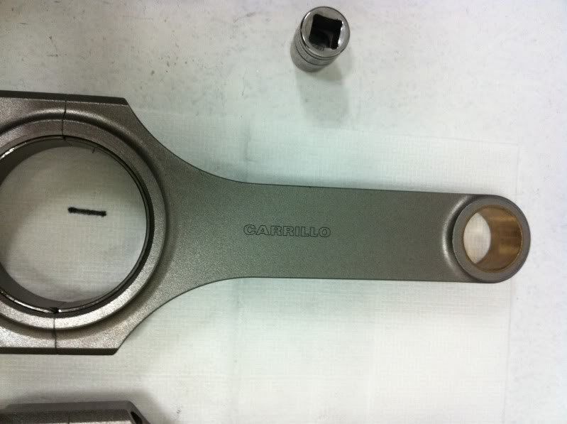

-Brian Crower 4.15L stroker Kit which includes BC 4340 billet steel crank (88mm stroke),100mm bore, CP aluminum forged pistons 8.5:1 CR
-Carrillo Rods

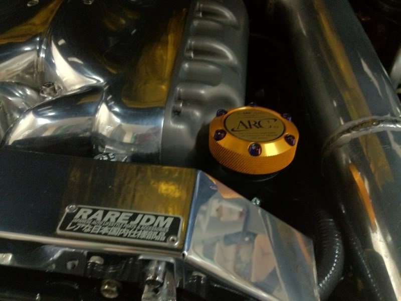

-Dynosty Oil Catch Can
-ARC Oil/Radiator Cap

-GTM Spec Exedy Triple Disc Carbon Clutch

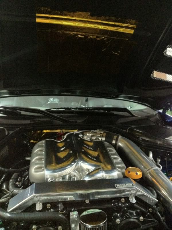

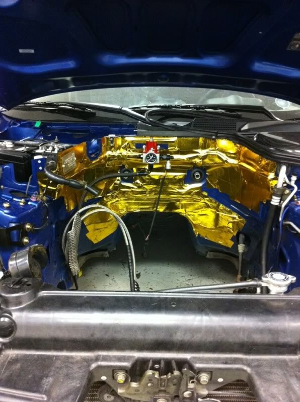

Ran out of heat tape. Gonna try to cover the bottom of the hood to try and reduce temps of it. This engine produces a crazy amount of heat and don't want to risk warping the hood.
Going to be repainting and fitting the body kit, along with painting the hood leaving the CF at the vents exposed in a few weeks. Later down the road, will also install an oil cooler. Very far down the road, new clutch and actually trying to make this set-up break a sweat!

Originally Posted by Nlower2
Sick build. I read something about the cjm twin pump hanger being modified for the 485 e85 pump. Is that the setup you are using or are you using twin 255s? Anyways, Bada$$ build.
CJM has modified the pump to incorporate one 485 and one walbro. Testing still needs to be done on it before it is set to be sold though. Currently I am just running the dual 255s. I don't need any extra fuel yet. Once I get a new clutch and can turn up the boost, I will be using the modified CJM hanger.

Originally Posted by lgear080
i like your build... alot. Can you hardline those tubes near your subframe?
I'd destroy those immediately, but maybe your roads are better.
a few body details and you've got one of the sharpest builds in north america.
I could probably hardline them, but they actually don't hang that low. In the pic it sort of seems like they may get snagged on something, but I will try to get a pic from the side or front showing how high they sit. The roads here aren't too bad but I would really have to encounter something very odd in order to snag those lines. But I guess you never know ha. Thanks for the kind words about the car!
