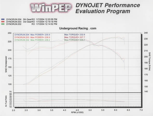

here is the base line dyno sheet.... mods in this run are, intake,exhaust,grounding kit

Alright guys. These are not the final dyno number but somewhere around there. As of now, the car is putting out 351.8 RWHP and 302 pounds of torque. They are smoothing out the fuel curve and retarding the timing a little bit more just to be safe. I should be out of here in about 2 hours.

we got even more power 359rwhp and 305lbs torque !!!!!!
