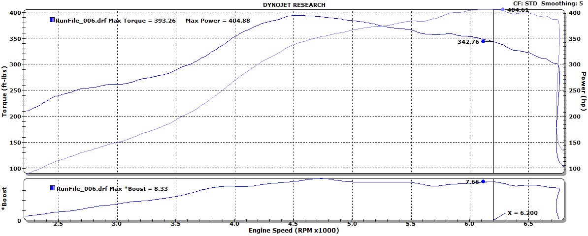

Bro dont worry about your setup, its fine. I have 02 Maxima (VQ35DE) a PTE 6266 BB turbo with .82 A/R Vband (stock internals)......graph is pretty similar to yours except my boost doesn't hold as steady as yours. The cams in the 350zs are different from the Maxima cams. Everyone was saying the same thing about mine.."ITS LAGGY" BLA BLA BLA....if it dont feel laggy to you then that's all that matters. Not everyone going to have 800whp 350zs with darton sleeves, cams with 4.1L stroker kits. You are making 416hp & 405TQ only at 6.3psi on stock internals, thats fantastic! If u want to up the boost then build the block. Don't want to see another BUSTED boosted VQ engine thread. I would not even bother with an EBC with that setup...looks good to me.
Here is my setup....
