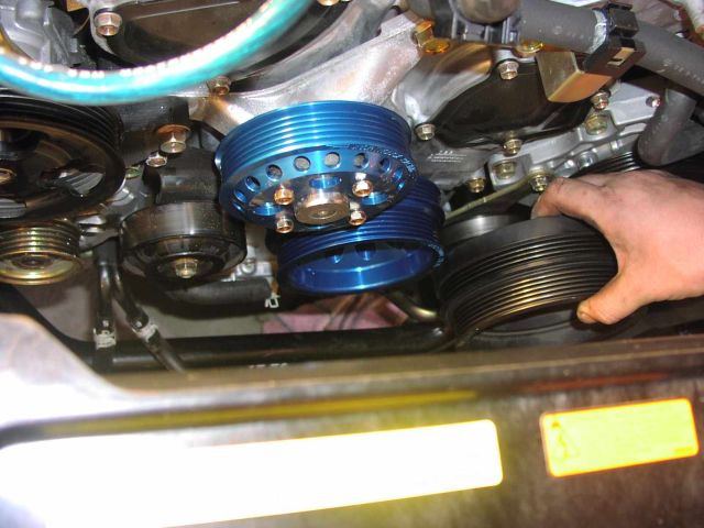

Wow..Someone got defensive real quick...I meant 9PSI of boost..Or 9lbs however you put it..I would investigate as to why your pulleys have more teeth than the rest of us but I think more teeth would cause the sc to spin slower no?..Oh wait a minute, Max,This pic shows the UR pulleys still on your car minus the Crank pulley..Did you leave them on?That may be the cause of you getting different boost levels than the rest of us..I dont even get into boost until 4000rpms and only register 6.5-7psi total..Maybee the lighter smaller pulleys have something to do with it???Has anyone determined if running the Crank pulley will slow down or speed up the SC and increase or decrease boost??It may actually help rev the engine faster and get into boost faster? Hmm..I think I smell another topic for debate to come...SC+underdrive pulleys...Do or Dont..

If you have an underdrive crank pulley it will decrease boost.
That pic is obviously pre SC because the top pulley is removed entirely when you install the SC kit.
Ok..That makes sence..Then what would the effects of having an UR crank pulley lowering boost.Then adding a 9psi pulley?Would this bring you into the 8psi range but allow the engine to rev up faster??Would that be benificial or detremental??

Daking with all due respect, you have lost me. You are posting pics of my N/A setup that was a 13.4 and 13.6 and confusing my plug conditions, and pulleys and pics all in one thread. I'm trying to follow but it is hard ( the thread no me lol )

You can't use the under drive crank pully on the Procharger BTW.
Your rasing good points though. Why *DO* I make boost at 2800 if I want to and you don't?
