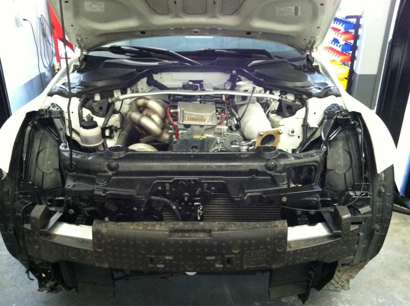

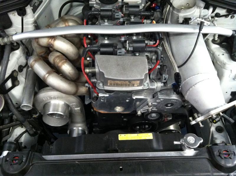

I got the front end back on but unfortunately I have to pull the intake manifold off and modify it for better TB placement. I'm also going to swap out the compressor housing for a straight outlet. I did get the A/C and PS lines all hooked up.

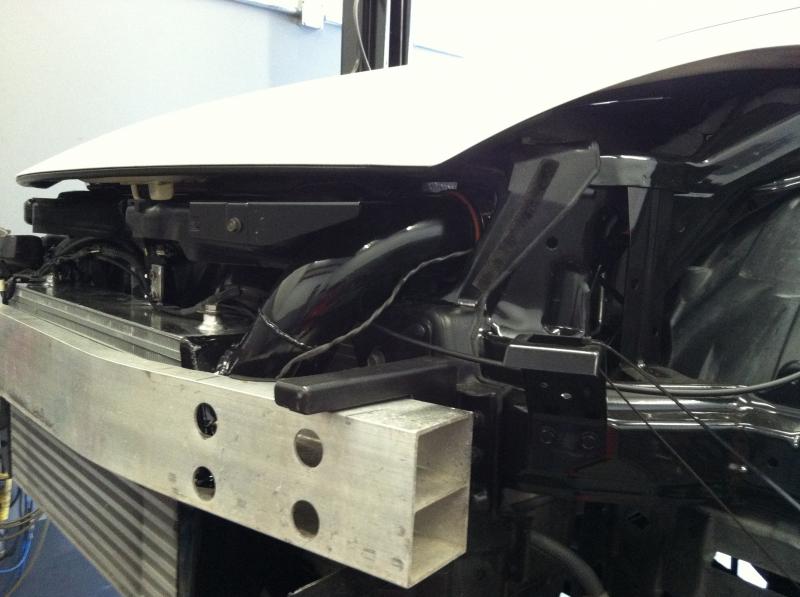

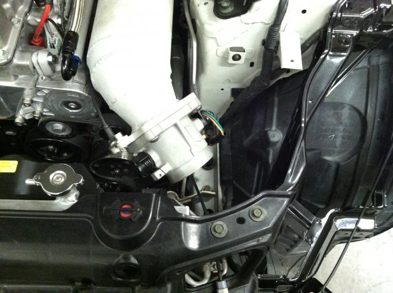

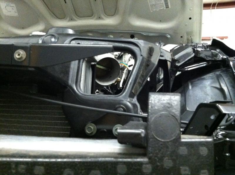

Here is a shot of the intake manifold after I modified it. This leaves the throttle body in a perfect position for a 45deg silicone coupler to go through the factory opening in the front core support. I ordered the couplers and t-bolt clamps I need tonight and they should arrive around the same time the intercooler is done. Tomorrow I plan to cut and re-weld the turbo compressor housing outlet to point where I need it and then it should be good to go. I also need to come up with a solution for the coolant hoses to the radiator. I'm thinking custom hard piping with silicone couplers if I can't find a rubber hose solution.

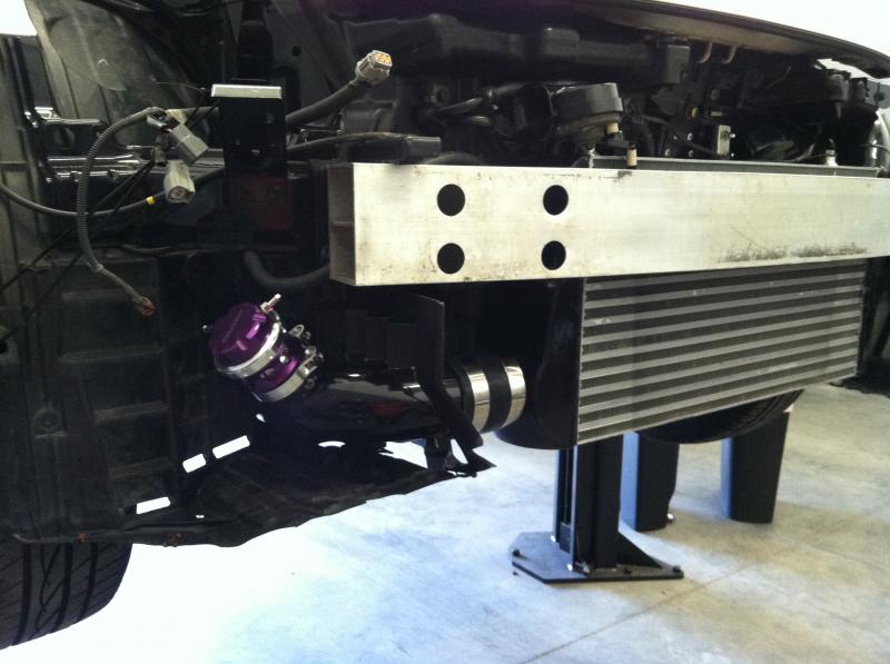

I finished the intercooler and all the charge piping and took the car for a little ride and I must say it's a nice feeling after all the hard work. The best part off all is it's not loud in the car like you would expect with a 3.5" exhaust. I'm blown away by this.
