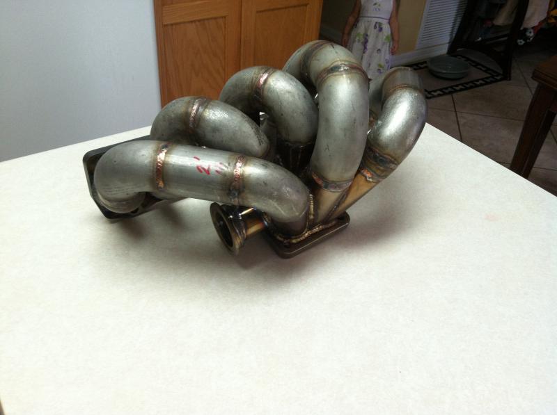

I finally have had some time to work on the Z. I got the throttle body installed and cable hooked up. I have a few little things to button up under the intake before it's done on that side. Turbo manifold is all welded up and it looks great, thank you Kiko Engineering in South FL. I need to add a support brake that I'm going to run to the engine mount to help support the weight of the manifold and the turbo. I'm going to have the flanges run on a mill this week to make sure they're are flat and then I can get the turbo installed finally. next will be the fuel system and Megasquirt Pro module install.

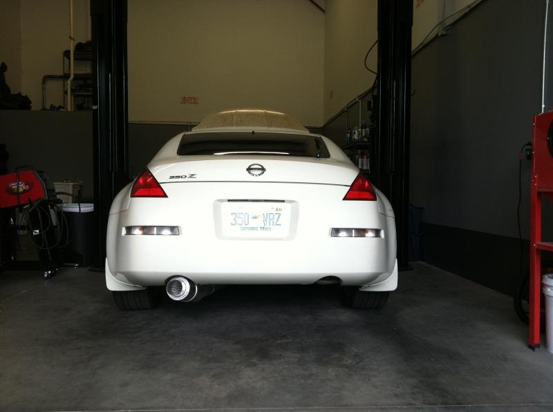

I was able to finish up the exhaust today.

Old Aug 4, 2014 | 07:33 AM
  #290
joshua350z6841's Avatar
joshua350z6841
Joined: Sep 2012
Posts: 509
From: peoria il
exhaust looks good. love the flow

Thank for the compliment, I can't wait to hear this thing run!
