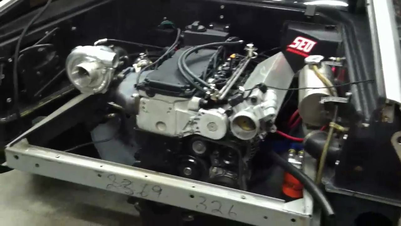

Here is a little clearer video of the engine running; it's still far from complete.
http://s40.photobucket.com/user/craz...c13ba.mp4.html

Here's a few progress pics of the manifold, only two more runners to go. the DeLoreans have been taking up all of my time! I also keep updates on Facebook (SEO Motorsports).

Here are some progress pics of the VR6 DeLorean.
