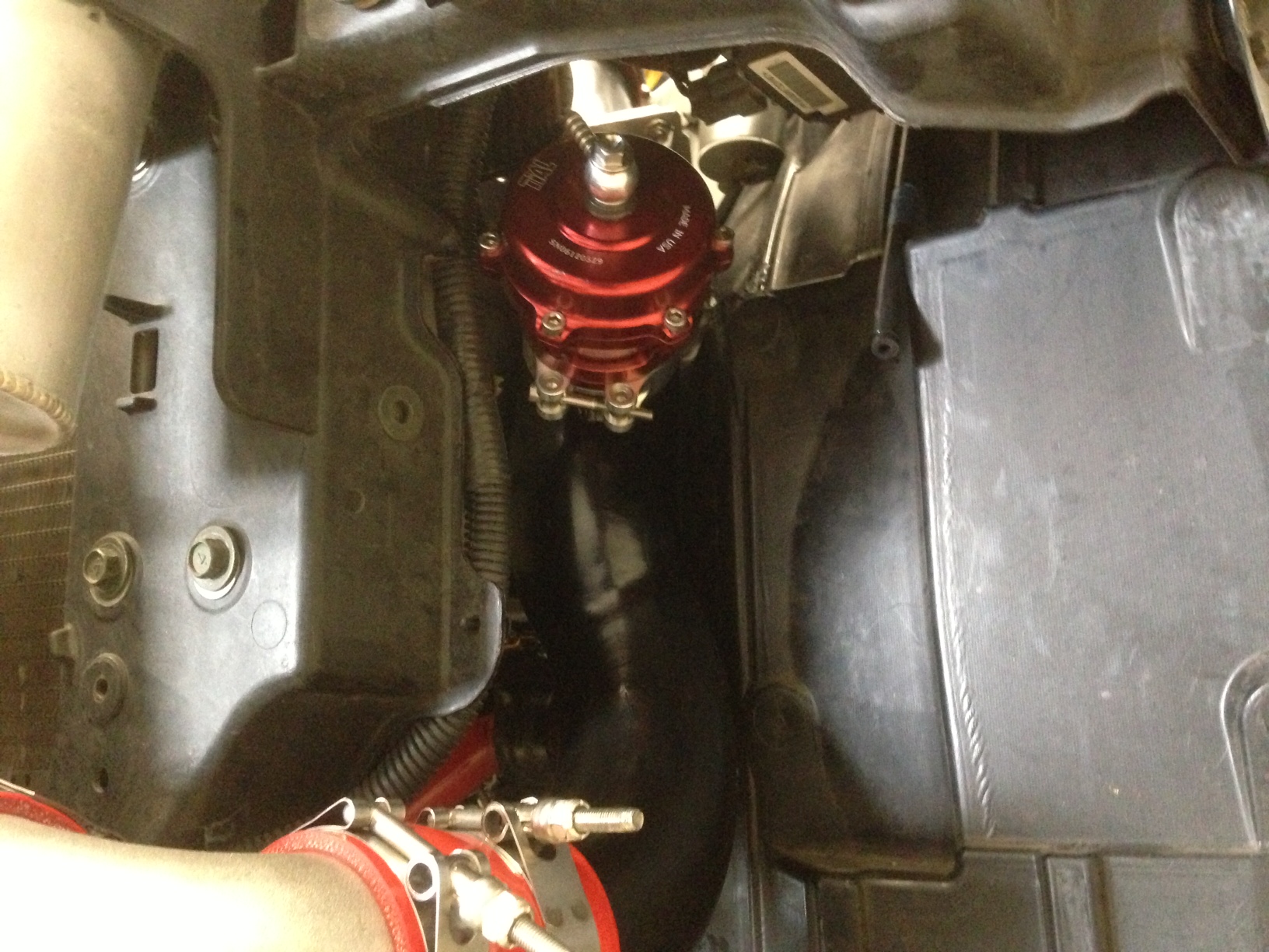

Tial Q 50mm BOV

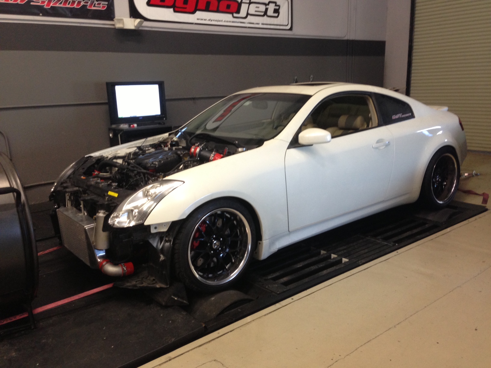

After being being tuned she made 500 HP at 11 PSI for low boost and final numbers we were able to make was 727HP / 574 TQ at 16.5 PSI. All this was with 110 race gas. We could not get it to boost past 16.5 PSI. We believe it has to do with the wastegates, but we could not adjust them. I really think the car is capable 800+ HP if I can up the boost. I am quite satisfied with the numbers as I am making 125 more HP at basically 2 PSI less boost.

Are you dynoing it with ice bags on the intake? I would like to know more about the turbo upgrade, I thought the housings were already bored and stuffed to fit the 3071s. I thought billet wheels would be the only upgrade we could do to the 850bb kit? Looks like in the end you have a great car
Trending Topics
Thanks for the comments. Ok I called the turbo shop that did they the work and they said the turbos were 3071's and they bored them out further to 3076's. The only thing left would have been going to the billet wheel which in hindsight I wish I would have done. Also forgot to mention I added the Injected performance billet main girdle.
Yeah those were ice bags on the plenum and intake pipe. That was towards the end of the dyno session and the car was pretty hot so we used the ice to try and cool down the engine some.
