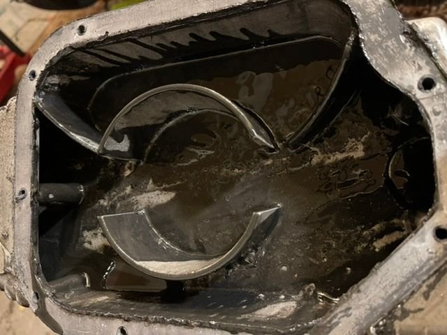

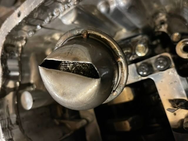

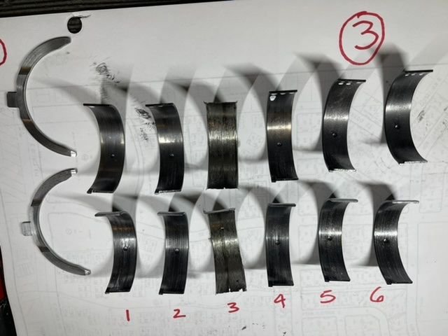

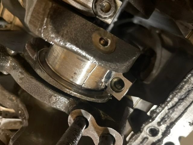

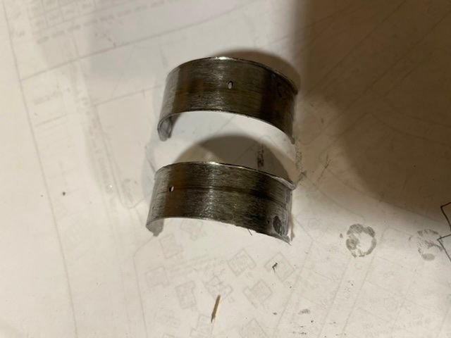

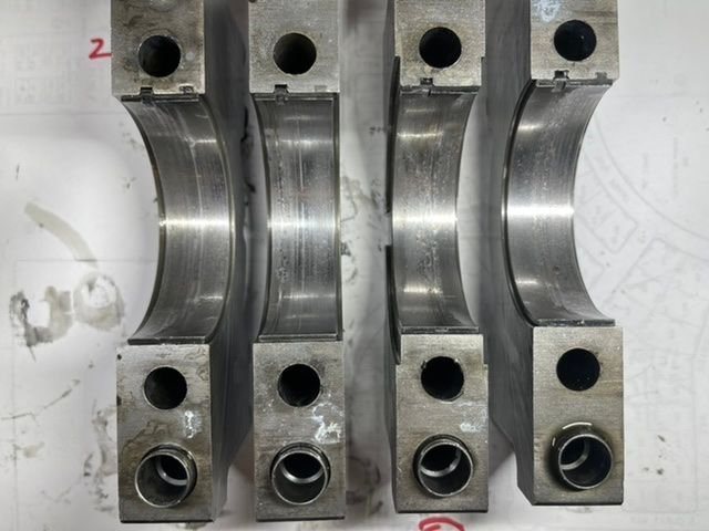

Yup…guilty party is cylinder #3…
initially as I was wiggling the rods rod three didnt move much, noticable yes, but not nearly like I thought it would or like cylinder #4 did back in 2018…turns out the bearing rolled up onto each other.
Initially, I was sorta disappointed with King Bearings and (without knowing or really conceptualizing the fault) it was easy to think they make sub-par products but aside from the failed bearings and some minor wear on a few other rod and one main bearing they all look pretty good. I dont know if the pictures do them justice.
the oil residue in the oil pan is pretty thick and I think it’s a by-product of break-in oil with microscopic metal reminiscense from the the ring bedding process - but there is bearing material in there.

ouch is the crankshaft salvageable?

I think it is … I have a buddy that works at CAT and he cleans them up for me for $100. I have a few cranks available and they are pretty inexpensive if you get them from a VQDE murano or a maxima.

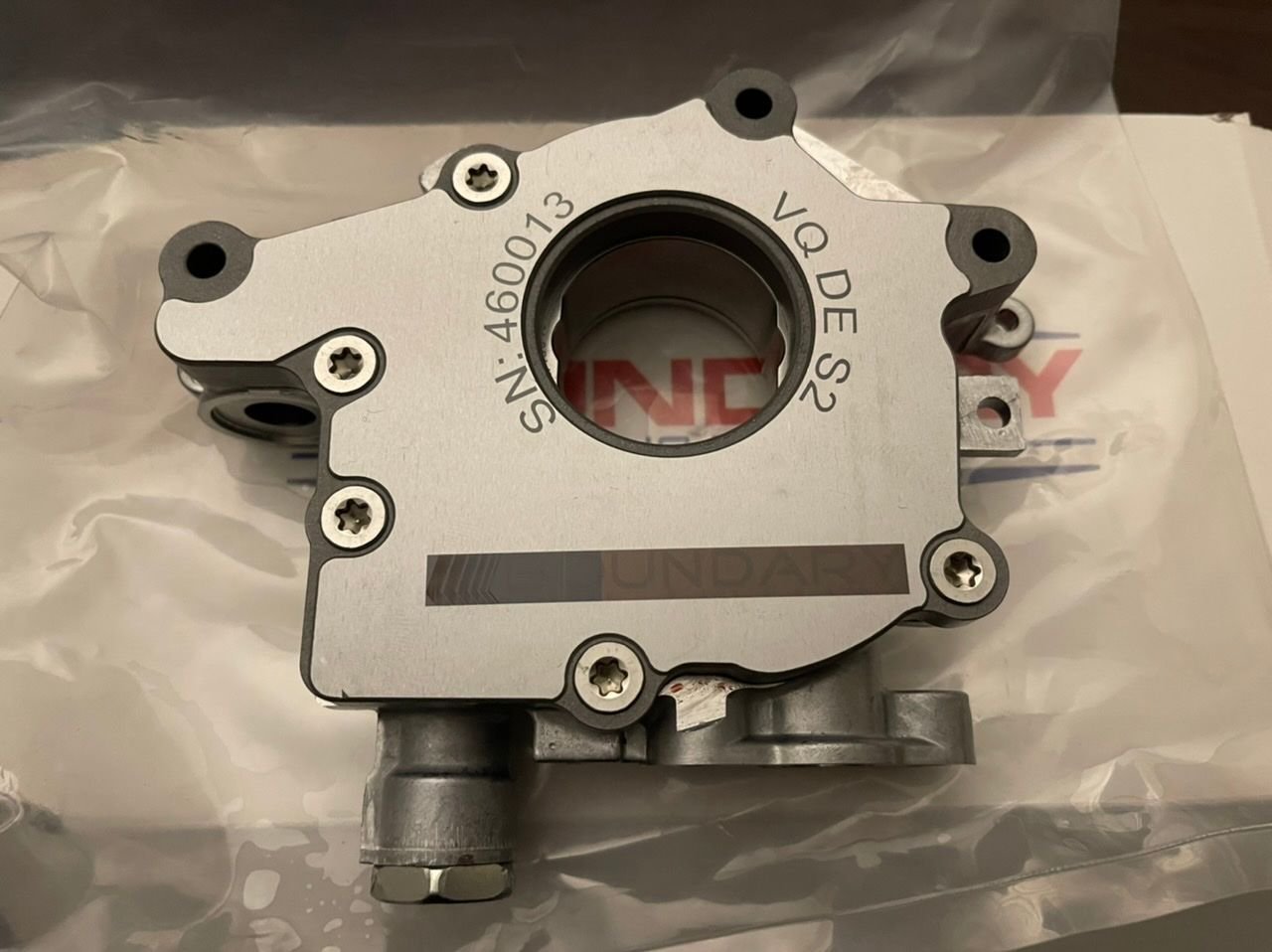

Machine shop called … block is ready to go - gonna try to pick it up tomorrow or Friday… I secretly wanted to build two VQs at the same time, I secretly didnt…
and, this came in…
