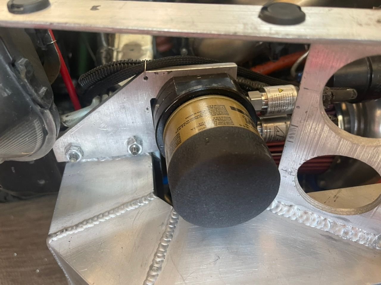

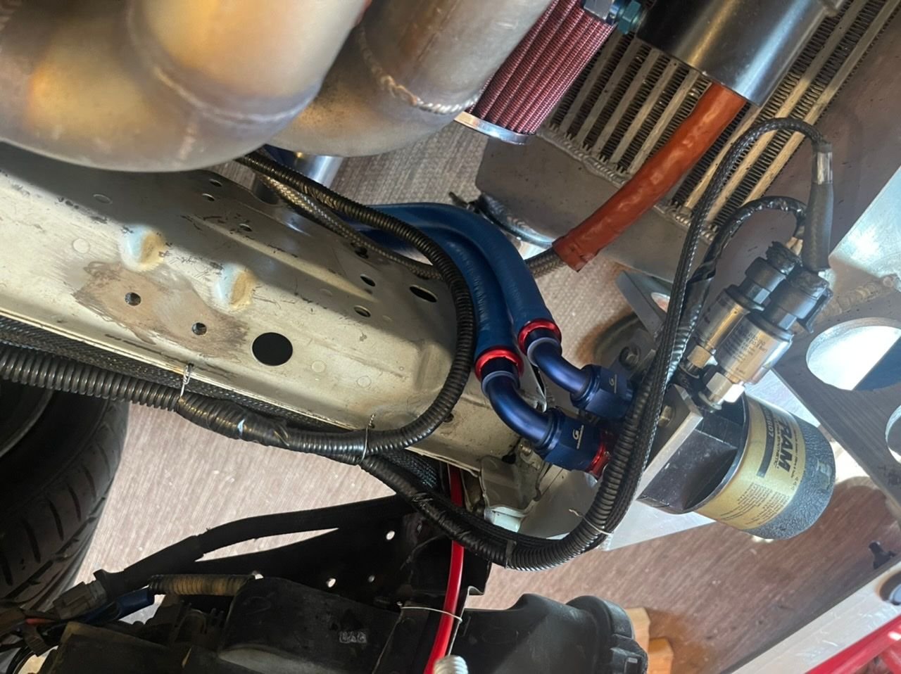

Oil filter bracket
Oil filter setup …

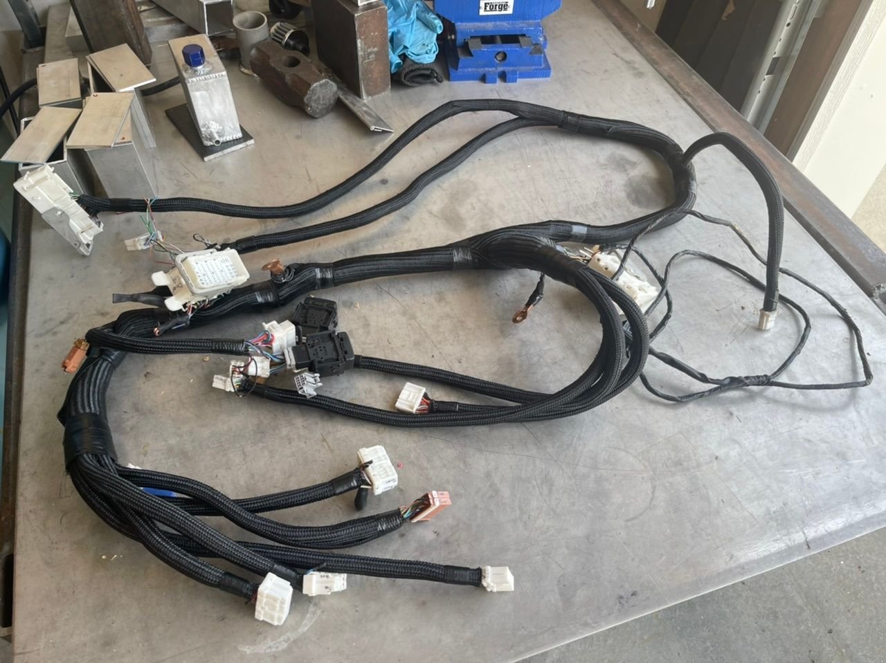

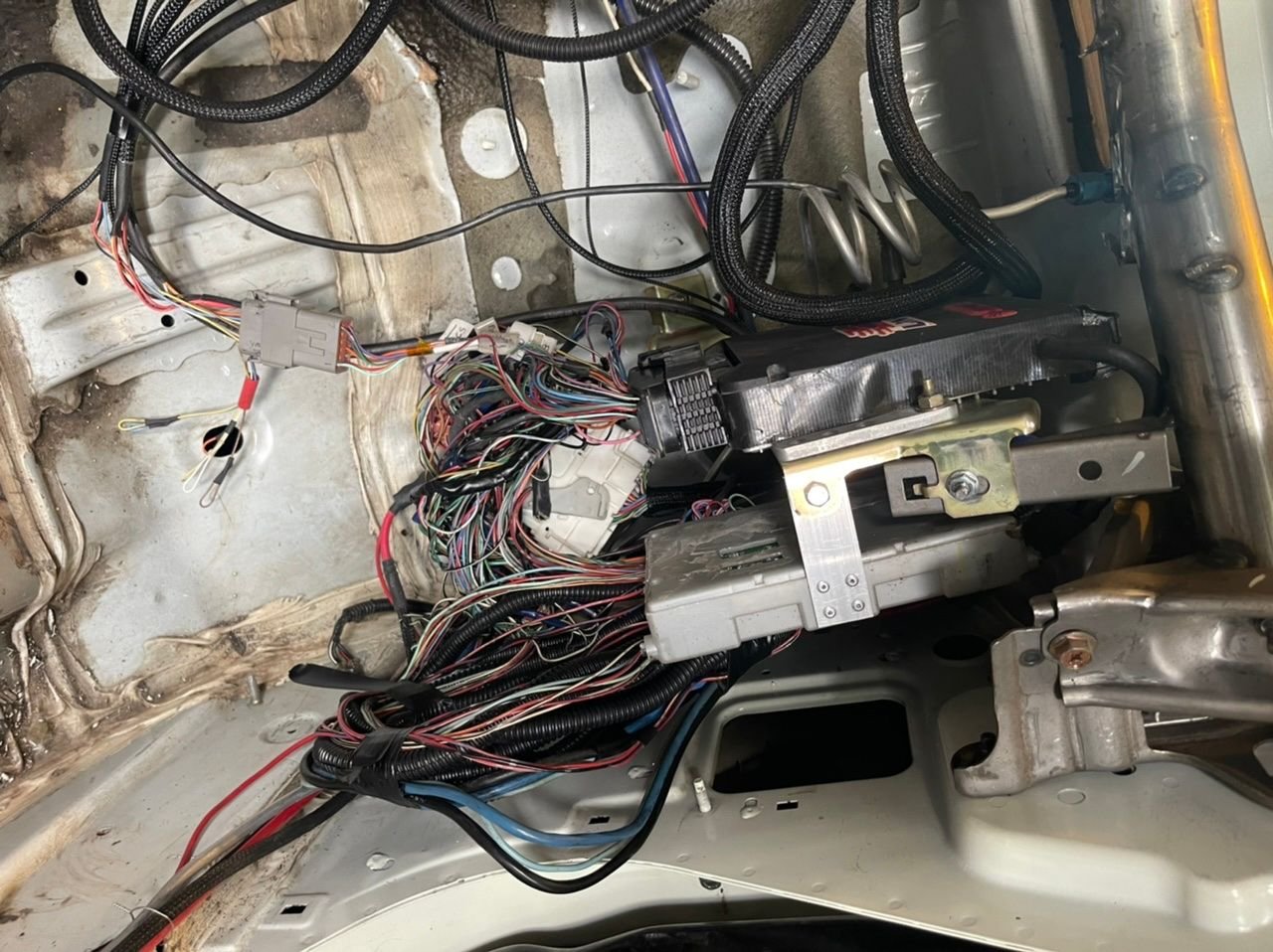

Wrapped interior / dash harness - sorta temporary

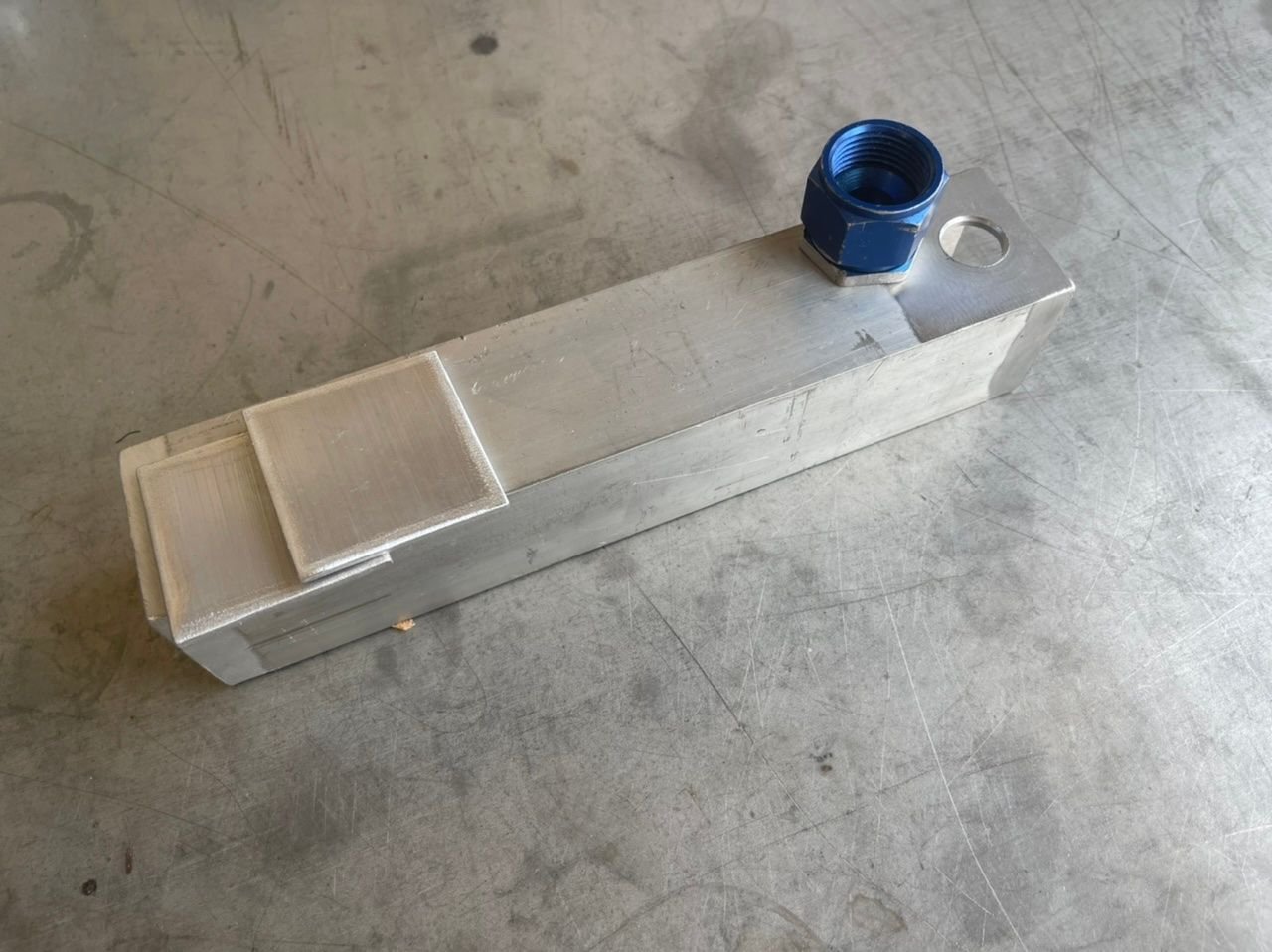

Turbo drain sump box

Found a better way to mount the AC Amp box and also more wiring that will be removed when I re-do the engine harness. Not the mass of wiring curled up … sorta the background effect of a wiretuck.
Also really considering going with a power management unit to replace the the OEM IPDM and fuse boxes … HPA has a course on how to transition from and OEM setup to a PMU and it might be something that really simplifies things in the car.

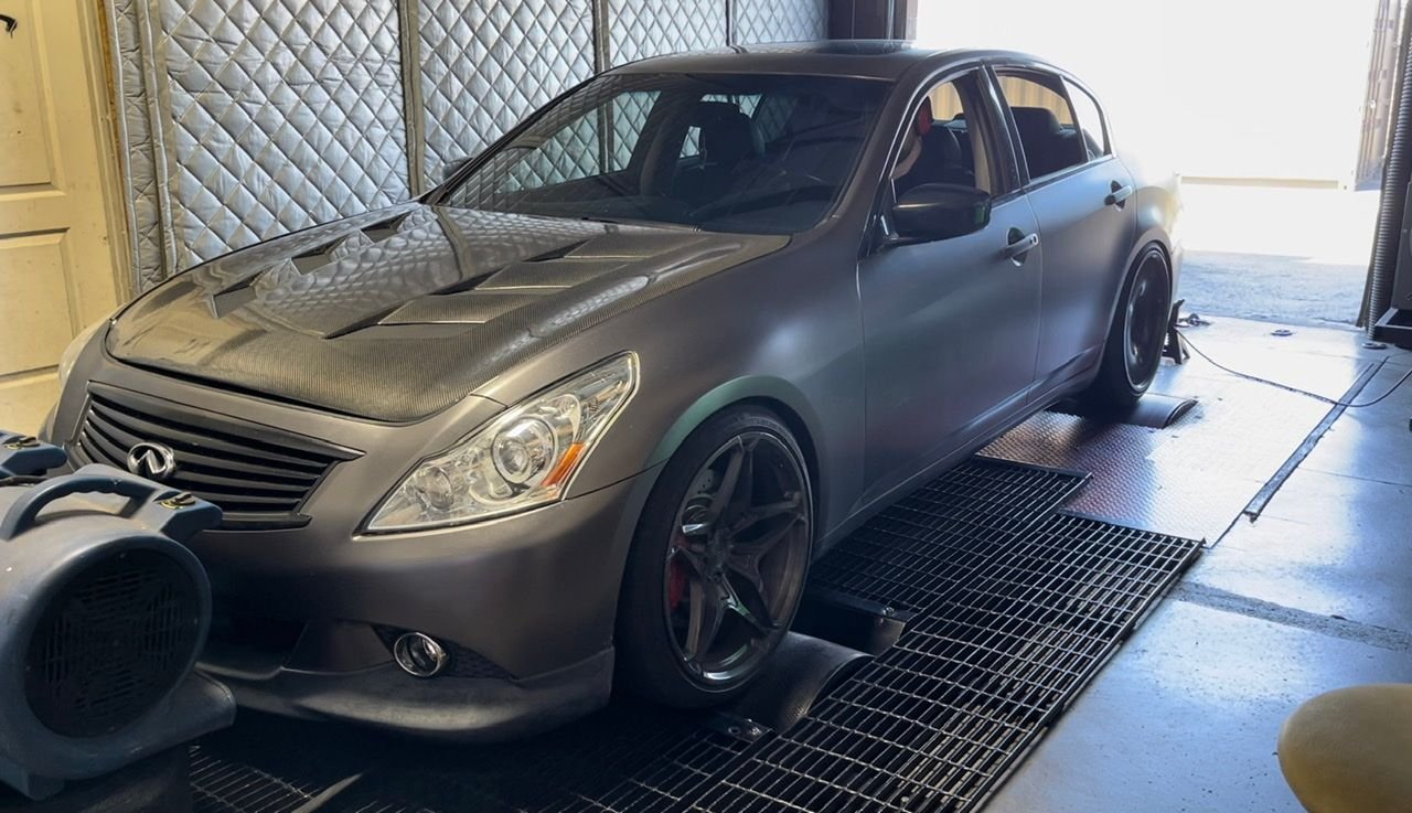

Big day tomorrow morning … the q40 is 100% wrapped up and tuned and I have a dyno appointment to get some numbers of what she puts down. I’ve been driving it semi-regularily as my pickup is in the shop … It is actually very fun to drive and I can see why/how people love the VHR engine…

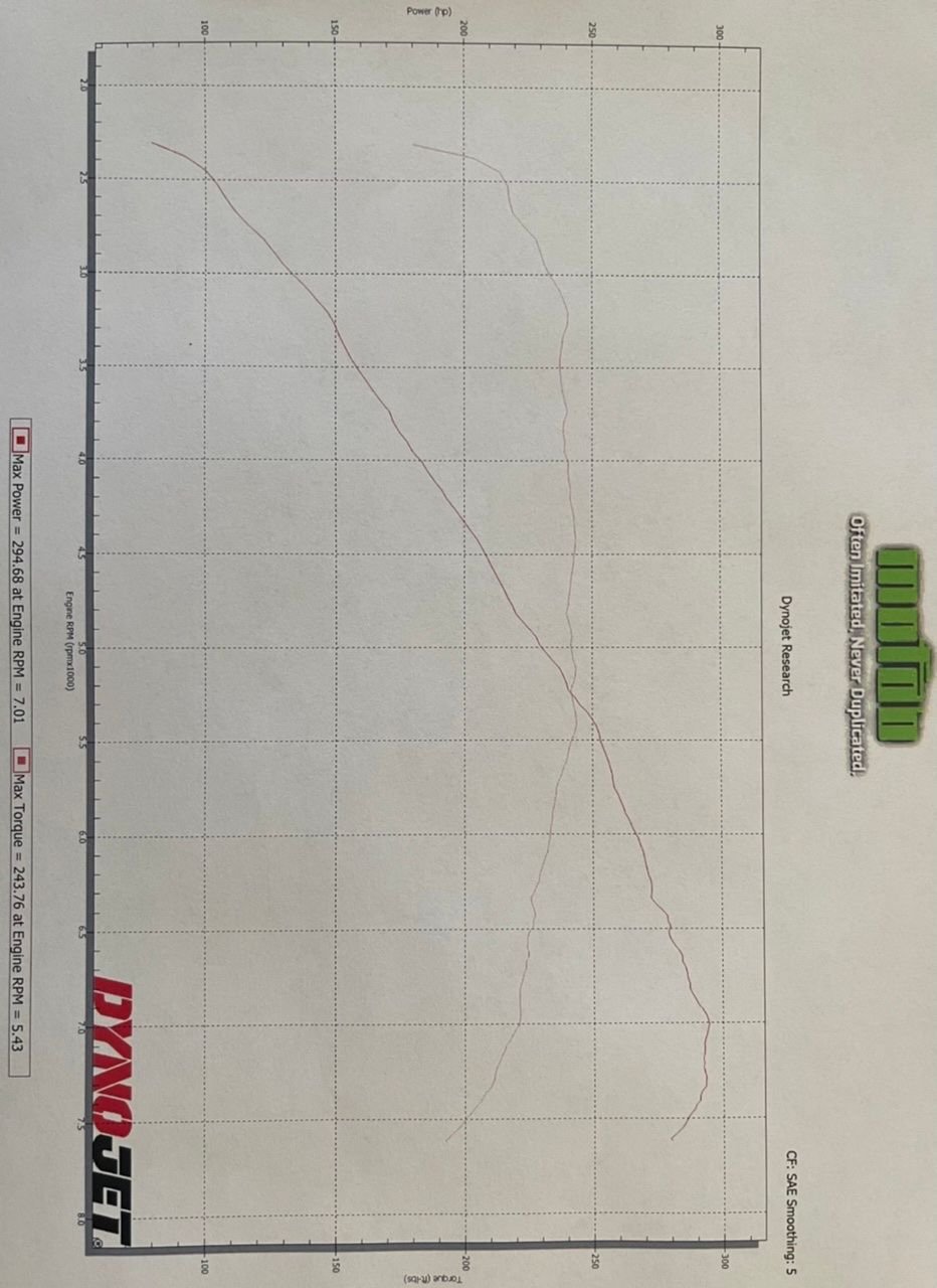

I’ll post it up here (and not it’s dedicated thread) but got the q40 100% (street)tuned by Moncef … he really took care of me and I’m very happy with the end results … I know its 10% to 15% less than what it could be capable of but I did tell Moncef to be conservative. The car put down 295hp and 243ft-lbs - ran well / sounds great and I’m pretty happy. For what it’s worth I will be selling it to put money towards EverythingVQ and paying off a small debt I have lingering.

I just ordered one check valve and installed it pretty low near my intercooler and I think it’s working great! Got everything installed and tested and it wasnt leaking but I’m going to give it a night to confirm.
Really wanted to get out to the track today, got the trailer, packed everything up, and left work around 3pm and rolled up to a wet track (which I knew it was raining, but supposed to clear out). The track cancel the ‘test & tune’ due to weather - Looks like I can get back out there next wednesday. Sorta makes me nervous as I need to get at least one day at a formal track to stretch the legs of the engine and the car. I will likely get some miles on the car before next week but I have a small list of items to take care of before October 8th / 9th (Kansas event).
Been kicking around this idea (after countless times strapping the car down normally) to install eyelet bolts replacing of the OEM camber and toe bolts. Something where you can simply hook a carabiner to the car and strap it down (instead of wrapping the strap around the subframe. Did all the research and I found a company that makes a 12mm x 4” long stainless steel bolt that has a working load of 1800lbs … I’d put two in front and four in the rear. The bolts are sorta expensive - around $15/each but I think I’m gonna do it.
