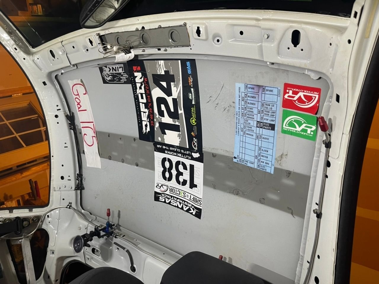

as many of you know, I’m nuts about weight and it’s harder and harder to reduce / eliminate weight and one arena I have not dove-into has been wire harnesses. As I look at the interior of the car I have a small amount of wiring that is no longer needed and not applicable to the car.
I set a goal of 20lbs of weight elimination from taking out wiring that is no longer needed … it’ll mostly interior and dash wiring but also engine bay has a bunch that I dont need.
I’ve started and this is a really good lesson on how the car is wired.

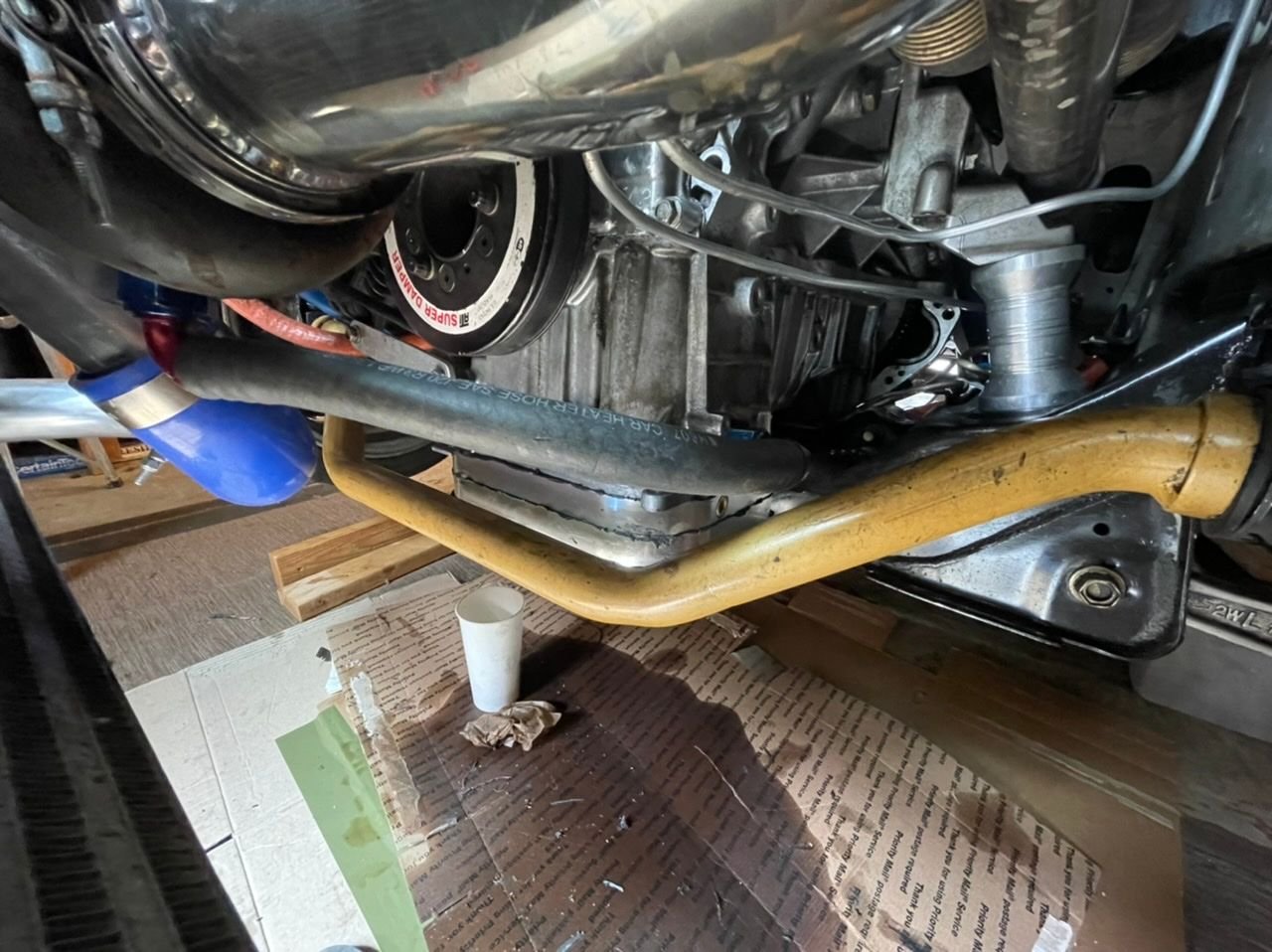

Got the oil pan off, about a 1” hole and got the bulkhead fitting installed and RTV’d in to place.

Finished up the oil pan - cleaned out the sump and reinstalled the two spacers, oil pickup tube, and the lower oil pan lid.
I’m not wildly optimistic with how the hose is run but it’ll be a good intermediate step. If this doesnt work Im looking to construct a 2”x2” square, about 9” long sump box that’ll attached to the turbo and gravity drain back to the sump.

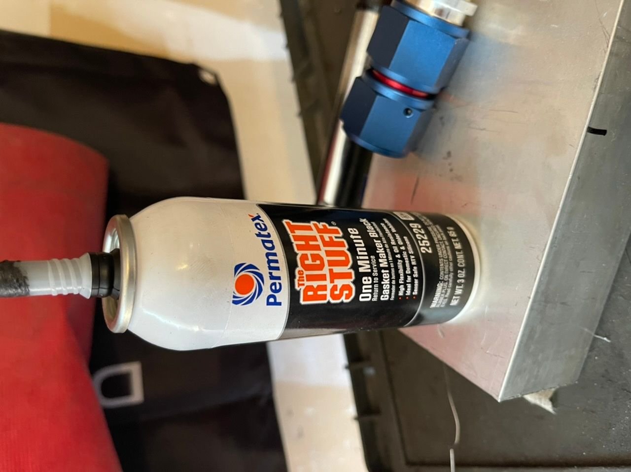

I usually use Permatex Ultra Black but the parts store didnt have the size (in the cheese whiz can) so I bought this:
not sure how it’ll work long term but it was wayyyyyy quicker to install stuff.

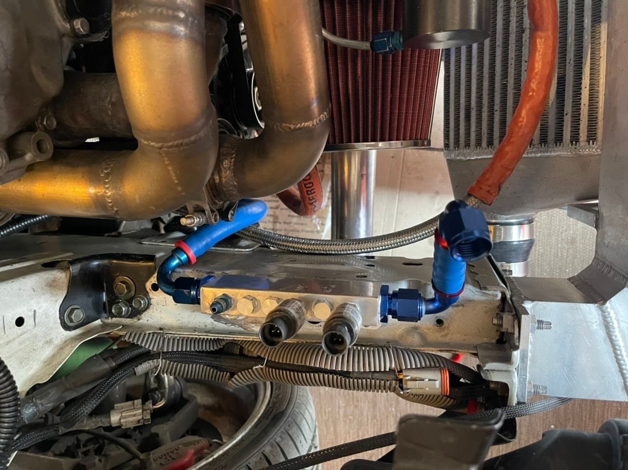

Also got working on the oil feed manifold…I took all my 5/8” hose over to a buddy’s garage to work on his setup so I will have to re-use the hose I had before and I need a better solution to mount the oil filter but I’m making progress. I’ll wrap these lines in fire sleeve before it’s all said and done.
Also going to swith out the OEM oil pressure sensor with a AEM variant which will require re-pining the connector.

I am a huge fan of "The right stuff" I have used it many times on the race motors and have never had a leak. Its especially convenient with how much easier it is than the old school ultra black.
There have been a few times doing motor internals and block seal surfaces and for those I will use Hondabond HT. That stuff is really good and it is thinner than permatex stuff, so it is easier to do a really clean job with in my opinion.
