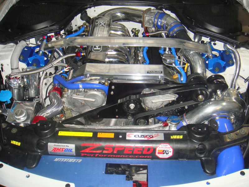

K and N says their filters are lifetime filters..just clean it...also, the stock vortech air filter sucks hot air from the engine compartment so I got a silicone connector, a piece of AL pipe and extended the filter to under the bumper about 3 inches so its sucking cool, ambient air, not heated engine compartment air. (no photo of this setup attached)
The attached photo is using a long 12" or so silicone hose with a 90 degree bend to route the filter to under the hood latch, using a larger fliter. I felt the long length decreased performance, but that was a butt dyno. I kept the shortest 3" setup there on out.
hope that helps someone. Oh yeah, the vortech filter change is a knuckle skinner fer shur!
