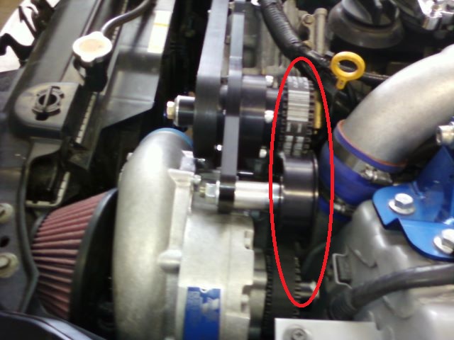

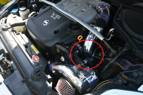

Hi guys, i am using a Vortech V3 Supercharger kit in my 2003 DE.
one of my belt was slapped and i can't find the replacement for it, i don't even know the part number, can anyone help me out please, online store will do.
I am living in Hong Kong which don't have any vortech dealer here, not much of help i can get

its the belt i am talking about in the red circle. thanks
tried to get a part number from the internet is K060795, but still not sure since it seems got many size

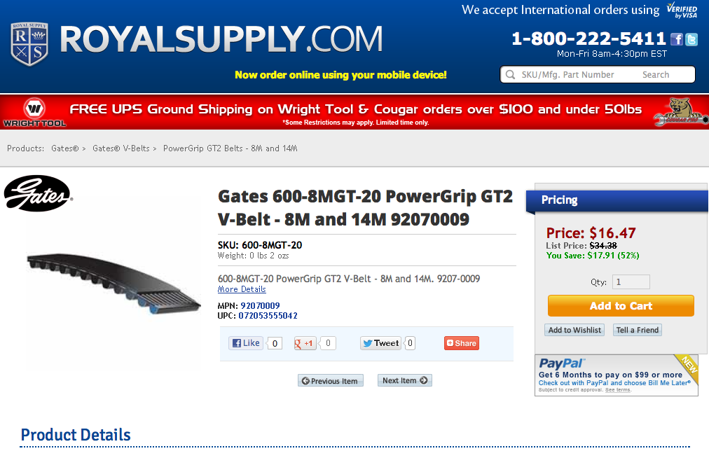

The Cog Belt is a Gates 6008MGT20 Powergrip GT2 Very common Belt no more that $17.00, don't go thru Vortech for that.
If you are eating cog belts, it is most likely to tight. You need about 1/2- 5/8 inch of play when cold. If it's tight when full Hot, it's to Tight.
Should last 40,000 miles at least.
