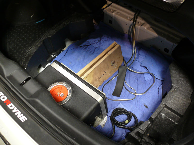

trunk mounted is below the cardboard trunk panel so I have never heard any liquid moving around....
Attached Thumbnails Methanol Tank Location-trunk-water-methanol-tank-and-battery-area.jpg
