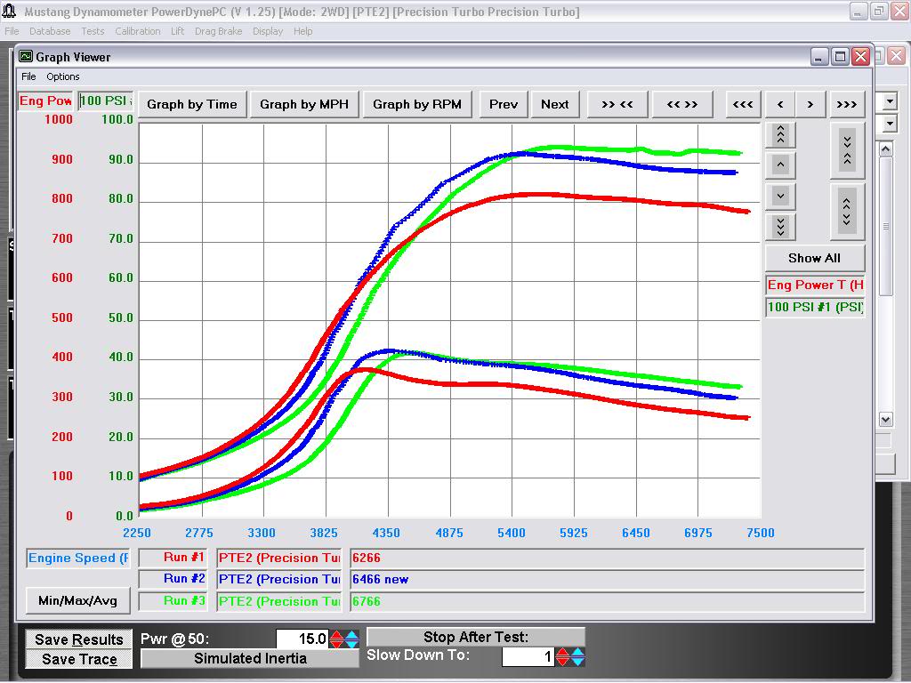

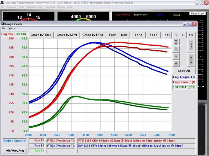

Here are some graphs from a supra with 3.4 liter so close to the displacement of our engines.
In Red it's the 6266. Almost 800hp and it hits almost 40lbs of boost by 4k. It's at 20lbs of boost around 3500. I included another graph showing the 6266 getting near 40psi at 4000 rpm as well.
Not sure what graphs you see that have slow boost on these turbos on supras. Most supra guys use a 62 or 67mm for "street" spool.
