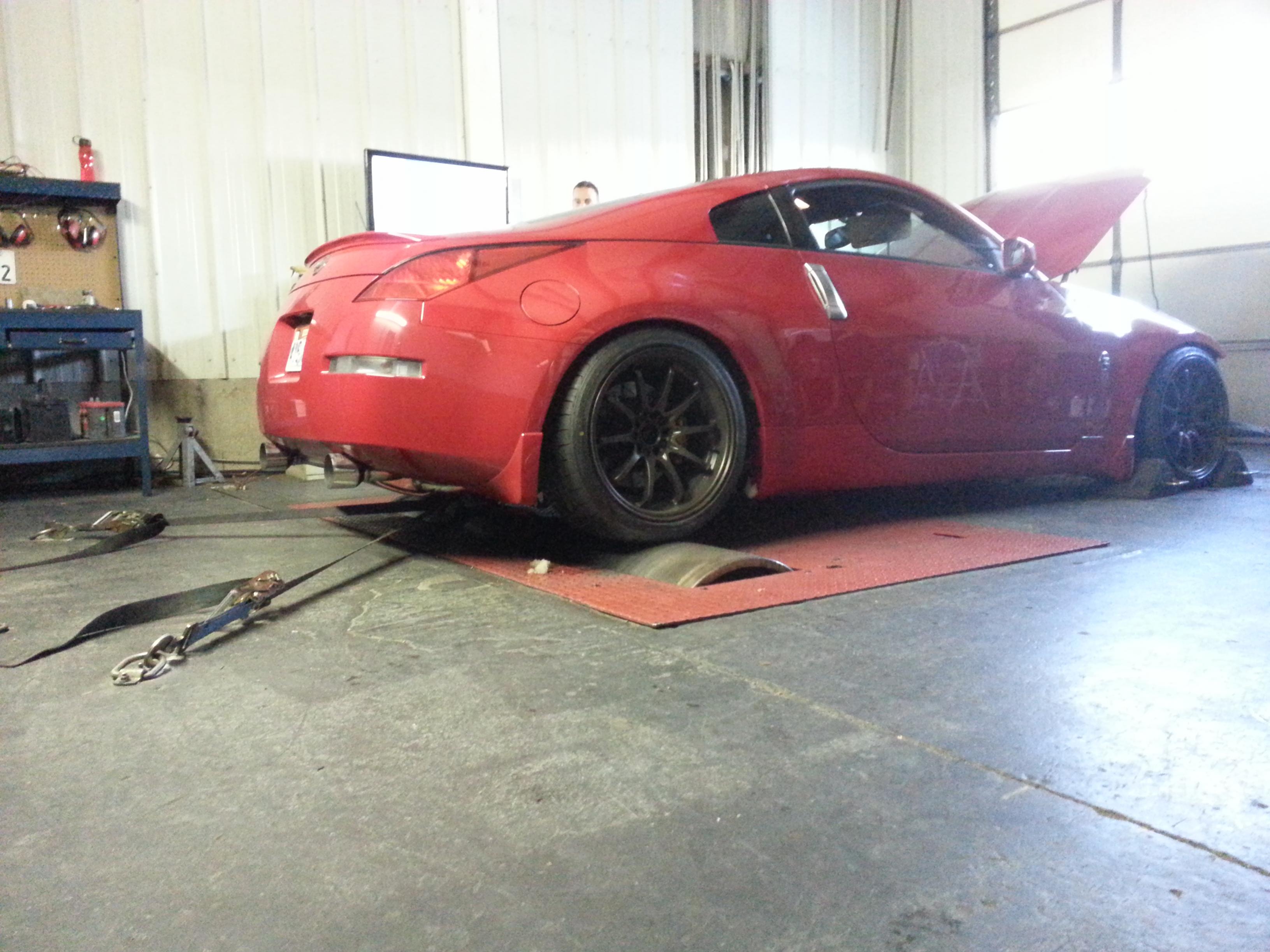

I'm not sure what dyno it was on (I didn't ask and it was my first time around one) I'll throw up a picure if that would help. It was dyno meter, dyno pack something. The A/F at WOT is below 12. We saw between 8-9lbs boost. No fuel filter to save me?? It was a thought shot in the dark I guess. Woke up with an uneasy feeling in my stomach and a bad headache and I didn't even drink last night haha.

I'll ask my tuner today what dyno it is. Here's a pic of it last night.

prolly dynodynamics as they use red platforms.

Dynodynamics sounds right. Would a RFS suffice with 440's?

325 on a DD is prolly close to 375whp on a dynojet
