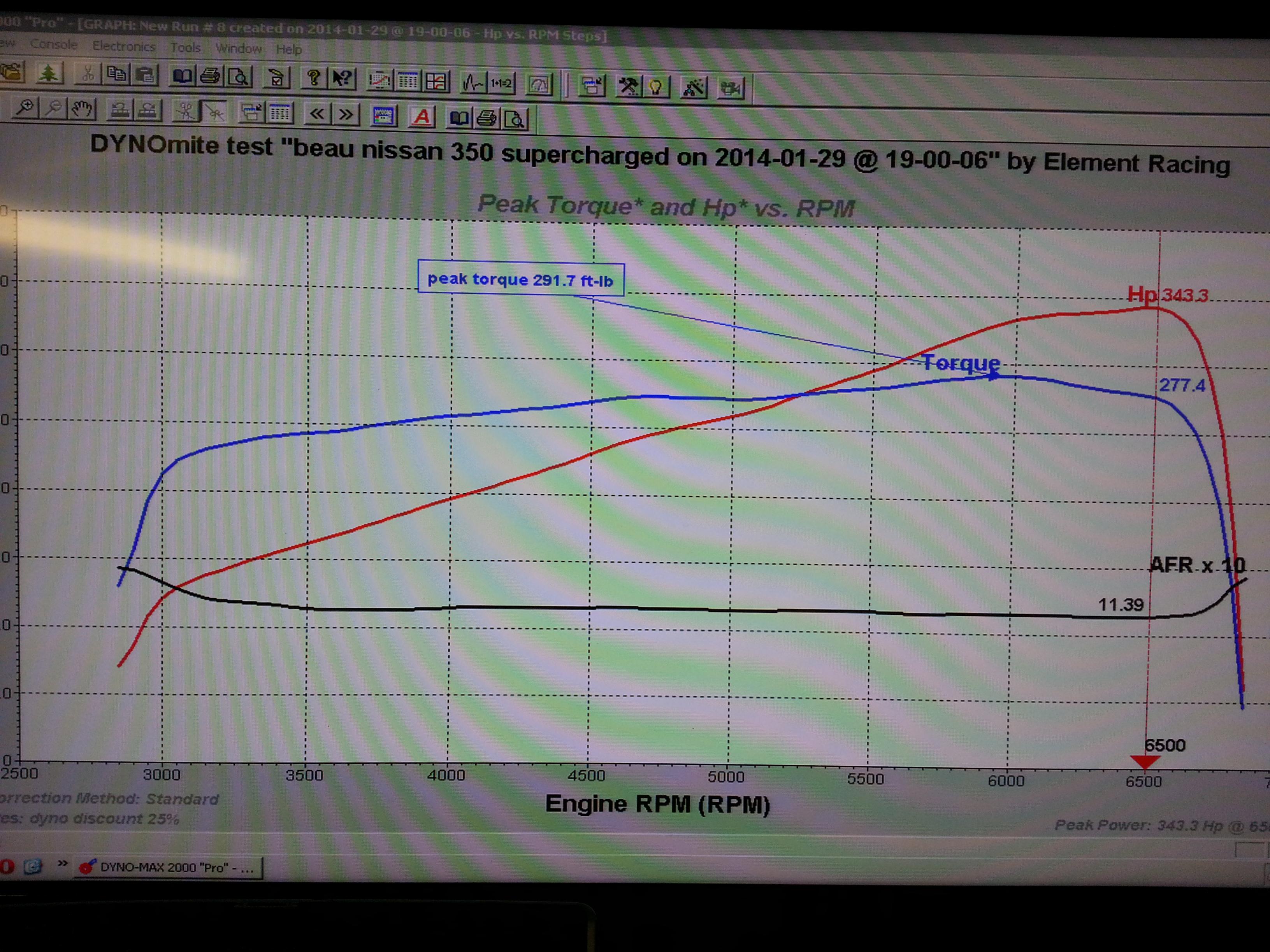

Welp, I installed some DW600cc's and have the DW440cc's I removed for sale in the marketplace. Got it dyno tuned a couple of days ago at Element Racing here in Utah again with the same tuner as before. I didn't come close to my goal of 400whp, but to say I have a legit car with 400bhp+ isn't bad either . The weather sucks outside, so I have not taken her out for a joy ride just yet. Thoughts are appreciated.

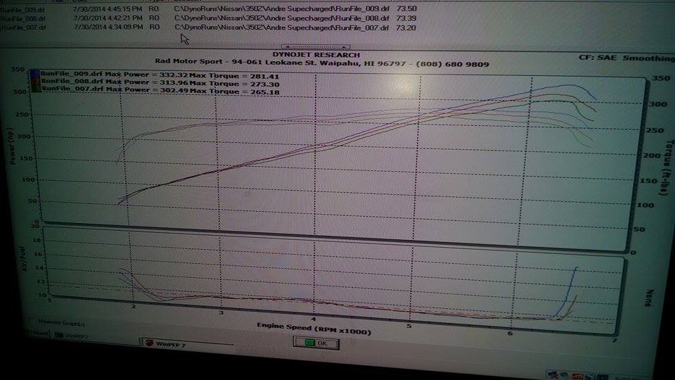

Sorry to wake the dead on this post, but i was also having the same issue with my build, ended up getting 332whp off of my 3.12 pulley. had 500cc injectors and walbro fuel pump and yielded the same results as you, OP. I picked up some 720cc Injectors today hoping to retune soon, also bought the GTM Pulley Set to help eliminate some belt slip cause i wan also only making 5.5 psi on the dyno. =/
