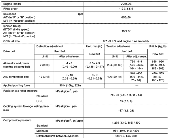

For the install of the e-manage ignition harness on the 350Z.....what is the cylinder ignition firing order? and does the 350Z have a V6 group ignition or V6 individual ignition? ( I am assuming individual but I thought I would clarify).

I might be wrong (don't have the service manual in front of me at the moment), but I thought it was 1-2-3-4-5-6. Somebody with the FSM should probably check that.

From the FSM

Thanks ETX !!!
