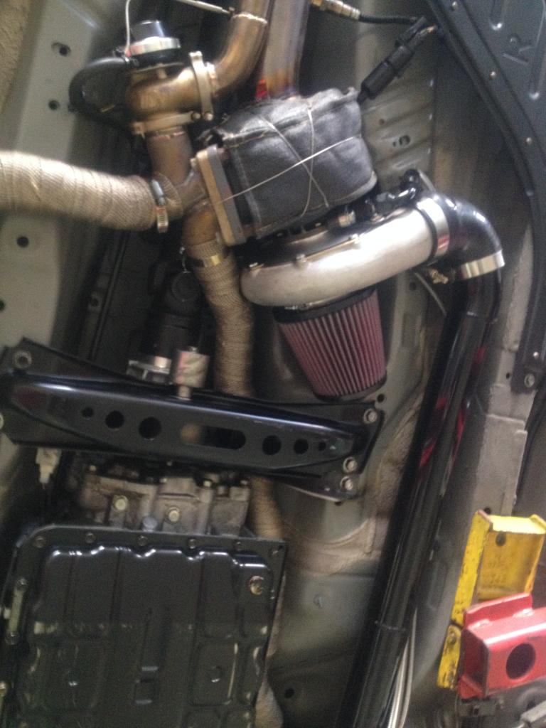

Changed out wastegate springs to lower the boost for the street (17 psi down to 8-9 psi). The odd thing is the car feels just as powerful as before. The only thing that makes sense is that at 17 psi the Transmission or TQ converter was slipping. So 600+/- hp may be all my 5at can get to the wheels. We didn't put the car on the dyno to confirm it, but I'll update this thread next time the car is dyno'd.

That turbo looks perfect right there.
