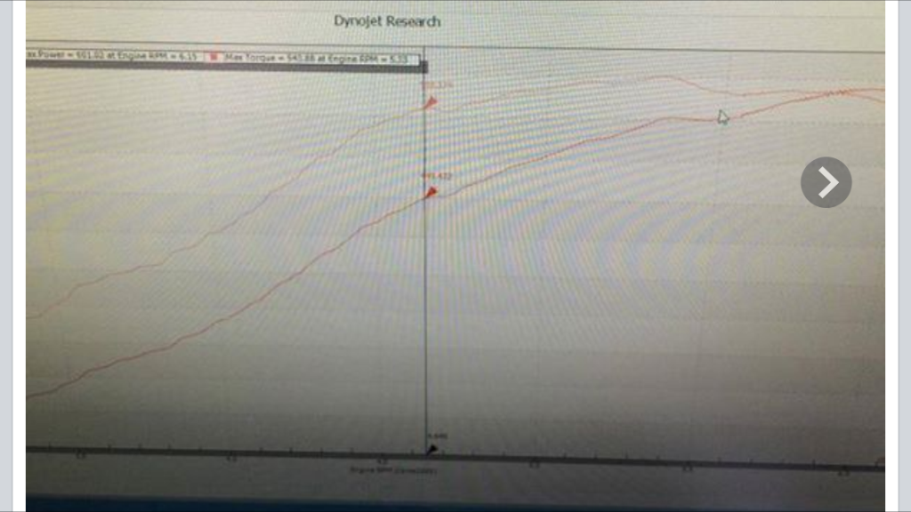

Best run of the day. 601hp/543tq.

Default 5 at
wow, thats EXCELLENT! What sort of tuning does he do to the 5 at? Your the first over 600 except mrg1980 675 rwhp?) I hve seen with the at...gives me hope! my car may end up at jtran one day.....

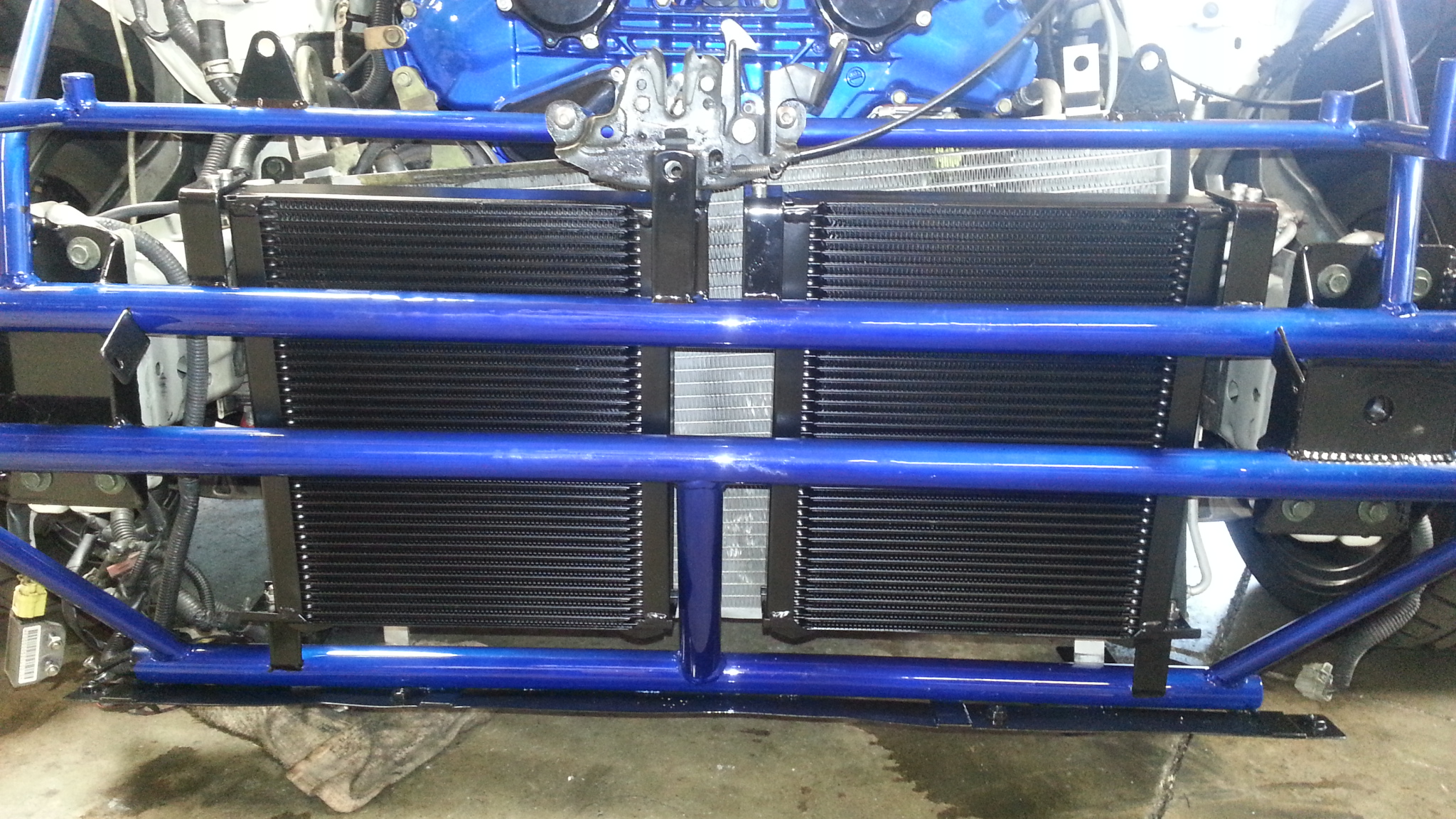

Default coolers
what size coolers are you running? Did you have the coolers mounted elsewhere before moving? Where might I ask? Tryin' to learn from you what I might expect with mine...
Attached Thumbnails Jaxter - the single life-powdercoated-core-support-installed-oil-coolers-only.jpg

what size coolers are you running? Did you have the mounted elsewhere before moving? Where might I ask? Tryin' to learn from you what I might expect with mine...
I don't remember the size. I bought the standard kit oil and Trans coolers from Stillen. They were originally right where yours are, but since adding the big air to air intercooler, we wanted to move them out. Now we have to figure a good way to get them airflow. Ron suggested we remove the reflectors and cut two more slits in front to give the appearance of shark gills. We will work on the final details that tie it all together next week.
You can see the coolers in this picture.

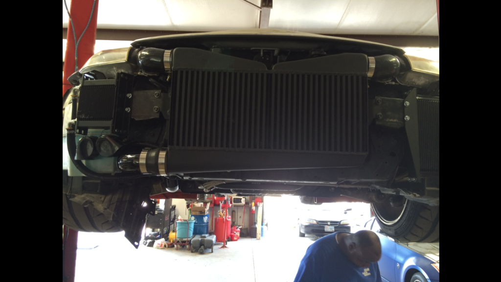

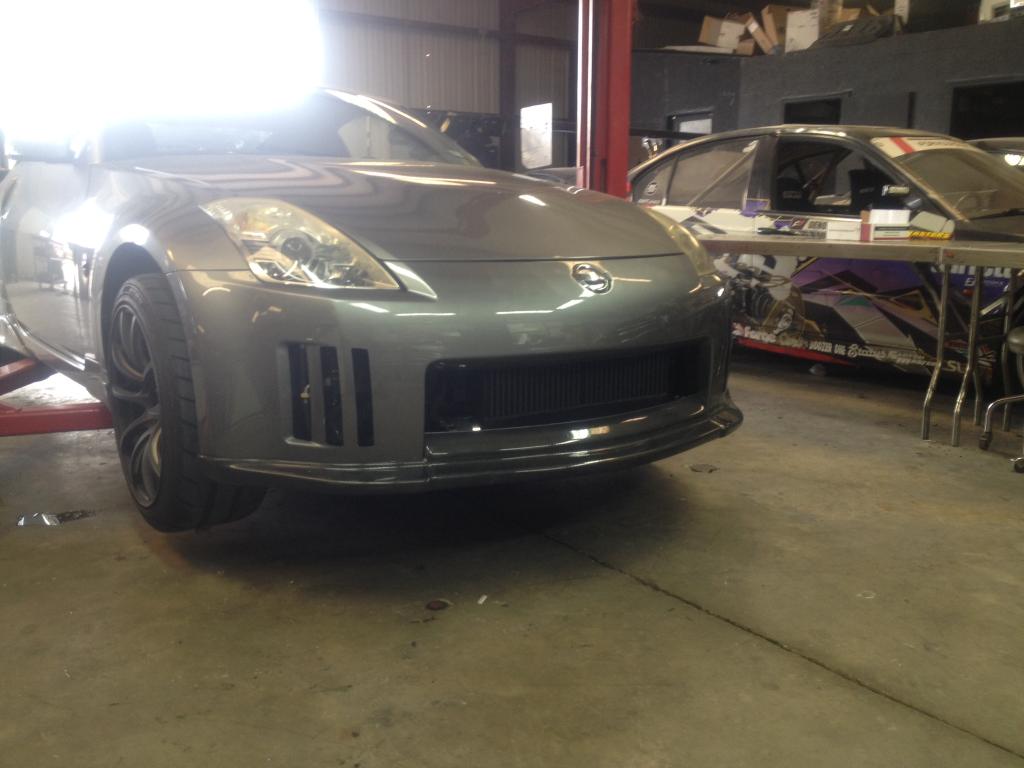

Eye candy.

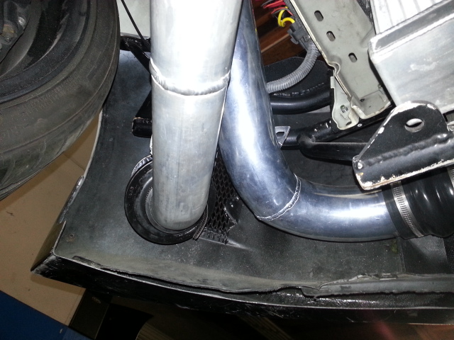

Ron cut some holes to get better ventilation to the oil/trans coolers.
