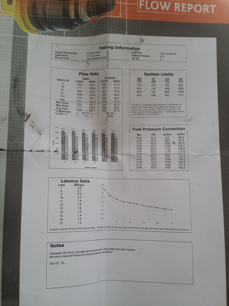

So, I’m running a ProEFI 48 computer on my G35 coupe, I’ve just finished upgrading my fuel system (DeatschWerks 1000cc injectors, Walbro 485 pump, CJM return fuel system, etc.) and all that’s left is dialing in the new injectors on the ProEFI.

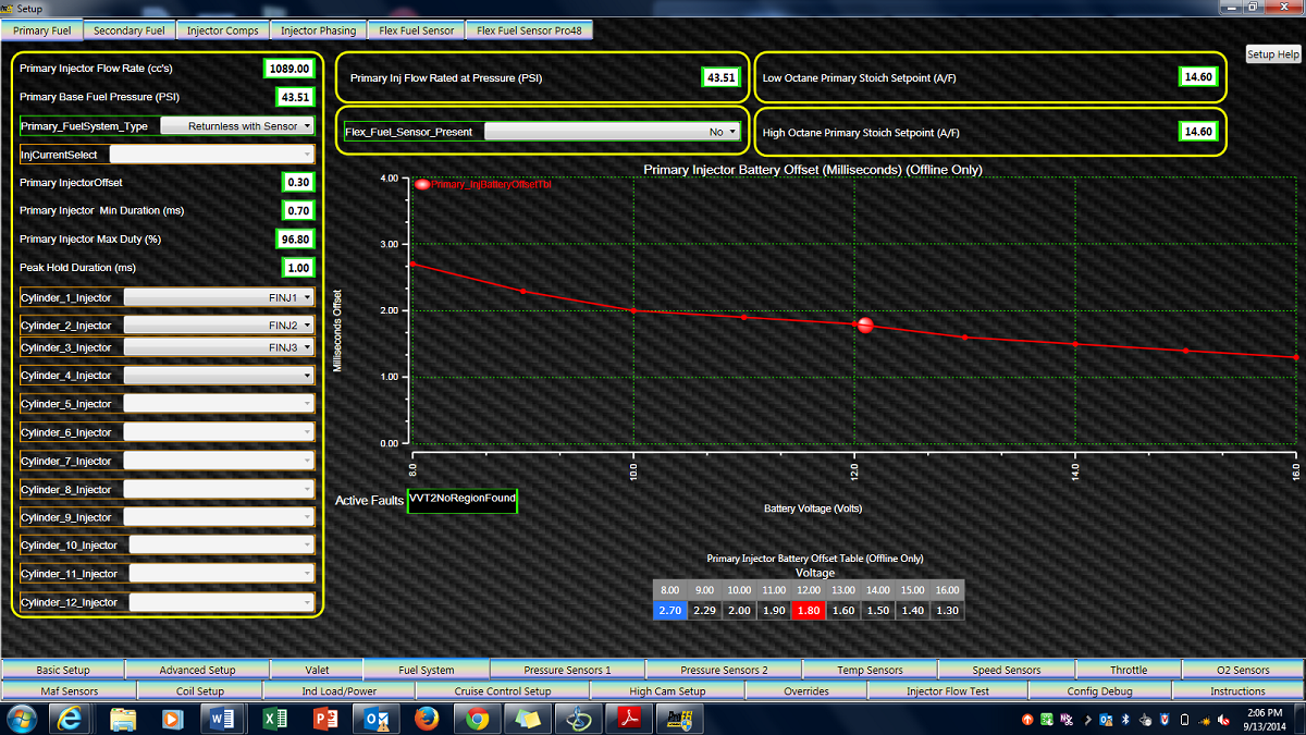

I figured that all the adjustments I need to make are on the ‘Setup’, ‘Fuel System’ menu. Although, I’m having some trouble finding the correct values to use. DeatschWerks provided me with a DeatschWerks Flow Report (below).
From the DW Flow Report I’ve got:
‘Primary Injector Flow Rate (cc’s)’: 1089.00
‘Primary Base Fuel Pressure (PSI)’: 43.5
‘Primary Injector Offset’: Don’t know
‘Primary Injector Min Duration (ms)’: Don’t know
‘Primary Injector Max Duty (%)’: Don’t know
‘Peak Hold Duration (ms)’: Don’t know
Primary Injector Battery Offset Table
Voltage
8.00 = 2.70
9.00 = 2.29
10.00 = 2.00
11.00 = 1.90
12.00 = 1.80
13.00 = 1.60
14.00 = 1.50
15.00 = 1.40
16.00 = 1.30
Thoughts? Am I on the right track? DeatschWerks’s website lists number much different than what they listed on the Flow Report: http://www.deatschwerks.com/products...-1000-6-detail
Attached Thumbnails Setting up new injectors-dw_1000cc_flow_report.jpg   Setting up new injectors-injector_setup_w_provided_flow_sheet.png

Think I found the answer to ‘Primary Injector Min Duration (ms)’ and
