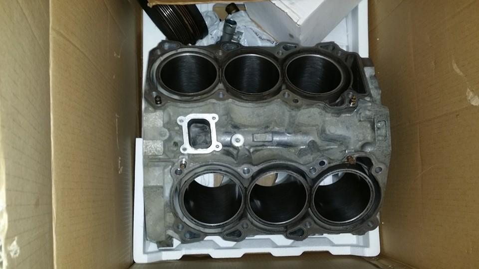

I'm planning on going the FI route with my 03 Z and was curious what rods and pistons you guys used successfully.
My ultimate goal is to make 650~hp and it still be reliable.
I'm planning on keeping stock bore unless its recommended to be sleeved..
I'd like to get away without doing that as my spare block is already honed at stock bore 95.5.
I know the main limiting factor to my goal is octane rating.. so would you recommend a methanol setup?
I only have 93 in my area and I'm planning on using a haltech for tuning. As far as the turbo kit I was going to try to get my hands on a boosted performance twinscroll setup with the 6766.
As far as the heads go, can I get away with stock heads and cams or would you recommend throwing in valves and springs while i got everything apart?
I'm not sure how expensive it will be to port and polish my heads as I haven't priced that but I've heard lots get away without doing that.
I really like the sound of the 272 tomei cams. Will that even benefit my build?
I already have an HR oil pump and was shooting for a 7500 redline unless i can get away with something even higher.
How about a billet girdle, is it really necessary for only 650? Anyways I've been doing tons of research and would just like your two cents if your experienced.
