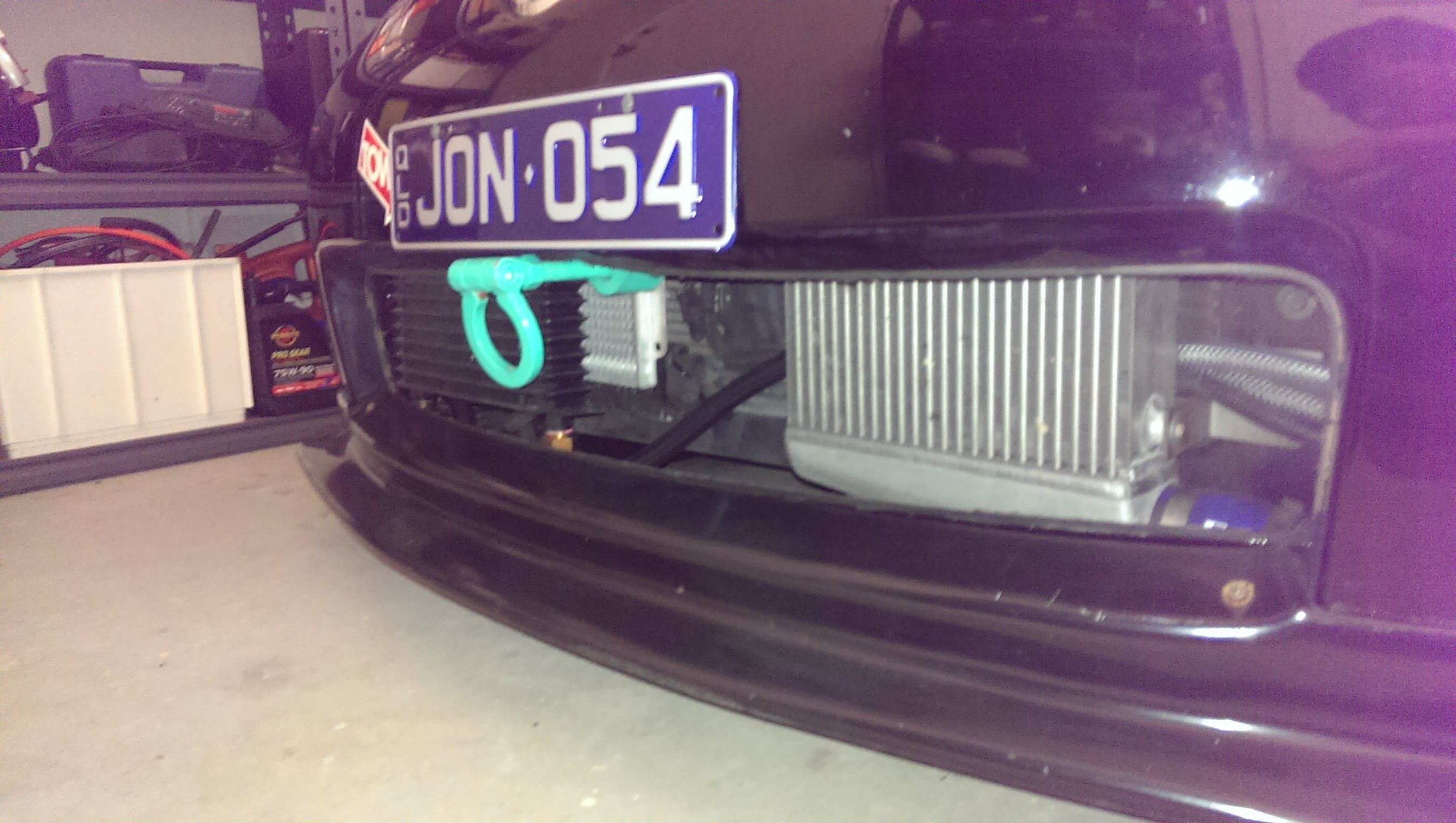

Well you have a small FMIC, I would say change out your intercooler and try to get as much info as you can on that motor. Until it can be proven beyond a doubt assume its a stock motor! Stock MAF should be good up to 400WHP on a turbo set up or 10psi'ish on a supercharger.

That's a tiny intercooler and turbo. Swap those and retune.

the FMIC is properly sized for that turbo, that all part of the $$$$$$$$$$ HKS turbo kit. That HKS 3037 is very small with a t25 flange, 52mm so 300whp at 12 psi isnt surprising, but a little low. copuld be the compression, coulld be soft timing, could be alot of things
