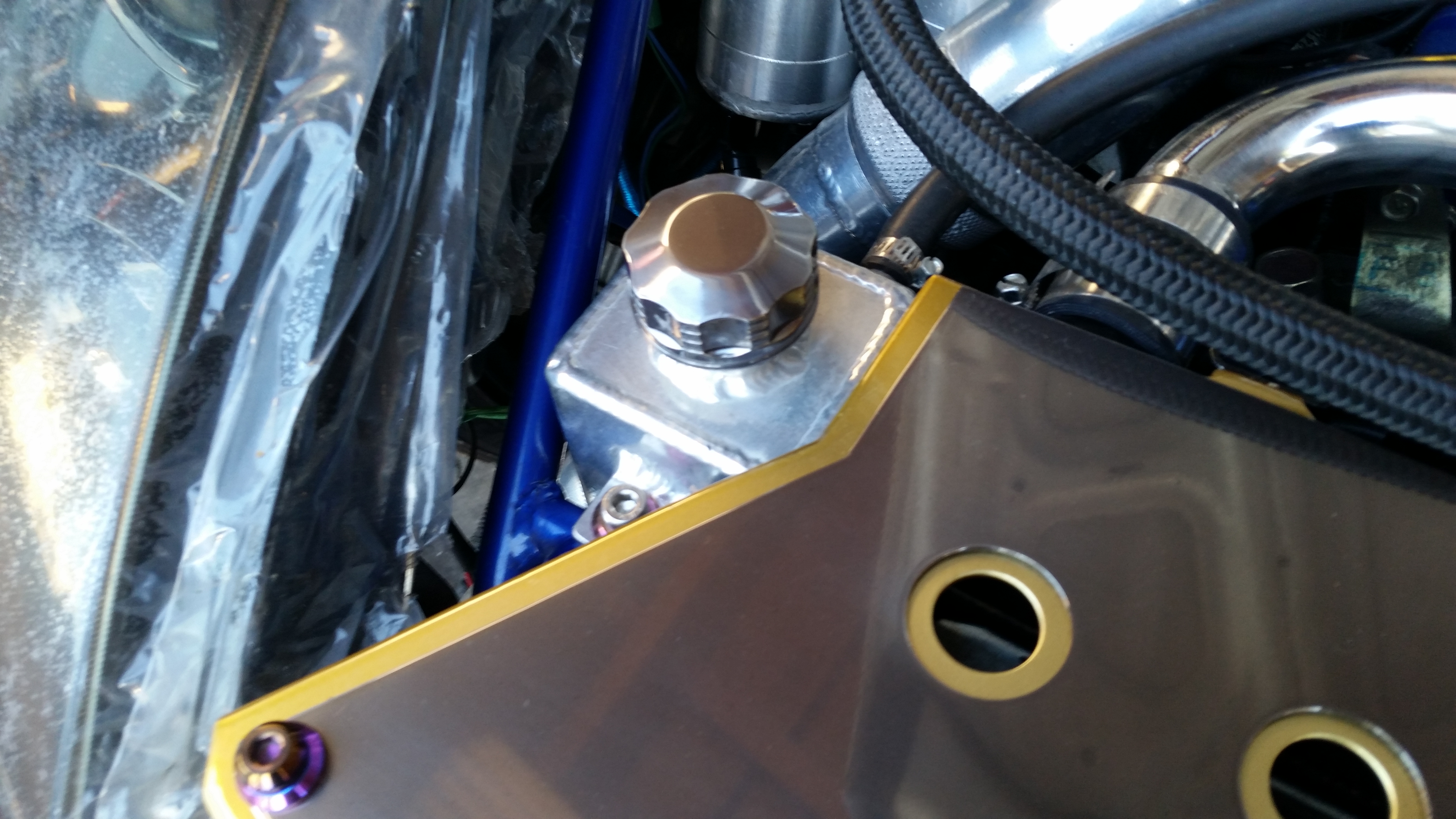

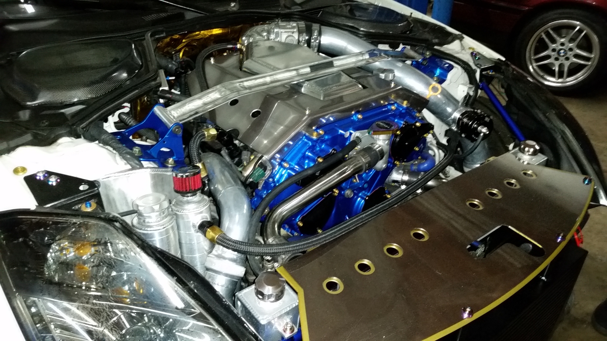

Default mani's
Tim at Speed Force Racing is a master fabricator, albeit a little slow...he states that he can fab up what you need.....his fabrication skills are flawless...almost everything under my hood and trunk has been fabbed by him...getting him to do it is the problem, but call and ask.
Attached Thumbnails Greddy Manifolds-engine-bay-passenger-side-unpainted.jpg   Greddy Manifolds-water-methanol-battery-trunk-box-3.jpg   Greddy Manifolds-gold-cans-mounted.jpg   Greddy Manifolds-roll-bar-painted-front-view.jpg   Greddy Manifolds-small-cans-close-up-inpainted.jpg
