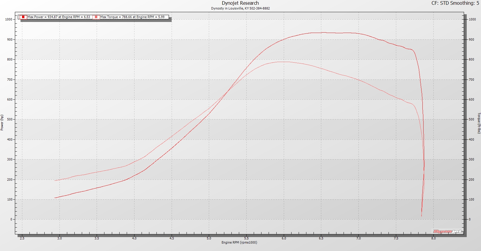

As some of you may know, I have had a customer that decided to do a bit of a custom mid mount kit, using a Precision 7675 T4 .96 a/r billet JB turbo. The run was made on the new DJ dyno.
Well, the numbers are in:

Awesome numbers and great curve.
Any additional information available? Cams/headwork/compression ratio?

How much psi? what fuel? what was done to the motor?
Nice numbers!

Low CR (8.5 I believe), not sure about the rest of the engine.
E85 and I believe around 25psi. The motor was obviously built...you would have to contact Dynosty for a build like this, as I only provide the turbo kit.

Lots of power for 25psi. the 7667 has a lot more to go. Seems a little bit on the laggy side tho. Maybe a 6766 could make to close to the same power ( more boost obviously) and spool sooner?

^ wow.. yeah that it WAY up there in the powerband for sure.. impresive though no doubt.. but id most likely resize the snail too if it were I. Id imagine this is a dyno queen build tho.. i couldnt imagine trying to actually drive a 900 hp Z.

per Dustin, it was 30psi and out of fuel pump (255 and a 485).
powerband as expected for a 76mm and a 75mm turbine. not terribly lazy, but the 6870 would def be a better option in the future for someone that doesnt want to get very custom with the fuel pump setup. 6766 is still probably the best street turbo, maxing out around 950whp.

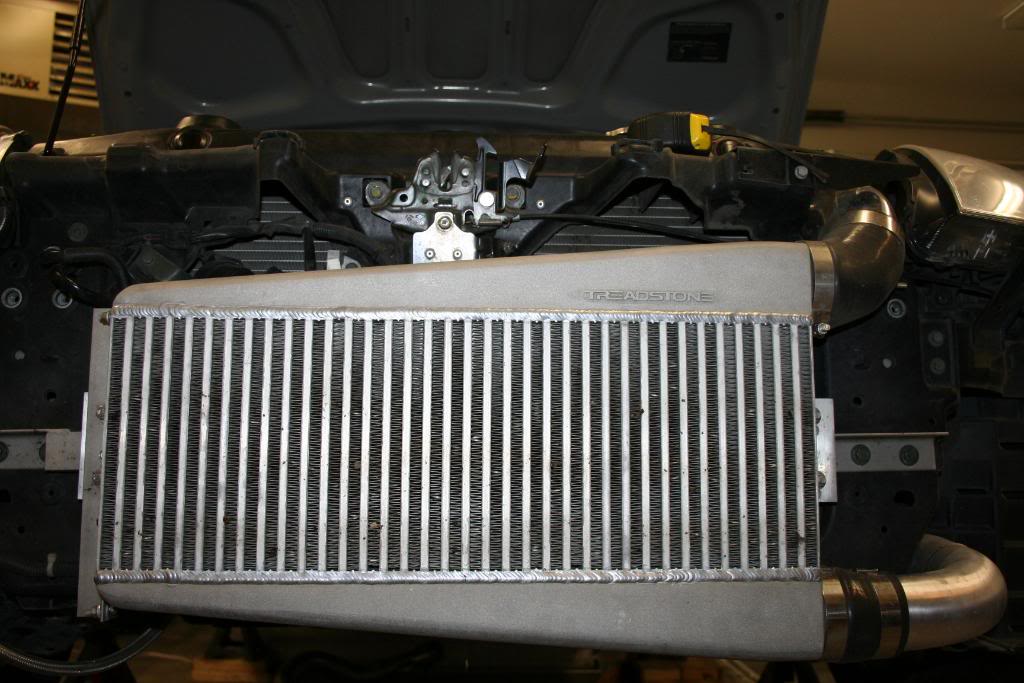

3.5” intake:
Because I ended up using a different/larger FMIC:
The IC plumbing was changed a bit…instead of entering the vertical FMIC on the drivers side, it goes all the way across the engine bay to the passenger side:
Standard FMIC:
Since the standard FMIC is capable of flowing around 2,000cfm I believe that it would have been plenty for this application, however, I did end up going with the larger core anyway.
The guys at Dynosty had no issues with the kit on pump gas, but when it came to high PSI and E85 the intake became a restriction. They ended up using a larger K&N air filter, and I believe a larger 4" intake.

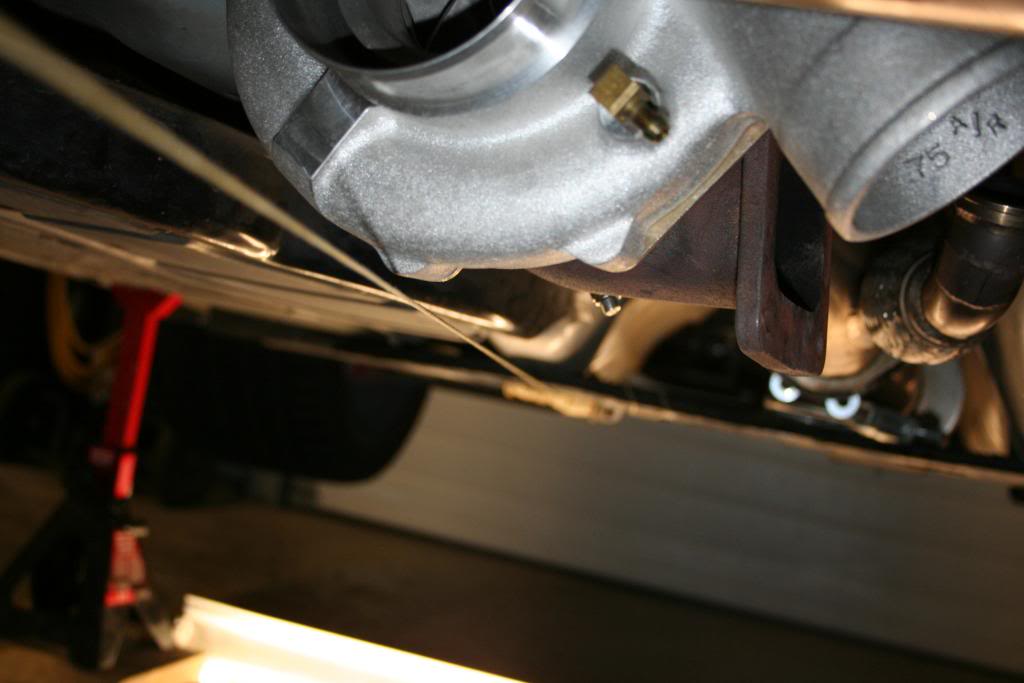

Here is the clearance when a string is pulled between the front sub-frame and the rear skid plate:
With a bit more "massaging" it would be very easy to create another 1/2" to 1" clearance.
