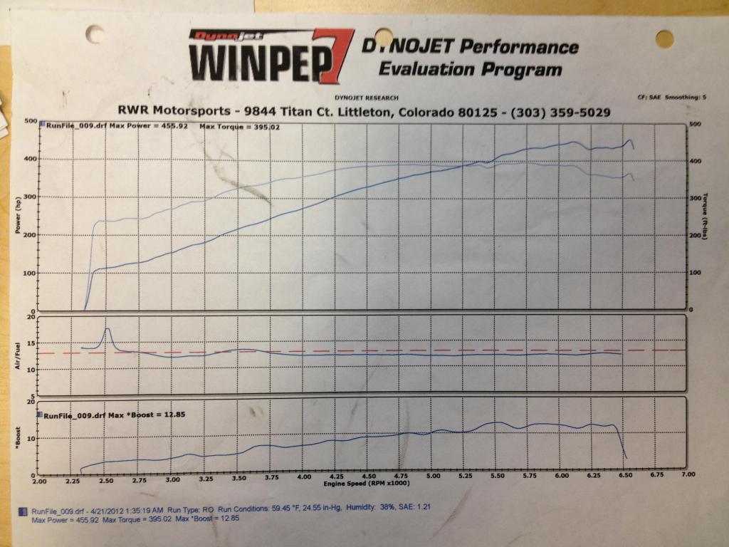

I did 455whp at 13psi, spinning the impeller around 80k rpms by regearing the cogs and upgrading to a larger harmonic crank pulley. 600cc/255lph, stillen headers/test pipes/exhaust, motodyne plenum,
Quite possibly the worst part of the kit is that doesnt scale well ...
hows your build? are you thinking of changing direction?

What cogs did you use? And how did you route the belt?
I cant remember but they were the standard pro charger cogs. The bulk of the change came from the harmonic dampener.
people also need to keep in mind this is at elevation. im sure at sea level it would be 500hp capable.
