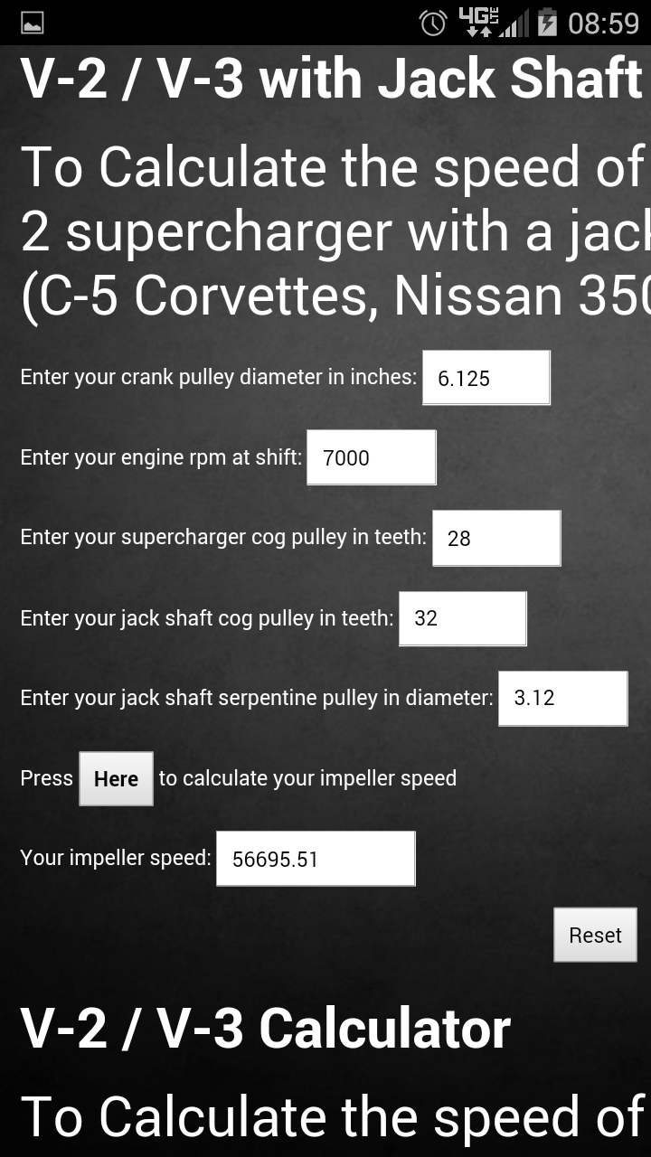

I ended up going with a Fluidampr to spin the blower faster, I mentioned this in my progression thread. Oldman, thank you again for your help. I will retune to rev to 7k rpm after its installed.
where can i get that calculator ?
Old Jan 24, 2015 | 08:35 AM
NAbuilderZ33's Avatar
NAbuilderZ33
Joined: Jul 2012
Posts: 198
From: Killeen, TX
The calculator is on the Vortech webpage.
Here's the link.
http://www.vortechsuperchargers.com/page.php?id=33511
