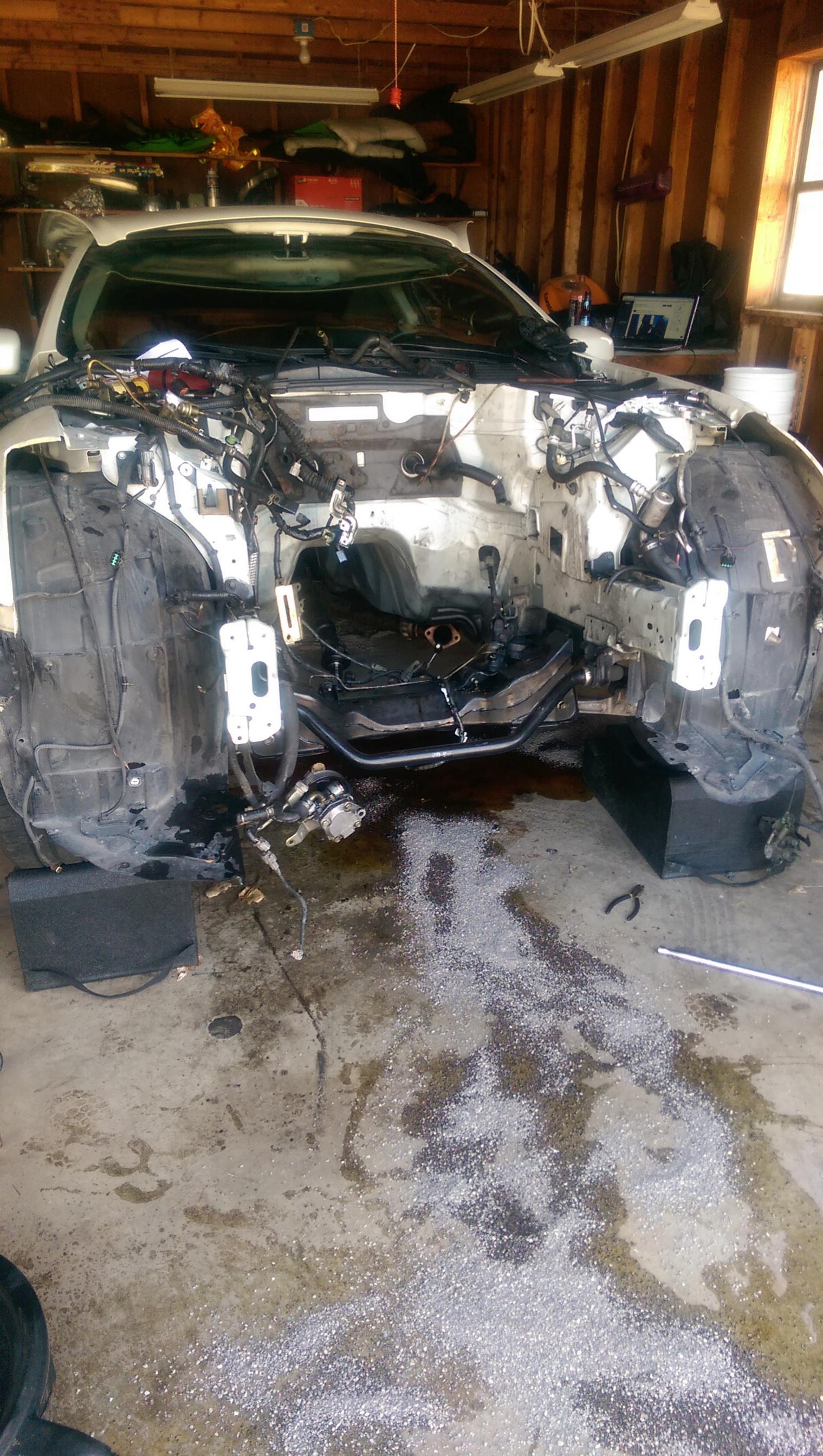

So it's almost out just got to undo engine mounts, tranny mounts, disconnect clutch and drive shaft.. just ran out of steam that day. Question though. I know they're hydraulic clutch system when you go to disconnect it from the clutch fork do I have to drain the fluid out to get it all apart or would I be able to unbolt it without draining. So far the plan is to get the car running make sure it works and swap it over to my 350z so don't want to waste fluid to just do it again later
Old Feb 11, 2015 | 04:16 PM
Conway_160's Avatar
Conway_160
Joined: Dec 2012
Posts: 2,588
Likes: 354
From: Pan Handle
I know on my 04 G35 all i have to do is Unbolt my slave cylinder on the side of my transmission and pull it off.

Yeah if you undo the two bolts on the slave you can just tuck it out of the way.

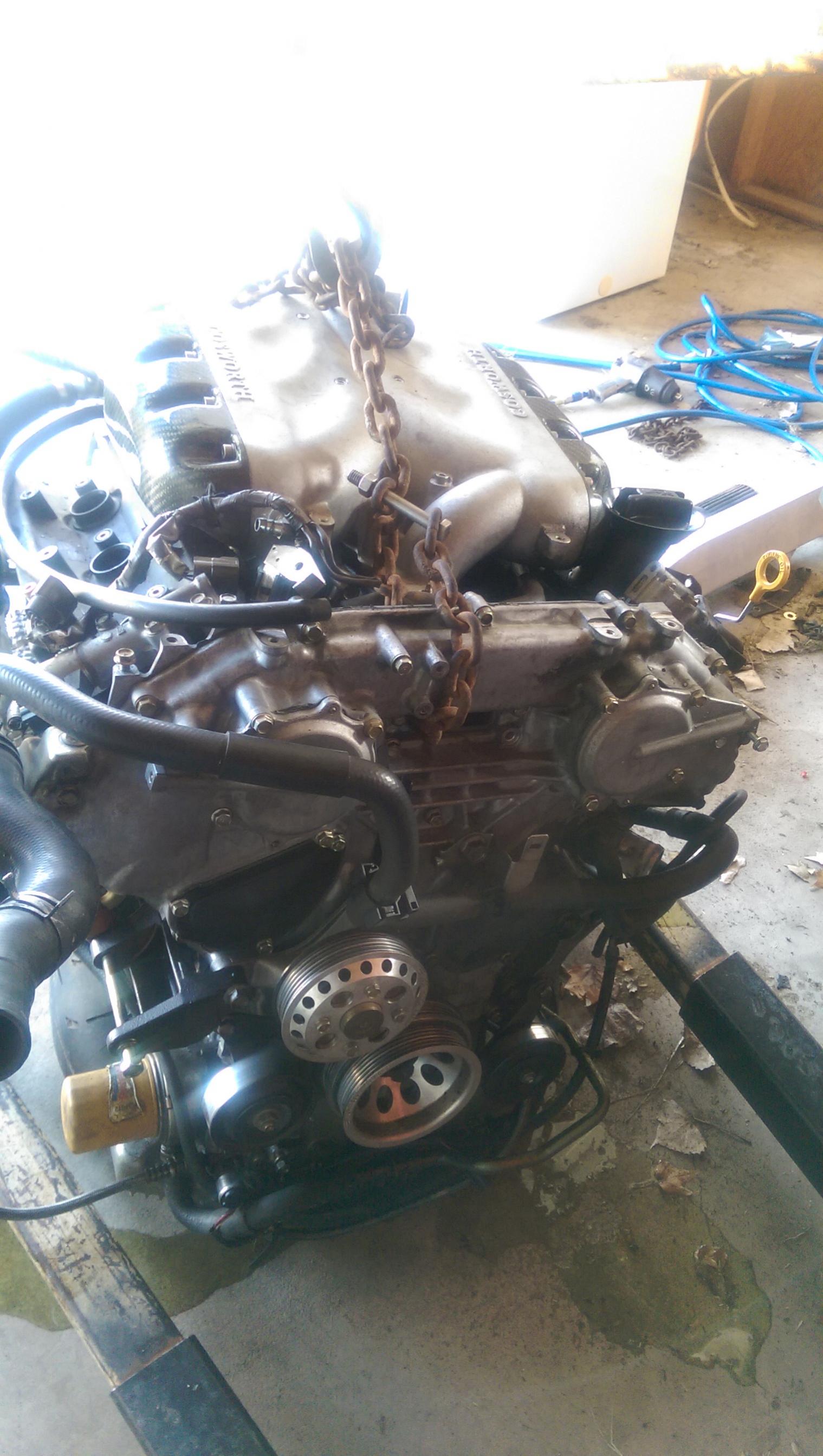

Alright got it out finally with the help of my father to guide it I can see why shops charge so much but still to expensive lol. Any ways cleaning up the garage and spending some time with family today. So maybe tomorrow I'll get part of it dismantled 😊

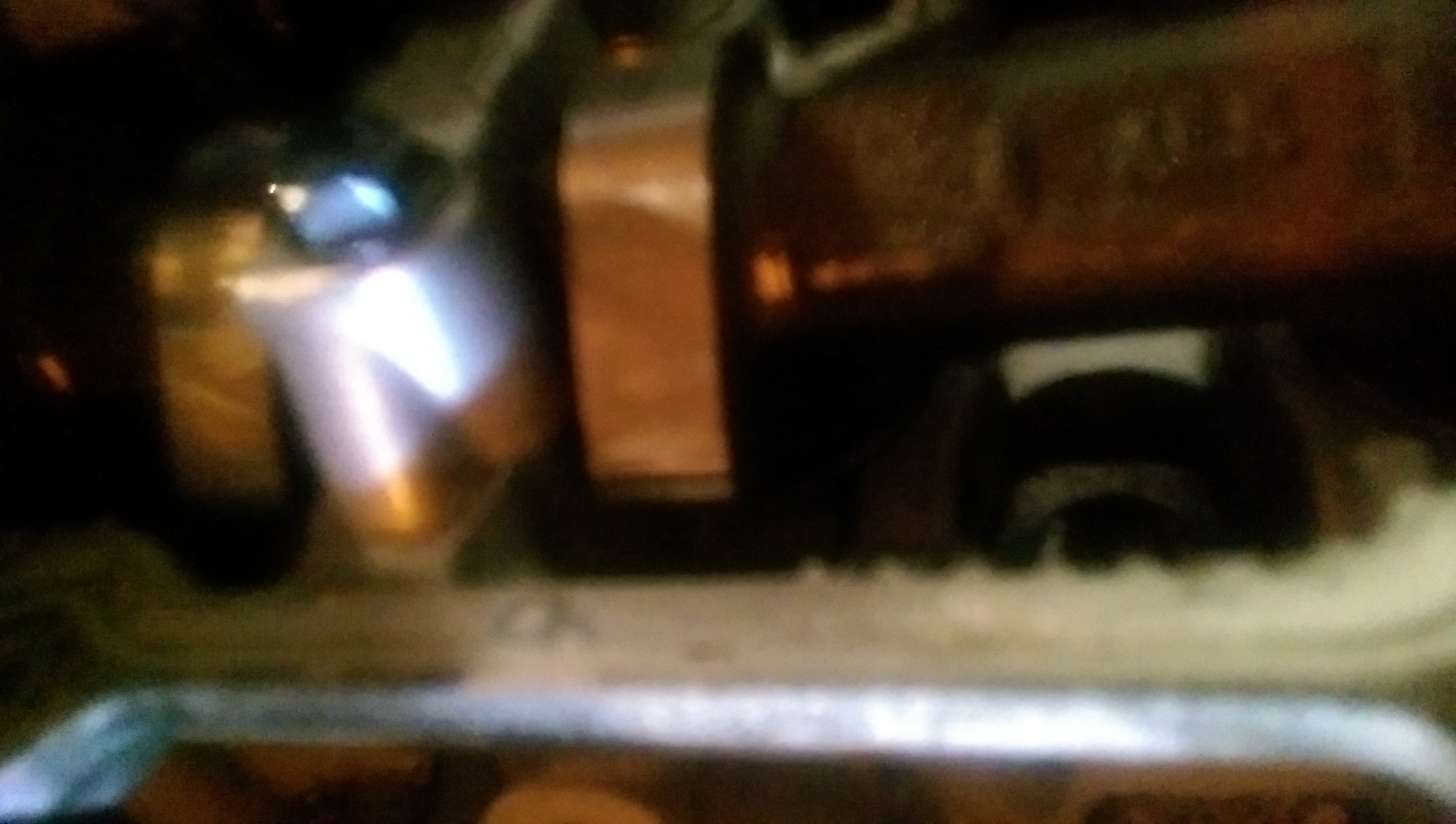

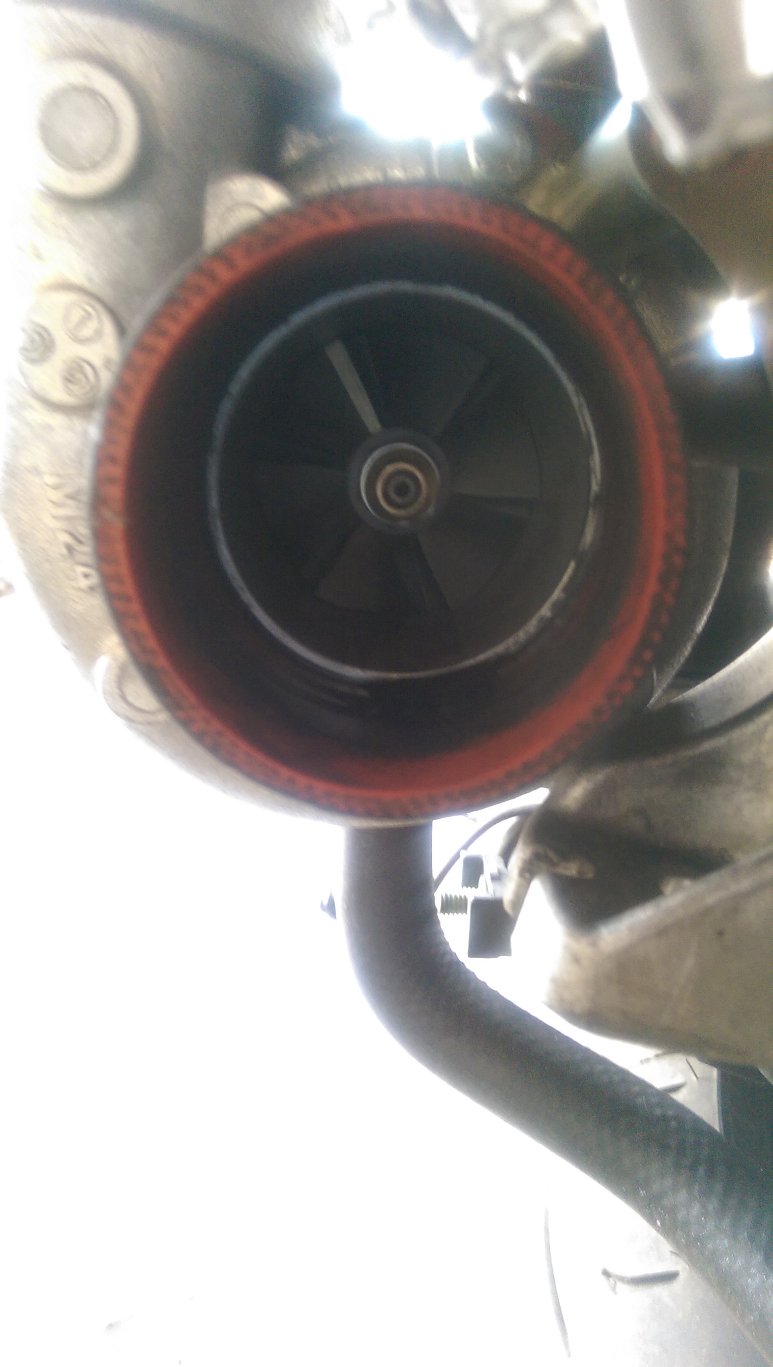

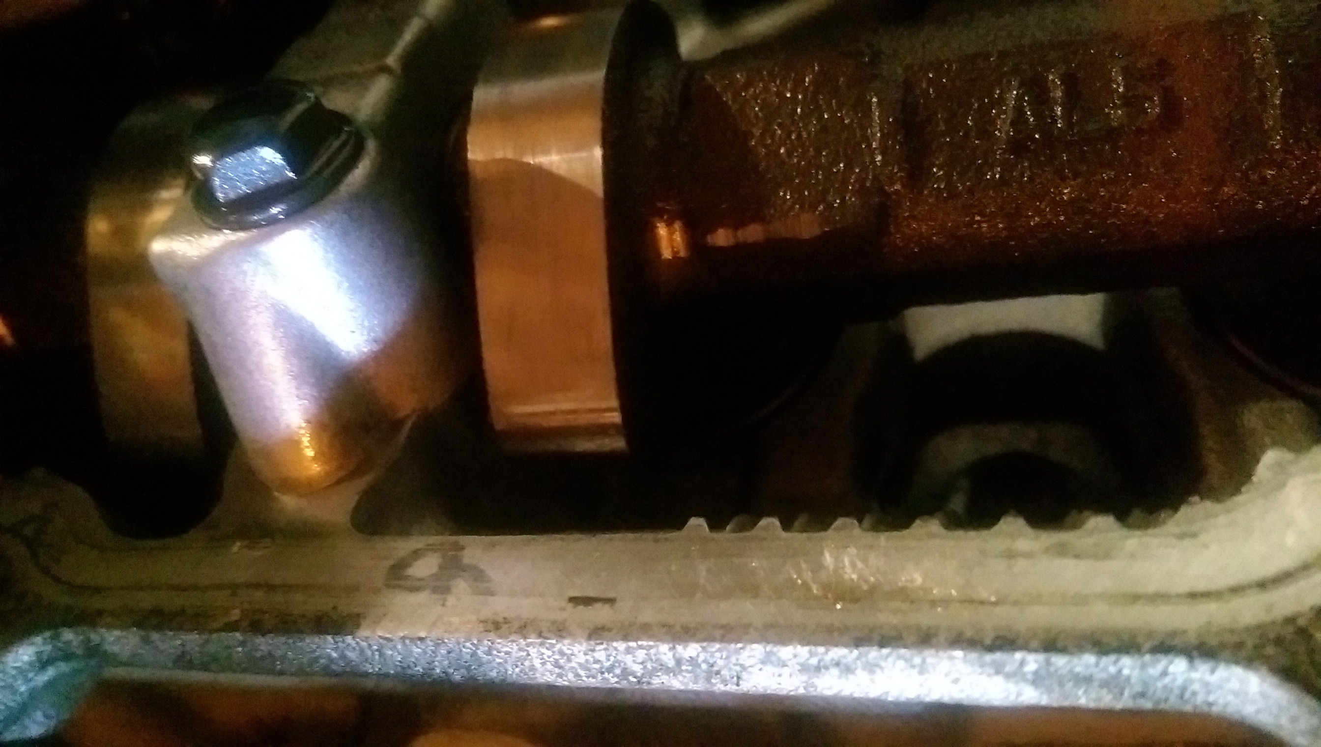

So got bored after awhile and started tearing it down cams look alright valves don't exactly look bent on the intake side. Gonna pull the clutch off and get it on a stand. It's got the carbonetics clutch which I'm guessing to remove it you have to disassemble the pressure plates and the clutch discs?

ya the turbos are shot...
i talked to these guys before and seemed legit. plus you can uograde your wheels to billet
www.workturbochargers.com

Yea I figured that much. I'll call the people at that site on Monday I talked to one of the sales reps from jwt about the rebuild kit. Though it's just the whole cartridge for 600 a piece...
