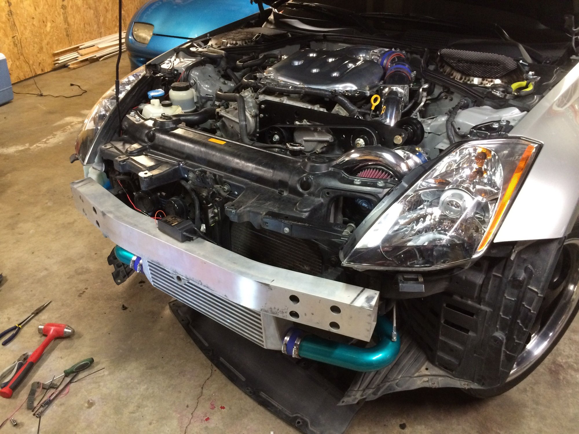

So I have owned my Z for a long time and have never done much with engine besides intake and exhaust and test pipes ..always went from show to show and I keep it clean and it lives in a garage. I came across a deal on a new vortech kit for a REV Up motor. The deal was too good and I could not pass it up. So I started the build and I have to finish up a few things but here is the progress. It is possible to use a rev up bracket but you had to modify it and move pulleys around. But it did work. Anyways on to the pics and it goes to Dynosty on the 24th for uprev and tune.

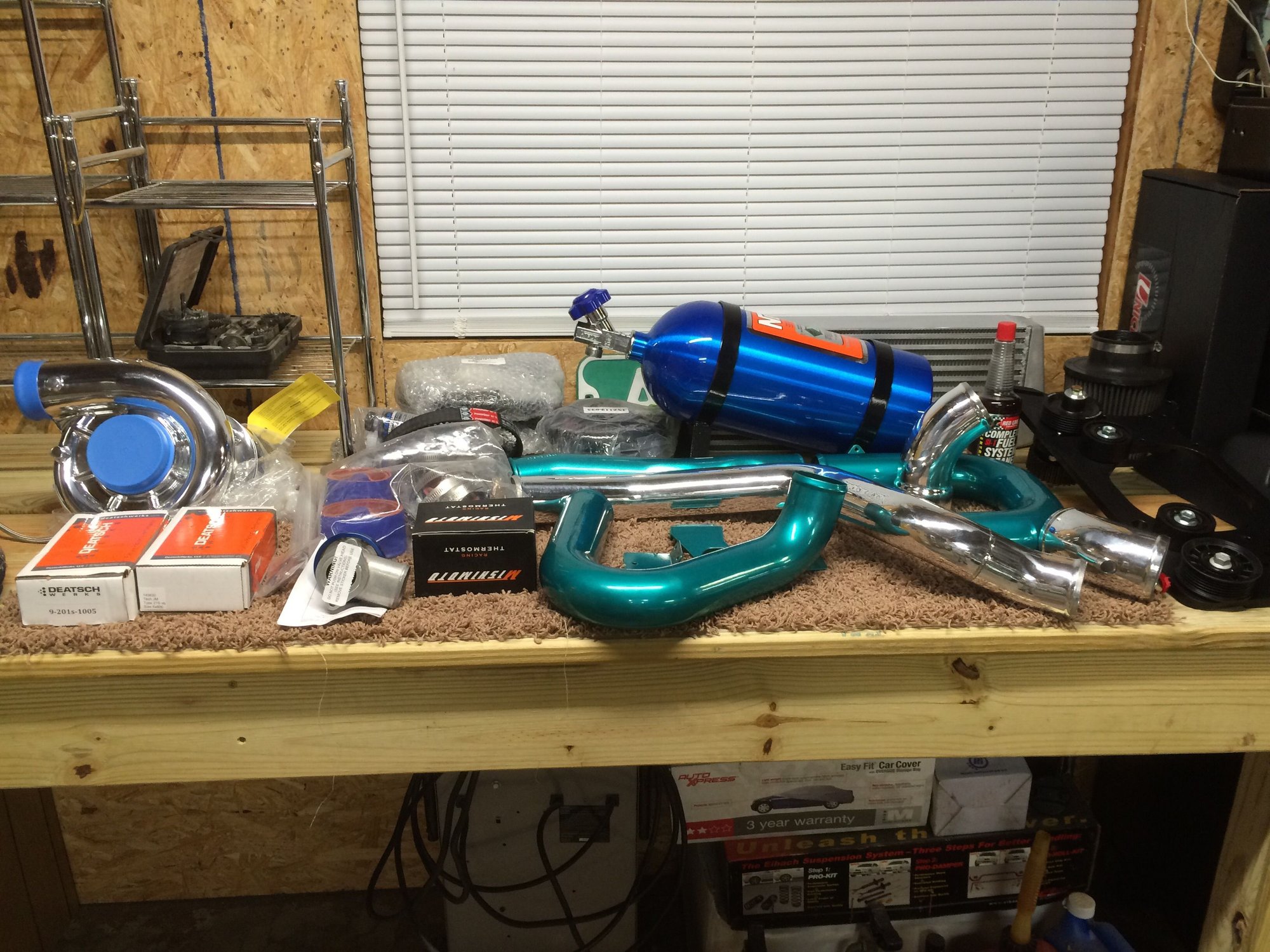

Old nitrous bottle not for the build.
Vortech V3 kit uprev with 3.12 pulley
600 injectors
Dw200 fuel pump
Uprev gt MAF
Don't mind the zip tie temporary until I am done
So it still has to be finished up so don't mind loose ends but this is the progress so far. I ditched the fuel setup and unichip it came with because I also got injectors and pump with the kit. Can't wait to finish it!

Hose goes behind the Vortech Bracket. And may be different on the Revup? So what are your plans for the coolent hose?

There wasn't a groove for the coolant hose on rev up bracket. On instructions for rev up install it says to attach to cooling fan shroud. I don't like that idea. Just like I didn't like smashing power steering cooler against radiator so I made a nice bracket to attach it too. I forgot to post pic of that modification

Everything looks nice, gratz on the great buy. BTW you may want to replace that bypass hose, it looks like it is quite swollen. Would hate to see it burst on/off the dyno.

I just went to the part store this morning and ordered the coolant hose no problem thanks guys for all the input I really appreciate it !
