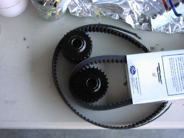

ATI Kit **exactly** 9 PSI new custom belt fits and it is thick!
I will no longer be dancing around at 11 or 10 PSI. For those that don't know ATI only lists one belt for all boost levels and you must remain under 65 teeth for the belt to fit right.
I couldn't make exactly 9 PSI with my pulleys (I have several.)
I came up with the idea to research a bigger belt (aprox 1 inch bigger in fact ) so I could go around the one belt size fits all setup.
This is not ground breaking, in fact ATI says to do this in their manual and EJ already quoted the reason and the ATI manual page as to why in another thread.
It took a special order request and a one week shipping delay and ATI provided the bigger pulley I needed and were given Kudos (and Kido's
I am flashed via Technosquare for ecatly 9 pounds, I could make 8 or 10 or 11 but not 9.......
TILL NOW!
Not only is the bigger belt here and a perfect fit it is a heavy duty Sportline belt for extreme temp changes!
I bought several hehe but I don't see this one snapping any time soon, but just in case you know; because they no longer make this belt! It is marked as "obsolete" but a few are left.
I hope this helps those that involved themself in the count your pulley teeth thread as a second option.
You can do what I call "the pulley dance" and hope, or now you can find a different belt and know....
Just thought I would throw this out there, this is not a BOAST thread I lowered my boost to make **less** power, not more so I hope it is not taking the wrong way. Just trying to help. Here is a pic, it is worth a thousand words they say.

Stop the press, is that tire tread? Man that is thick.
I think you will be safe with that belt Max. If not, you better look at chains
