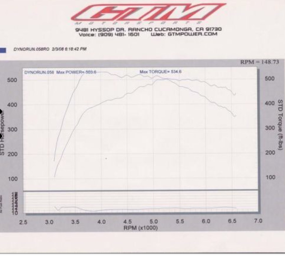

Look for thread under my user or GTM , my first kit was PE TT made around 550whp-580wtq if memory serve me on 91oct. At that time I believe Sam was telling me any higher boost it will blow hot air. On stock cam but built short block
