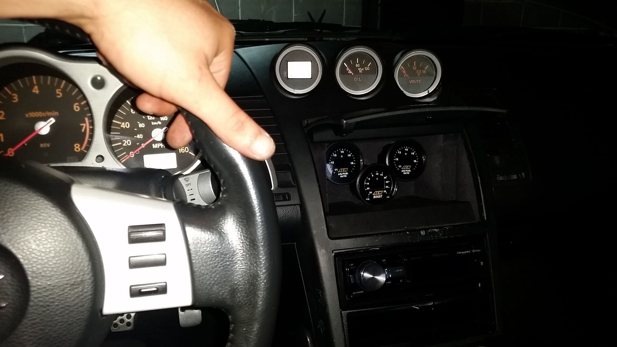

Hi everyone, I've been on this site for a while but hardly ever post anything. Gotten a lot of good info from members and threads. I thought i'd share my progress with my car as I said I would, and hopefully I can provide some help and shed some light to anyone going down this same route with their car.
Little backstory: I bought this car as I was advancing through my 20's when I finally got a steady job and could finally afford to build my dreams as a kid. Originally I had always wanted a S2000 but once I grew older and finally could afford one, I thought to myself why get a smaller car with 2 less cylinders that would cost a fortune to mod and bring up to what the stock power plant the Z could produce? So as a first time car buyer under my own name with my own money I went shopping for a hardtop Z. I looked around for a while and found an orange one with a 6 speed. When I got there it was beat to ****, automatic, and had way more mileage than advertised I was about to walk out the door when I was offered a chance to check out a silver roadster 6 speed with 50k on it. I said screw that convertibles are for chicks, and the chassis is gonna have too much flex if I track it. But I said screw it Ill check it out, 4 hours later I was driving away in it because I fell in love with it and I'm really glad I did.
The original plan was performance, suspension, looks. That didn't happen. I got in a fender bender, took the money, and said "welp, time for a body kit". So I did my research here and really felt that on a roadster aggressive is nasty so I chose something clean that I felt would fit the car.
Pretty nasty with stock wheels and suspension right?
I Built this with the street and track in mind so instead of going performance, I really needed to do something about handling, ride height, and wheels.
I ended up with stance GR+ss coilovers, Hotchkis sways, SPC adj camber arms (F&R), and Stance adj Toe arms in the rear to replace the spring buckets. Enkei RPF1's were the wheel of choice simply because of cost, weight, availability, and looks. So I threw it all together adjusted it, lowered the car, and had it corner balanced.
Side note: I did eventually upgrade the stock brakes to stoptech super streets and slotted rotors. Eventually will upgrade but for now I can stop well enough.
So after a season of driving like this I finally decided it was time to pull the trigger on FI, the entire car was basically planned out from the get go and while expensive I knew twins was the way to go if I wanted power on demand at the track and on the street. On our cars I feel over 500whp is overkill since they have a hard time putting the power down as it is without going sideways so I decided what the stock DE can handle is all i'm going to push it to for now. If(moreso when) my motor blows I'll do rods and pistons and build the bottom end but for now I decided i'd be happy with 8psi and about 400whp. So the build began.
And this was the final product. I have plenty more pictures but I felt this was enough, I'm very happy with the way it turned out. Its final numbers were 404hp at the wheels and about 430 ftlbs of torque. It pulls like a freight train through all gears and with the top down its really a symphony of beautiful sounds.

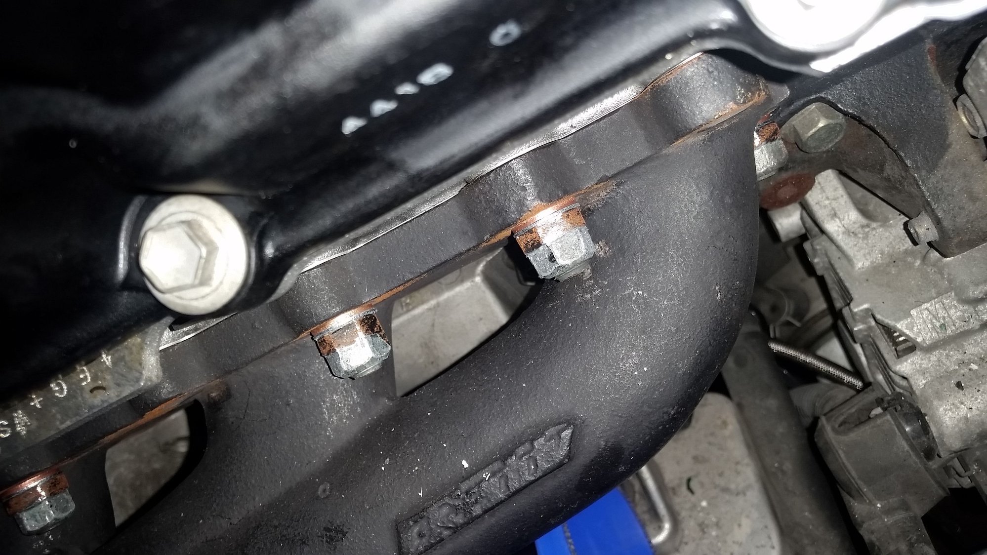

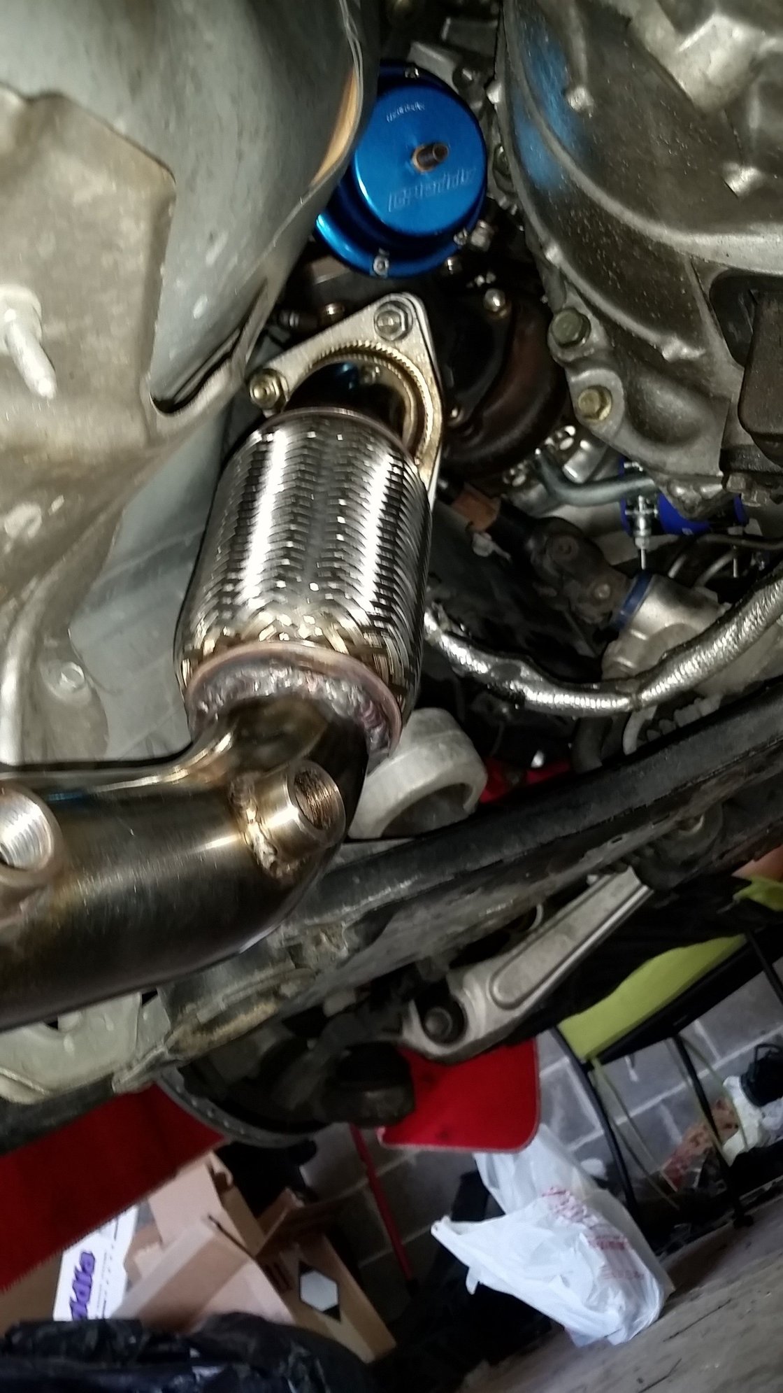

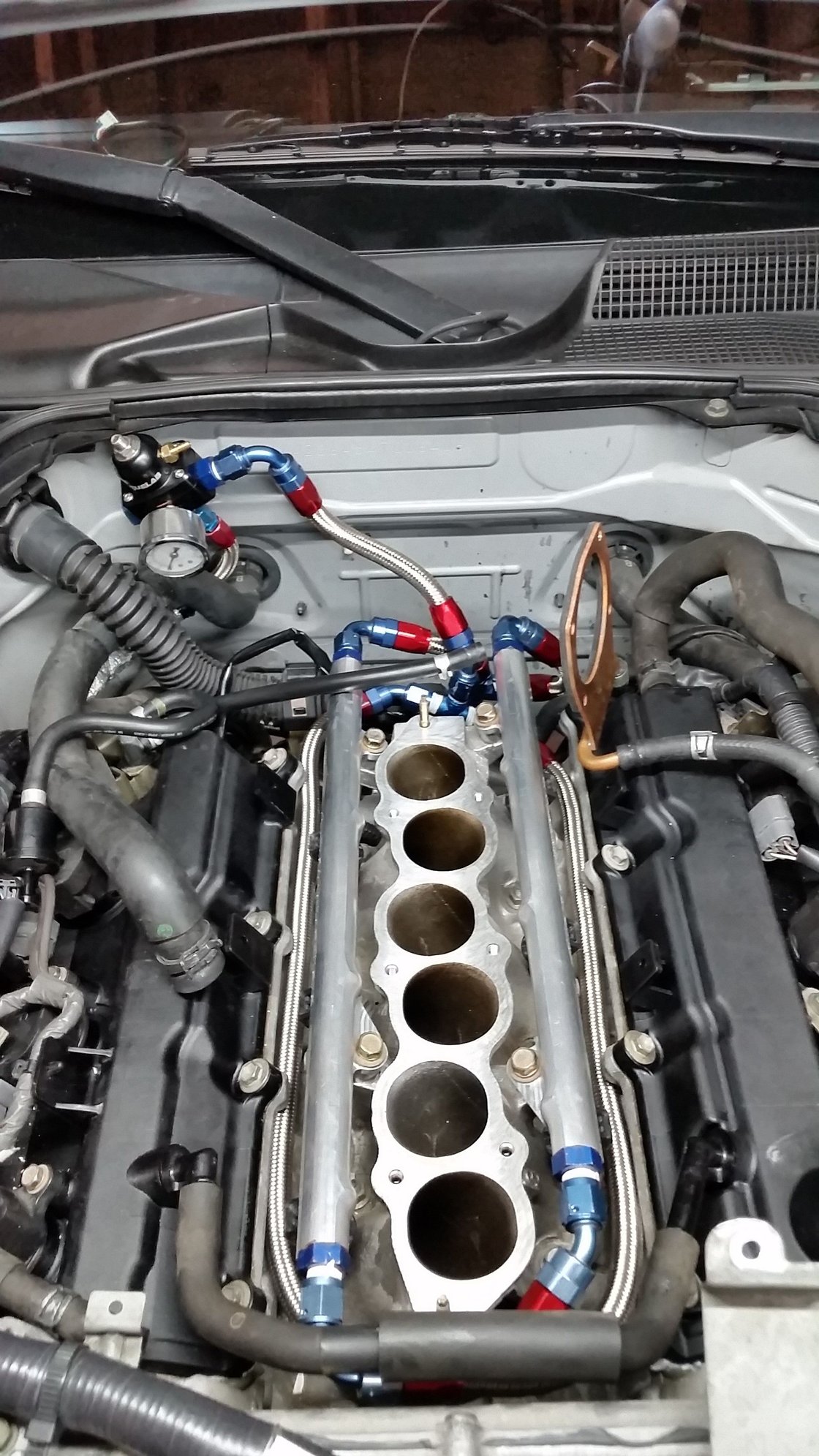

As far as pointers for installing the turbo kit for anyone looking to do this with the motor in the car I can't say it was impossible but I recommend you make sure this is not the first project you attempt. I've been wrenching for years and even though ive developed a lot of patience I definitely got pissed off at some parts to the point I had to walk away and come back and try again. Like everyone says, there just isn't any room and you'll have to craft some tools and find someone with small hands to help you.
I recommend re-using the stock exhaust manifold studs but shaving the torx heads off them instead of using the SS ones that come with the greddy kit, also re-use the OEM nuts and shave off the excess skirt around them. I used copper washers on all of the exhaust studs so that they crush and apply somewhat even torque to the greddy manifolds because they really are some horrible quality cast iron and I can see why they're so prone to cracking. Also if you're installing test pipes I recommend cutting and installing flex pipes about three inches from where they bolt up to the manifold, I've read that people who have done this have not had their manifolds crack but I have read that people have done this and they still cracked so it's up to you but if there's a chance theyll last longer i'll take it because trust me you don't want to pull these out in 6000 miles. I converted all the oil feed lines to -4an with premade SS teflon coated lines from summit, if the stock greddy lines leak or are lost it is damn near impossible to find them in the states. For oil return hose I used silicone lined rubber hose and hose clamped it at both sides, shouldn't have an issue there. Also a few of the charge pipes rub against the body and either you cut away what they're rubbing on or I recommend wrapping them in header wrap and securing it with mechanics wire or zip ties. Also zip tie all of your vacuum hose just as a precaution. I used Tband clamps for all the silicone couplers because I got a great deal on them and I don't trust the worm gear ones for charge pipes, you're not gonna want a boost leak because it may be in a place thats very hard to access(most of the places lol). Use high quality hardware and make friends with summit, I can't count how many times they saved my *** with little odds and ends you cant get anywhere else local. Loctite thread locker and torque specs are your friends when you are doing the intake plenum because it has been a year since I installed a plenum spacer and in 4k miles all the bolts came loose because i was too cheap to buy a good torque wrench and I followed motordynes instructions of tightening them down to hand torque with a nutdriver. As far as power steering cooler goes I relocated it as per the turbonetics single turbo install instructions and didn't bother relocating the wash tank since it's put in a useless location anyway. Also investing in a fire extinguisher like I did may be a good idea considering how close your fuel lines run to the pass side turbo, 8/10 times you'll be fine without one but in the event something does happen its nice to have considering how much time and money goes into this.
That being said, I apologize if my paragraphs have given anyone headaches.
Mod list includes
Body:
-Nismo V2 front and sides, Chargespeed rear
-Fenders Rolled
-Eyelids because need for speed yo
Wheels:
-Staggered RPF1's 10.5" rear, 9.5"front
Tires:
-Bridgestone potenza s-04 pole position 265/40/18(Front) 285/40/18(Rear)
Suspension and brakes:
-Corner balanced Stance GR+ss coilovers(spring bucket delete in rear)
-SPC front adjustable upper control arms, SPC Rear adjustable arms, and Stance adjustable toe rods to replace the spring buckets
-Hotchkis F&R Sways
-Whiteline polyurethane diff bushings
-Stoptech superstreet pads and slotted rotors
Audio and Gauges
-Pioneer h/u
-2 AEM uego A/F gauges(one for each bank), AEM boost gauge
Drivetrain performance
-Greddy 18g twin kit with intercooler add on and greddy type-S BOV
-Motordyne 5/16 plenum spacer
-HKS Hi-Power true dual exhaust
-TurboXS test pipes with custom added vibrant turbo flex pipes
-AAM fuel return system with walbro 255 and RC440 injectors
-TurboXS MBC
-ACT HD-SS street clutch and Streetlite flywheel, SS Clutch rubber hose upgrade
-Optima Red Top(Not really performance but in the engine bay)
Oils
-10w40 Royal purple full synthetic motor oil
-Royal purple synthetic gear oil for the trans(Made shifts like butter)
-Valvoline Synthetic diff oil
-Redline ATF for power steering
-Nissan OEM coolant
If you've read this far thank you and if you have any questions feel free to ask, also thanks to the members on here who helped me out with my questions it really pulled things together and helped me out.
