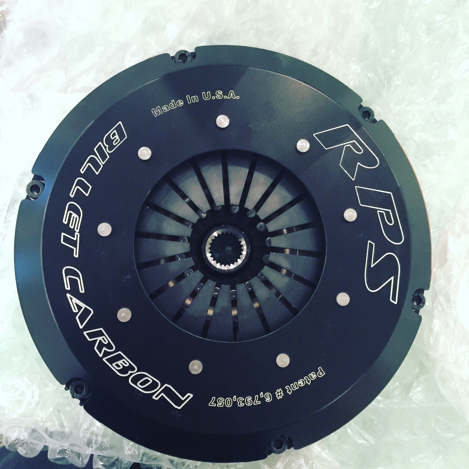

Old Feb 14, 2016 | 05:23 PM
350z-900whp's Avatar
350z-900whp
Posts: 736
Likes: 19
From: Kuwait city
Go with RPS twin or triple, I my self went with triple the drive ability almost like stock clutch I was impressed by the clutch .
