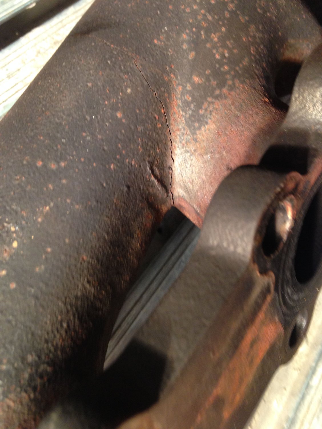

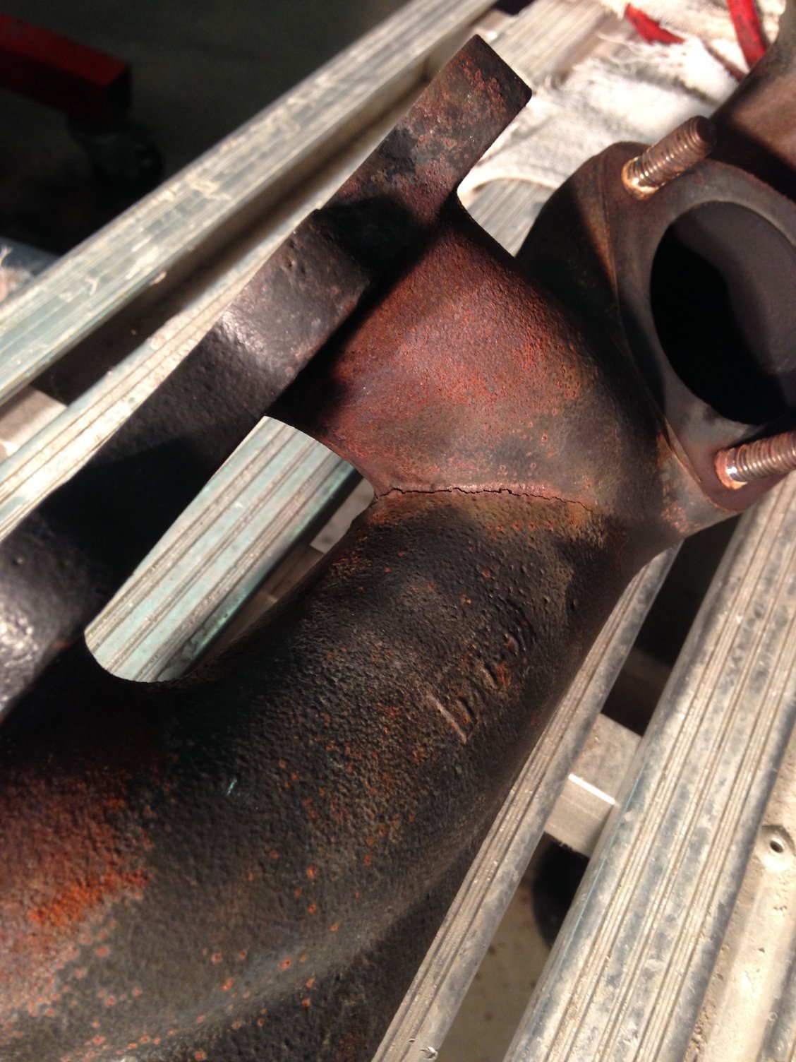

So the time has come to address the cracked greddy manifold I have. Just got done pulling the manifolds off. Was gonna have them fixed (welded) but it's seems worse the. I thought. Now I'm tossing around getting new ones but I heard that buying parts like this from greddy sucks!!! Anyone have any suggestions or can direct me to a company I can go through that I know can help me? Thanks for any help anyone can give me!!!

That was my plan but from what I'm hearing it has to not only be done Rt there is a certain way cause it is cast. Idk and the crack is pretty bad it runs all the way around In between the flange and the pipe. Gonna be a real task if someone can get In There. Don't get me wrong if I can I would much rather do that. Just trying to have all backup plans in order. I have a lot of things to address while I have the motor out

That sucks. Looks like a passenger side. Are you on stock motor mounts? If so...get solid.
There is a guy trying to produce these in SS tubular but I bet they will be like 1800 or more.
The trick to welding cast iron is to grind out the weld, pre heat and weld past the crack. That is a large crack so it may not be salvageable.
