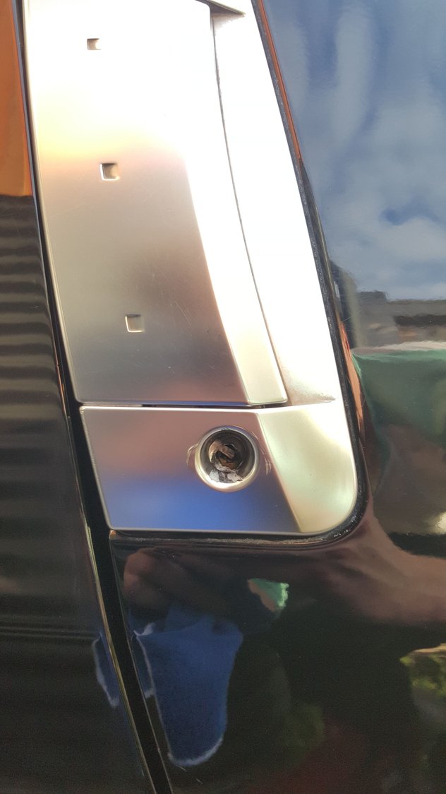

So looks like some low life scum of the earth has taken to my key lock with a screw driver in an attempt to break in.
Does the whole handle need replacing? Does a new lock have to be fitted/cut to fit my key.
Thanks in advance.
Rob

That blows I would think that just a new lock cylinder would do it but most will be a different key. I would call a locksmith and see what they can do about salvaging that lock cylinder.
Wonder why they didn't just go through the window like a normal scumbag.

Do you use your key in the door?
Buy a USDM handle and swap..that may work.
Or cut the two wires on the window switch that go to the key cylinder.
