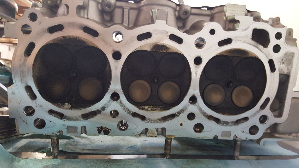

My overheating issue seems to have come from one of the previous shops pouring radiator stop leak in the radiator and clogging the rad., block, water pump, thermostat etc.....of course no one admits to doing it. Another 10k fckup.
Starting over (3rd time), with an RJM closed deck block, ALL hot parts ceramic coated or anti friction coated, and all new coolant system.

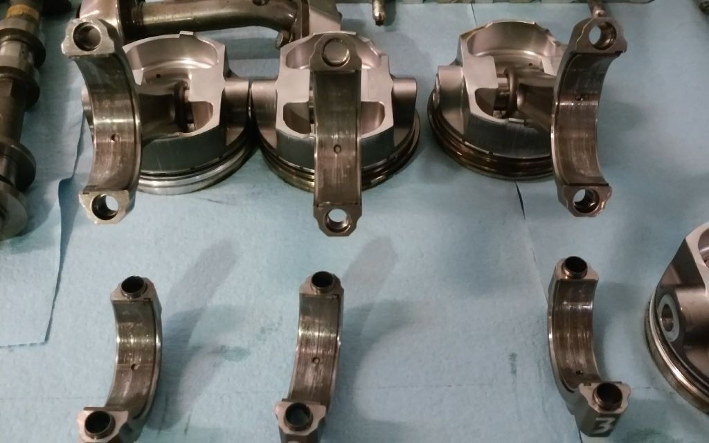

The SFR built engine with 100 miles on it shows about 20k miles worth of wear on the rod bearings according to Nik.

After seeing the interior, including bad bearings after 100 miles from the SFR rebuild, the decision was made to reassemble the engine correctly and with better parts that have come available in the 5.5 yrs that the car has been under construction. Closed deck block, ceramic coated heads, valves, new coatings throughout, new L 19's and ARP main atuds etc. etc.....
