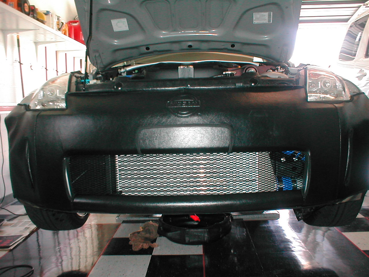

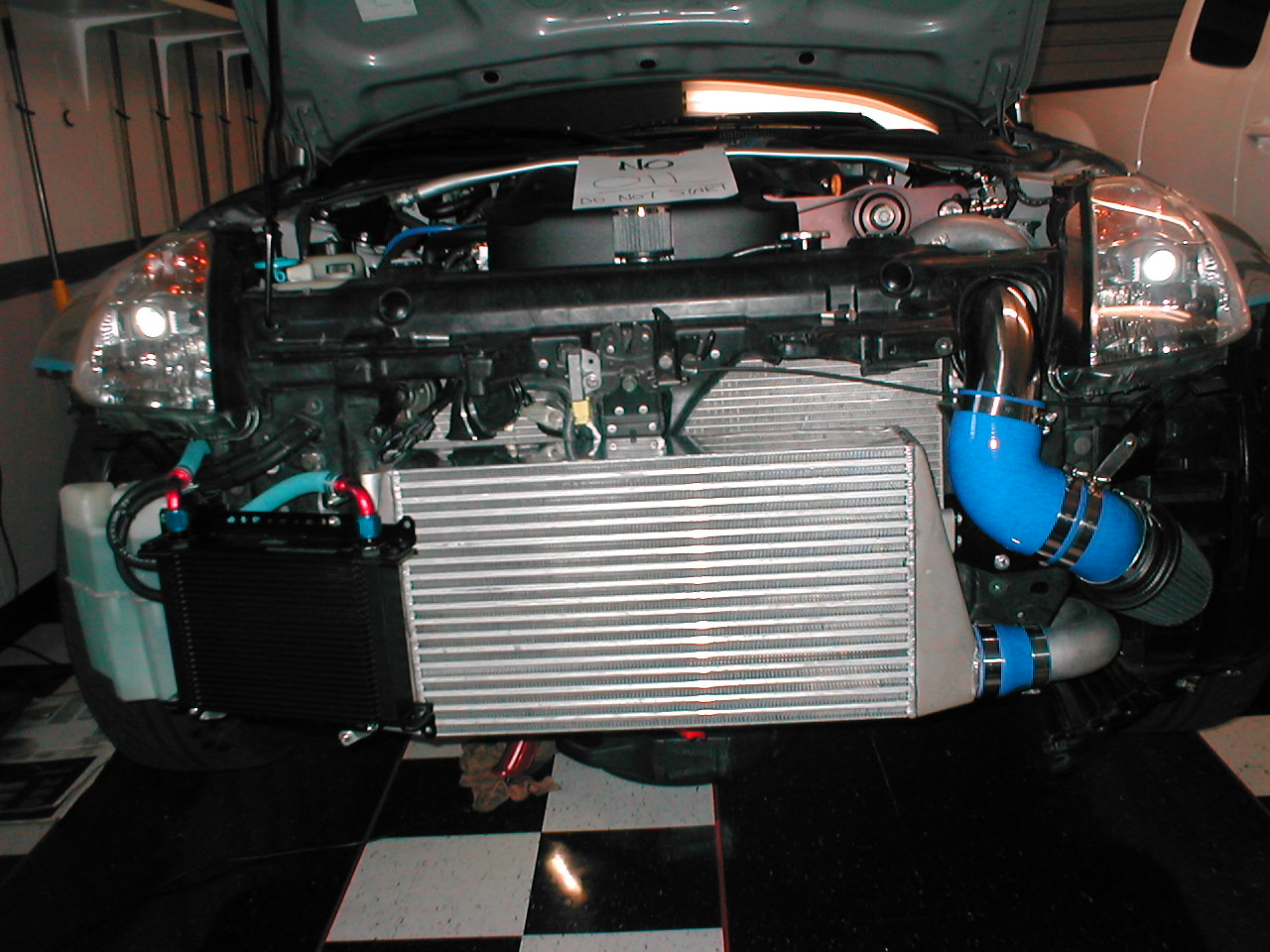

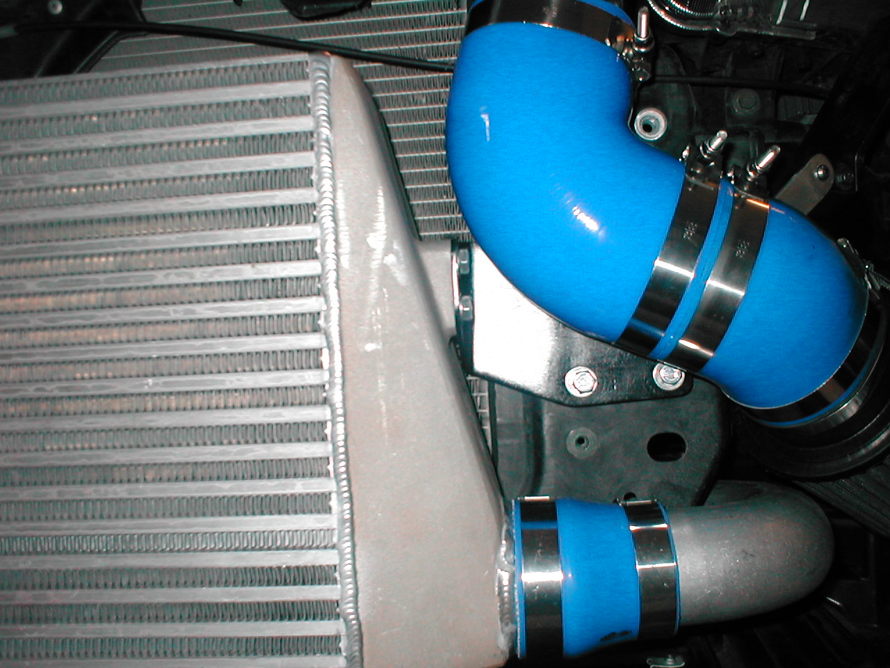

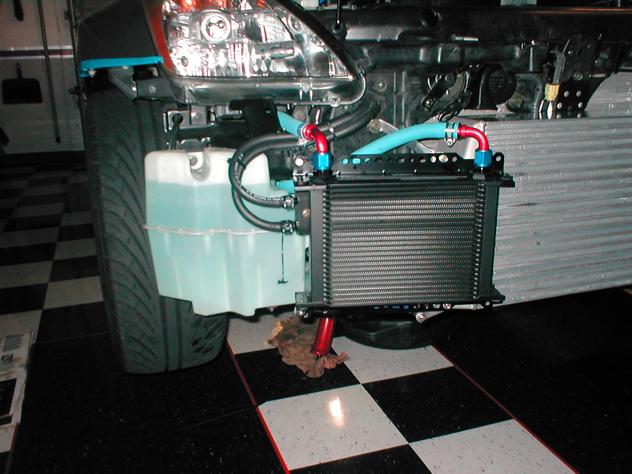

If you are looking for 400-450 then.....
And if you think you may want more down the road, some things like the fuel system you should just do now.
1. Headers with 2-1/2" diameter Test pipes and quality 2-1/2" Duel Exhaust
2. CJM Stage 2 Kit and a DW300 Fuel Pump and 600cc Injectors
3. Catch Can
4. 34/28 Cog setup, you only need to buy the 34T Pulley. Best deal is SuperChargers Online
5. 3.12 Serp Pulley
6. A higher quality and better cooling Intercooler, Best bang for the buck is a Treadstone TR-1245

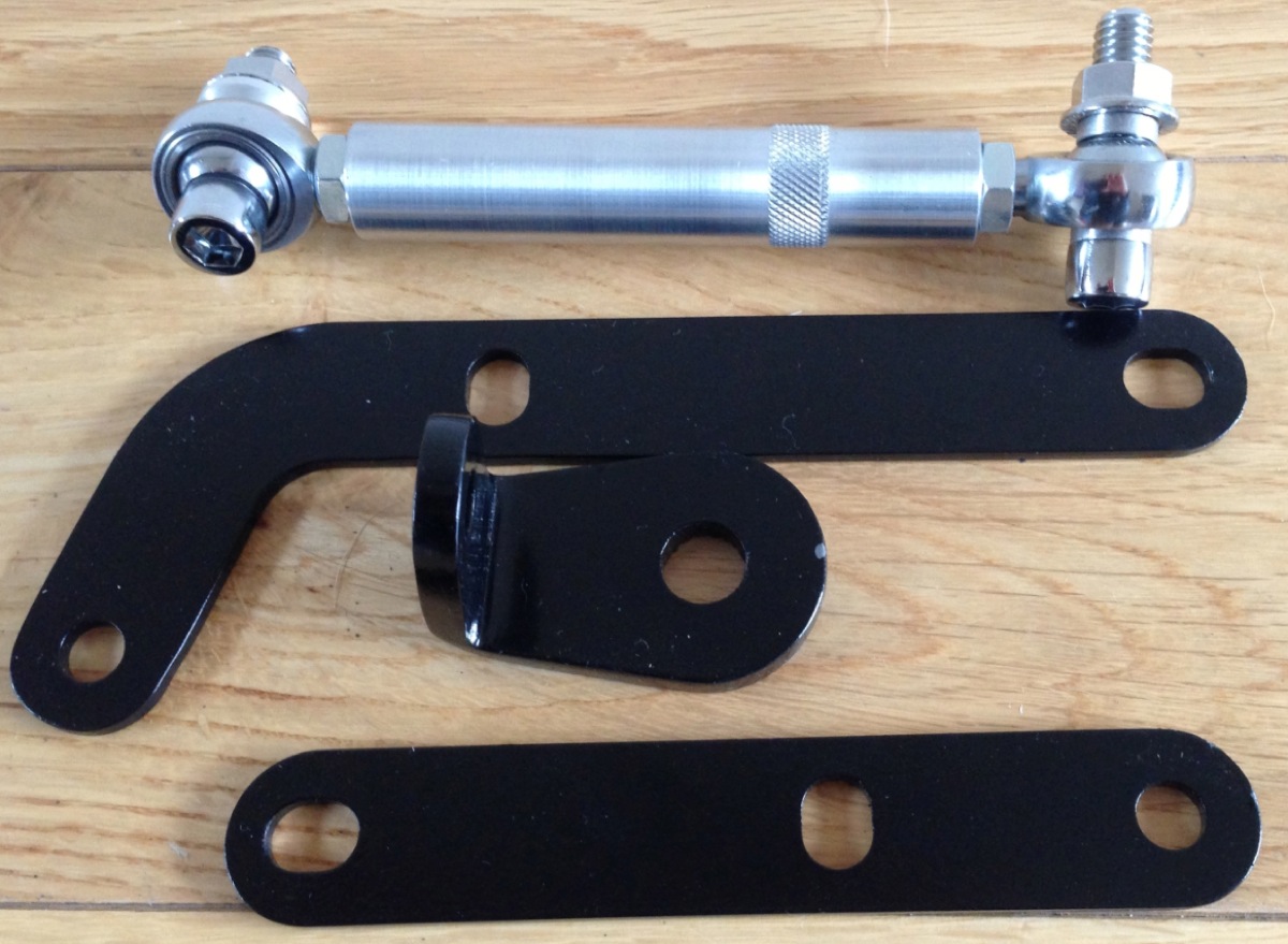

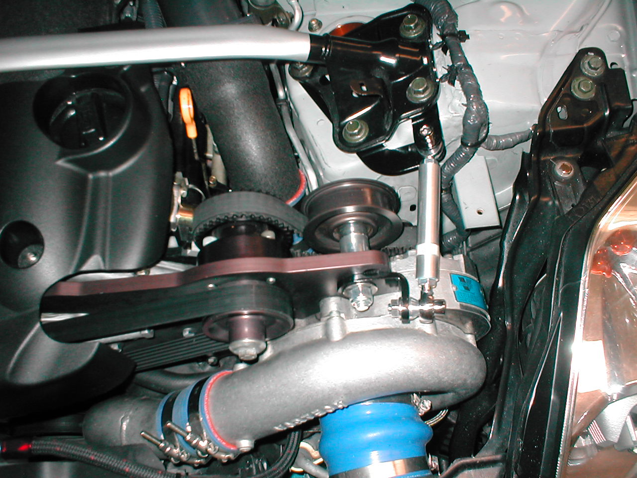

7. A TimRod Radius Rod Kit to keep the Bracket from flexing in the higher Boost.
8. One step colder Plugs and Gap them to .034" for that boost range
Hope this Helps

awesome post oldmanz350, thank u so much for helping me map out a direction to go. and the pictures are a huge help so thanks for those as well
i was looking at the Treadstone as ive seen alot of guys on here using them or posting about them, ur right, cant beat the price on that unit. I know the guy i got the Vortech from had a smaller pulley that he bought when he had it on his Z, not sure which one but ill look into that. Ive also seen quite a few of the same intake setup that u have in ur pics...thats something id definitely like to do as well, what did u use for that?
Intake is all 3-1/2" diameter tubing and hoses
You missed Number 7 on the list, very important...
