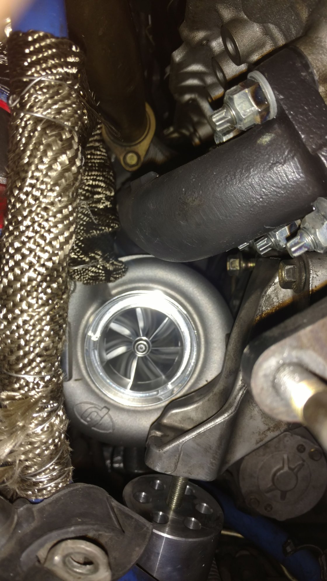

Turbos are back and back on the car I'm working on getting the driver's side turbo clocked correctly which is proving to be a gigantic pita. The -10an drain line idea isn't going to work there is not enough room to put the fittings and hose on so I'll be sticking with the factory drain pipes to the bulkheads I put in the oil pan. Hopefully it works correctly. Also got an in pre turbo inline filter I have installed.
Turbos look cool. Amazing how much room there is on the intake. Such a large coupler for a small inlet pipe.
As for clocking...you want the chra to be pointing down and the turbo outlet at like the 7 o'clock position so when you put that small L shape it is parallel and nearly touching the oil pan.
figured the 10an wouldnt fit.

Originally Posted by bealljk
Blowers look sweet! assuming fitment was spot on?
where does this inline filter mount to? I think these are a really good idea but I read on an evo forum that they can be problematic.
#1 get something that cant clog ... if it clogs your blowers die...
#2 get something super high quality, if the screen material breaks loose it'll clog and/or kill the innerds of the turbo...
I'd mount this somewhere where you can access it easily...hence my giant Peterson right on the front of the block...
Ya fitment was the exact same as the 20g's. The FP blacks and the 20g's are the exact same physical dimensions. Only difference is the larger compressor wheels and machined port shroud compressor housings. The only real difference was the air intake snout on the compressor housing was a bit shorter which actually worked out for the better with how close these turbos are to the motor mounts. Car is running and I'm about to go bleed the cooling system and go do some logging to see how far off the tune is. Gonna try my luck at a roll racing event tomorrow. I'll leave it on 16ish psi for now until we can get title back on the Dyno for C16 and higher boost tuning.
