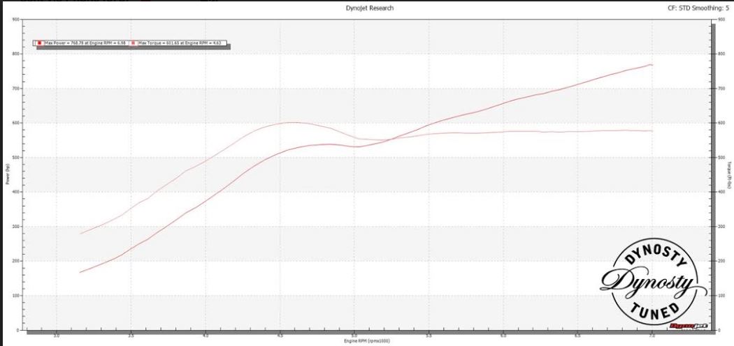

Alright guys so I finally got my car back on the Dyno after installing the FP black turbos. Now my first impression for the butt Dyno was that the turbos made a pretty big difference. Last time on a mustang dyno with the 20g's my car made 527Whp and 554wtq @16 lbs of boost. After installing the turbos I didn't have to change the tune much. I made some slight changes to the fuel map. So I added more boost. I bumped it up to 20psi. First pull on the same Dyno at 20psi was 520whp and 602wtq....? I was a little upset beings I had just dumped 2k into the FP black turbos. So I added a degree of timing and final numbers were 572whp and 571wtq. I'm tuning on pump93 and VP110 mix. Why did I gain no power from turning the boost up? Only torque. I was expecting to see around a 80whp gain from the boost increase alone. Input would be great guys.

Turbos are out of air at higher rpms and boost or exhaust backpressure is too high. Either one and high rpm torque will fall off. I think the compressor wheels have more in them, so I'd look for an exhaust restriction... (I've seen 18Gs make 700)

I don't think it's a compressor / intake side issue or a turbine issue. Greddy 20Gs should easily get into the 700s at those boost levels on these motors. It's got to be an exhaust side restriction. Muffler, cats, or small piping.

The fp blacks didn't come with a compressor map. But they supposedly flow 71 lbs per minute each vs 41 lbs per minute with the 20g's. I was expecting around 100whp with added flow and boost and having to change the tune. But obviously that didn't happen. I will be switching the car to E85 probably next season or later this season and adding boost again I'm not messing with meth injection it's just another thing to fail. The exhaust is straight dual 2.5" from the turbos all the way back to the muffler I don't see that being a restriction. And the intake manifold is a Crawford upper plenum with ported lower plenum and runners. But the heads are stock. I'm sure head porting and 1mm oversized valves would help with flow but I probably won't take the car that far that stuff is expensive. I ordered some Hoosier stiff wall slicks and thinking about buying the import drag solutions rear drag suspension kit. I need to make the car work before I add anymore power. I have logs of it spinning at over 100mph on the street tires.

Your exhaust is the choke point. 2.5” piping and muffler. Probably the muffler more than the piping. Take the muffler off and give it a go on the dyno!

Just unbolt the muffer for the dyno test. You don't even have to remove it. I lost close to 200 whp adding a muffler and got 99% back with boost based cuts outs that route around the muffler at WOT.

Iat's were definitely high and we made 3 consecutive pulls on the Dyno. They were having issues with room calibration. I had the engine fans running on the Dyno and they pull air off the radiator which will be fixed later this season I'm going to make some new air intake pipes for the turbos. I may also do the boost activated cut outs and see if it makes a difference or build a whole new exhaust setup completely. Here's a pic of the Dyno graph for reference. Had a misfire toward the end of the pull which I'm guessing was detonation caused by the high iat's. The car feels fast boost comes in hard and keeps on pulling. But your right numbers don't mean everything I raced a 700+hp turbo LS 4L80e fox body and was on his bumper at 140mph. And that car was at least 500lbs lighter cause I had a passenger and his weighed in at 3050lbs.

I've not posted this in my build thread, but my graph looked like yours up top when I added a muffler; torque fell off in high rpms. Put on exhaust cut outs, and flattened out the torque curve up top. This is with a modified G37 muffler and 4 cats on there, 100 cell and 200 cell in series! See attached.
