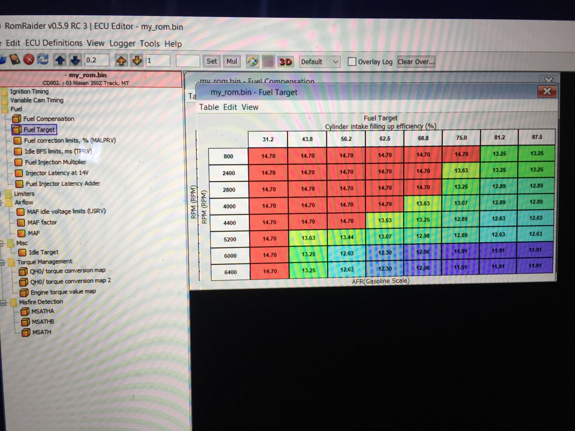

Romraider is a opensource free tuning software, there is a dedicated forum for Nissan tuning, however its pretty extent and my knowledge on how to tune is limited, but what I do know is that it has a logger but you have to buy openport 2.0,
I dont have to worry about emissions testing, I guess im going to have learn how to tune with romraider because free is good

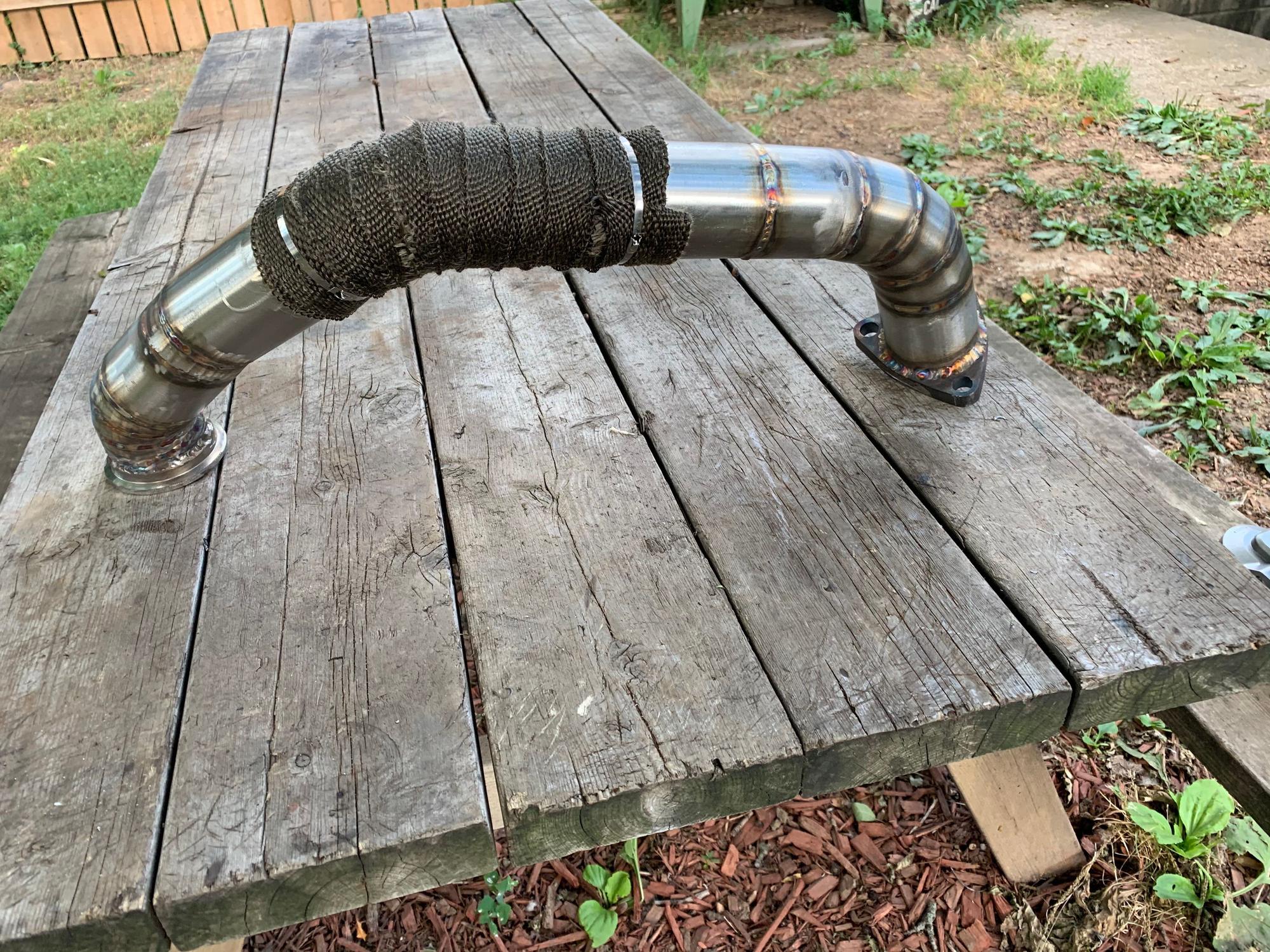

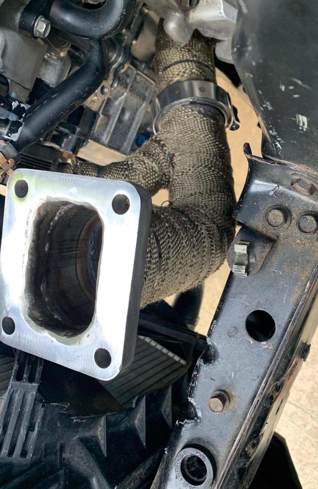

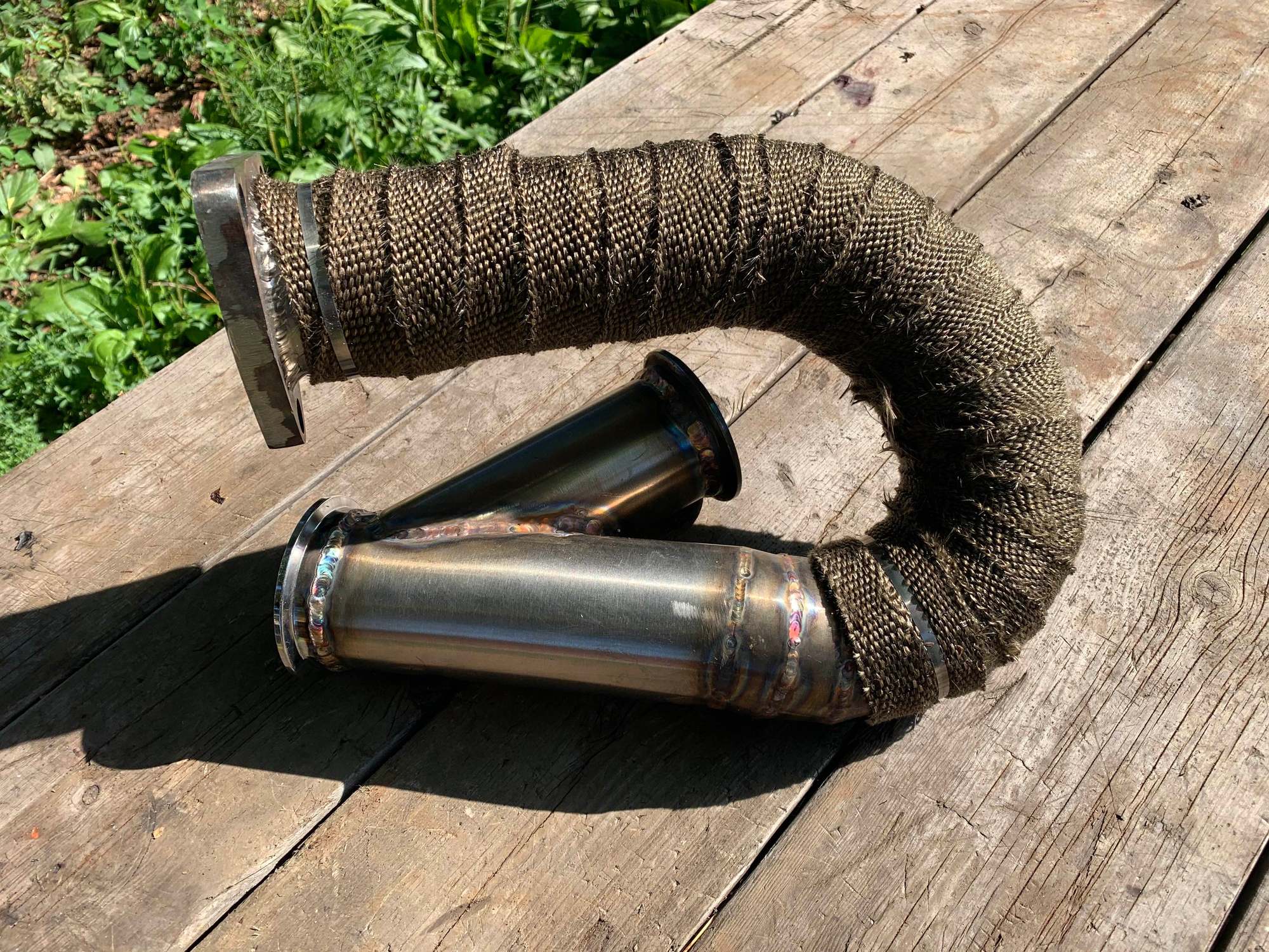

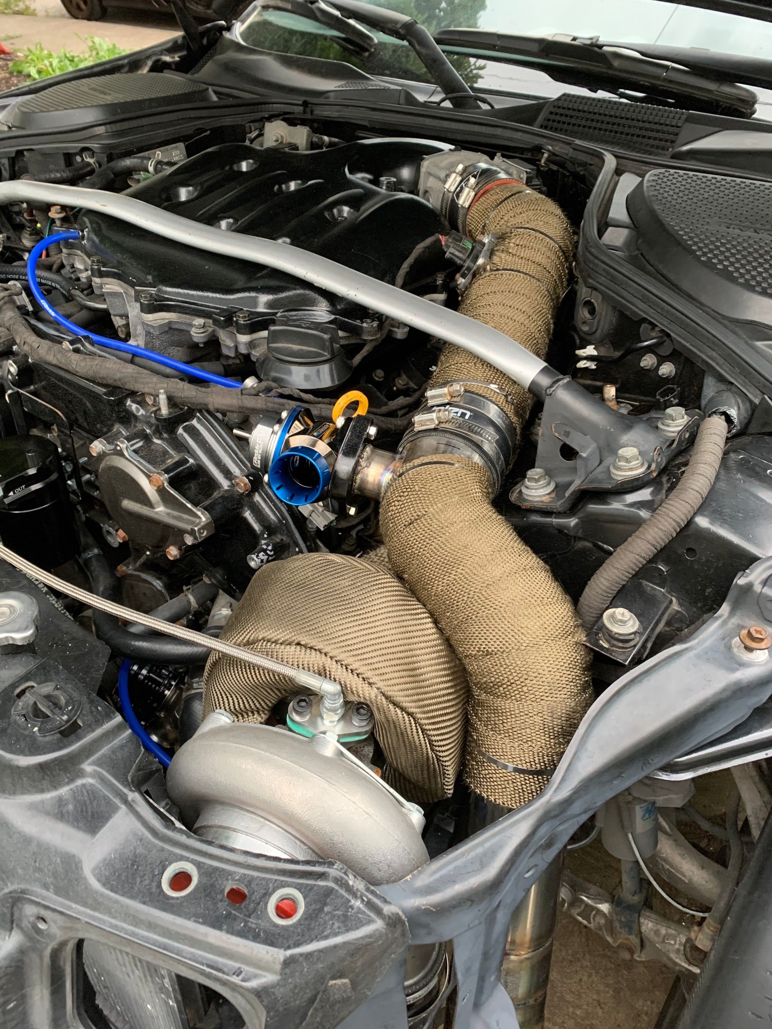

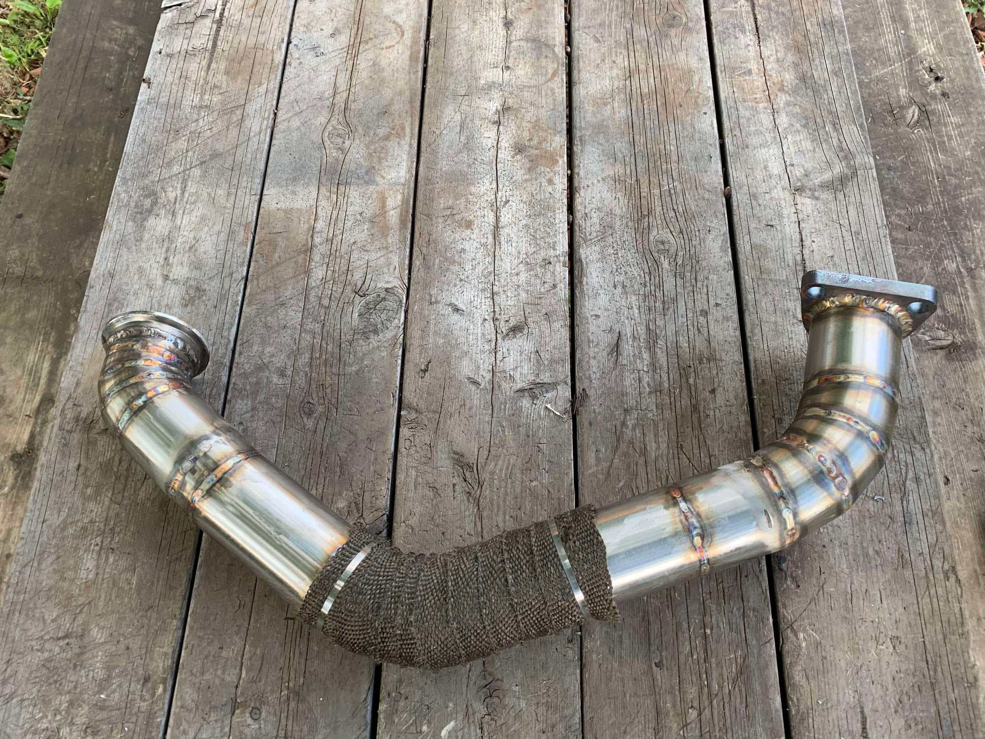

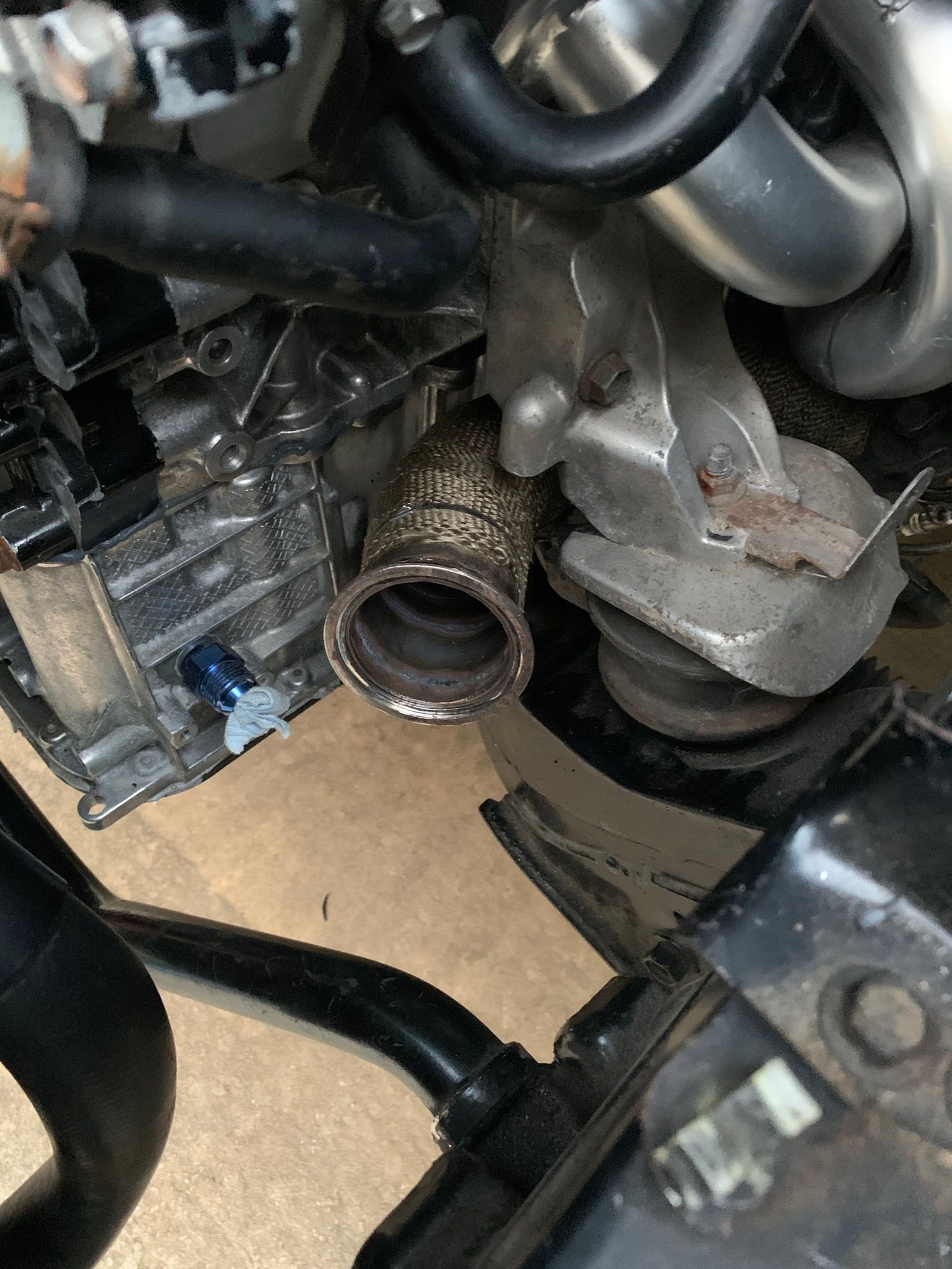

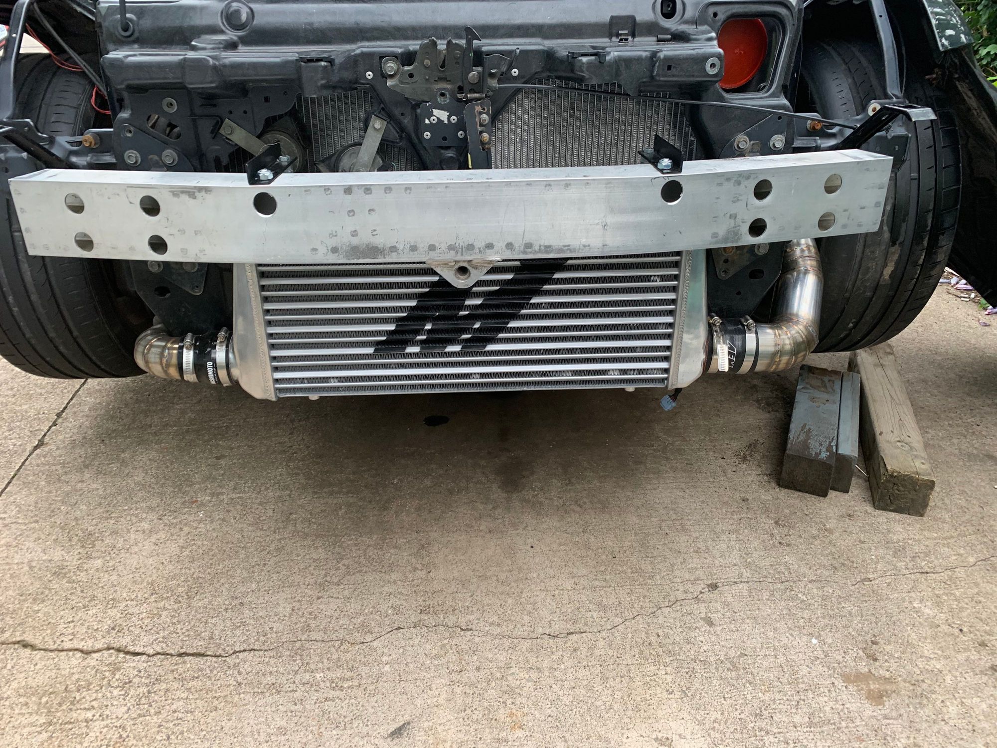

been awhile since I've posted anything, so I decided to redo all the hot side piping for the turbo didn't like how it was laid out,
my tig welding isn't the greatest, still learning,

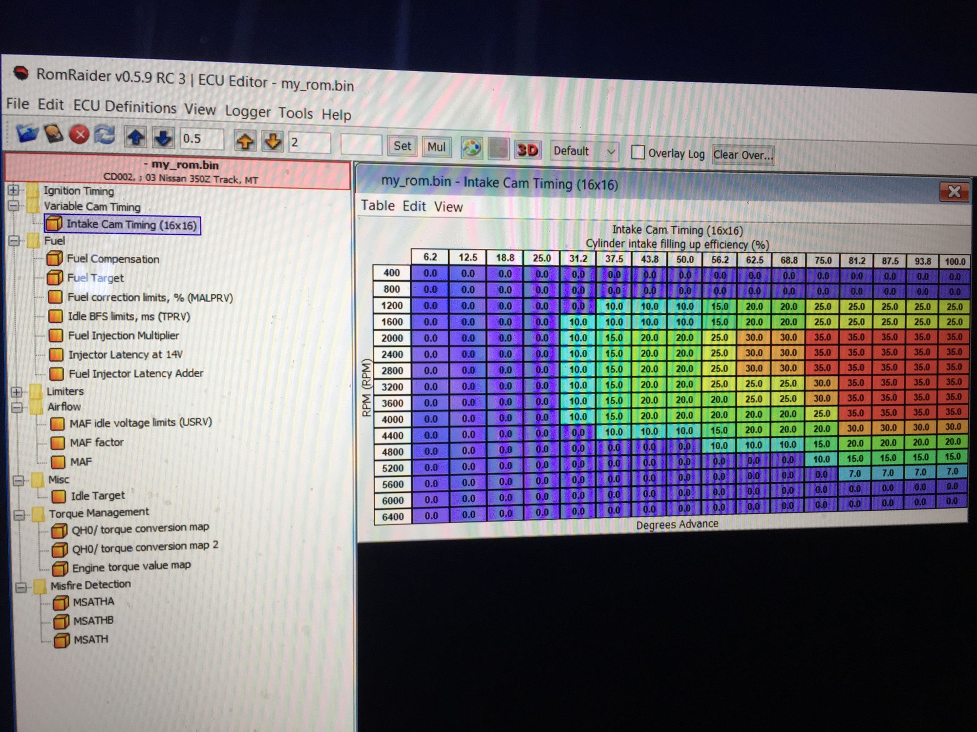

thanks to the boys over at romraider nissan forum for all there help with learning how to dump and flash my rom, and the hard work they do over there, and a big thanks to pytrex for all the help
