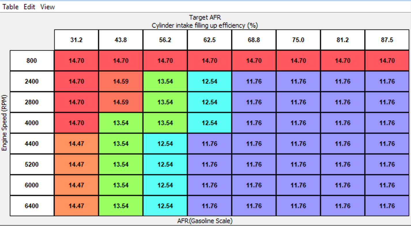

base maps ive been working on, most of you aren't probably used to Nissans proprietary maps
3.5bar 660cc injectors to get my value 27592x335/660=14005

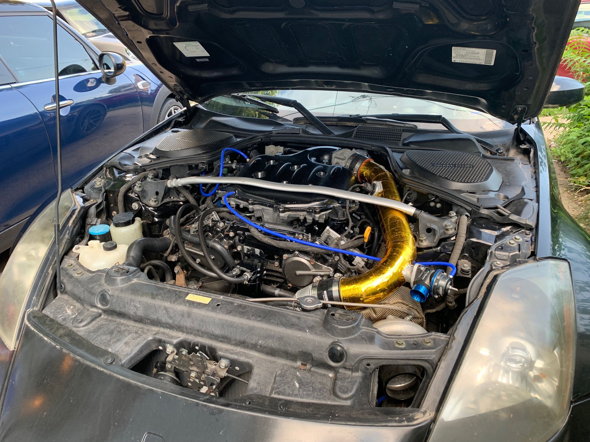

been doing some more adjustments to my setup. i decided to go with ID injectors 1050x, i also picked up a pair of aluminum valve covers, with the ability to change out the seals for the spark plug tubes,

just finished installing them,
all thats left is to install air intake for turbo, long day installing everything,
