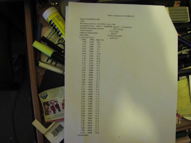

Well as it turns out my guage watching was spot on. I ran the thing to 6500 rpm's and never went above 12.2 but mainly stayed in the 11's after boost kicked in. This is without a booster pump, FMU or anything, just a reflash and larger injectors, I for one am damn impressed and thankful to these guys in Torrance for their amazing programming. My EGT guage never even went off at 9 PSI set at 8.25 C X 10.
Crap can someone host a text file? When I reduce the print out to 640x480 you can't read it and I am having website issue. Or I will work on it later I have a friggen head ache.
Long story short it goes from 11.2 to 12.2 under WOT above 4k rpm's
It never goes above 12.2 under heavy load in open loop even at 9 PSI and 6500 rpm's.

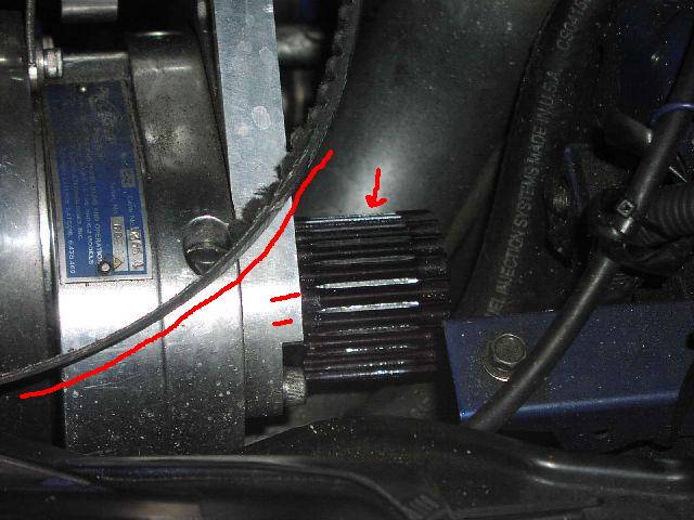

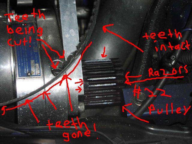

Follow the red line that shows *all* of the teeth missing then continue to where the teth begin and notice they too are being cut at the top like a knife thus weekening the belt. Then look at the pulley. It is not only silver, lost the paint (normal) but is actually gouged into a razor sharge edge in 2 or 3 places.
at 350+ RWHP it started kicking up belt teeth at us one by one and then it was shut down, the Operator said it read 391RWHP and 8.5 PSI (it was starting to lose pressure because of the belt) now it is a 5k cold air kit again Napa didn't stock the belt and once again I call ATI. Is this fun? Hell no.

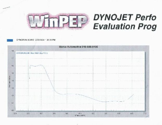

A/F Chart for my 2nd run before belt failure.
I feel safe to track at least now, my primary concern was my A/F ratio's. As soon as I get a new pulley and belt I am track bound.

Here is a high RPM 3rd gear pull A/F Chart up to 6700 rpm's

Hey Bonz thanks for joining. Yeah I had belt wobble and even posted a video of it. That was the #41 pulley facing the bracket it is on the big cog belt. I fixed that and that belt has never broke again, that pulley was warped. The front Cog Belt runs very true now and has a smaller pulley a number 38.
Look at the pic, it is the smaller Cog Belt on the firewall side that just turns with the compressor it doesn't have anything to do with the boost pulleys it just spins around and the pulleys don't need to be changed. It is a small belt. I will get a better pic tommrow in the day time.
Does this pic make more sense?
Teeth are completly gone up to where you can see them being cut off slowly then the teeth continue, IOW where the red arc is the belt is BALD (no more teeth, they flew off.)

Can everyone read the A/F Text? Does it look about right and in spec for 9PSI, should I lower it to 8 PSI?

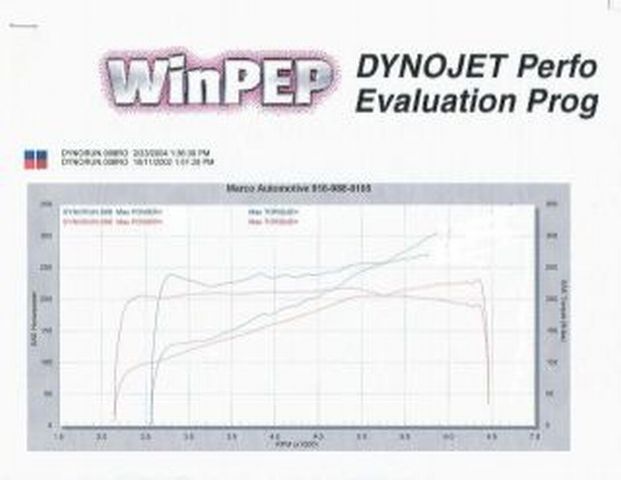

Here is the run that blew my belts out and broke up, the bottom run was my stock dyno of 232.
