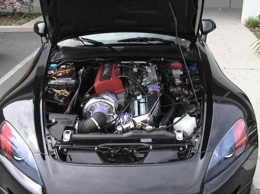

It’s just the stock intercooler behind a g35 bumper.
Sort of miss the aftercooler setup on my s2000s. Worked great if the water pump stayed on.

That's Beautiful.......
