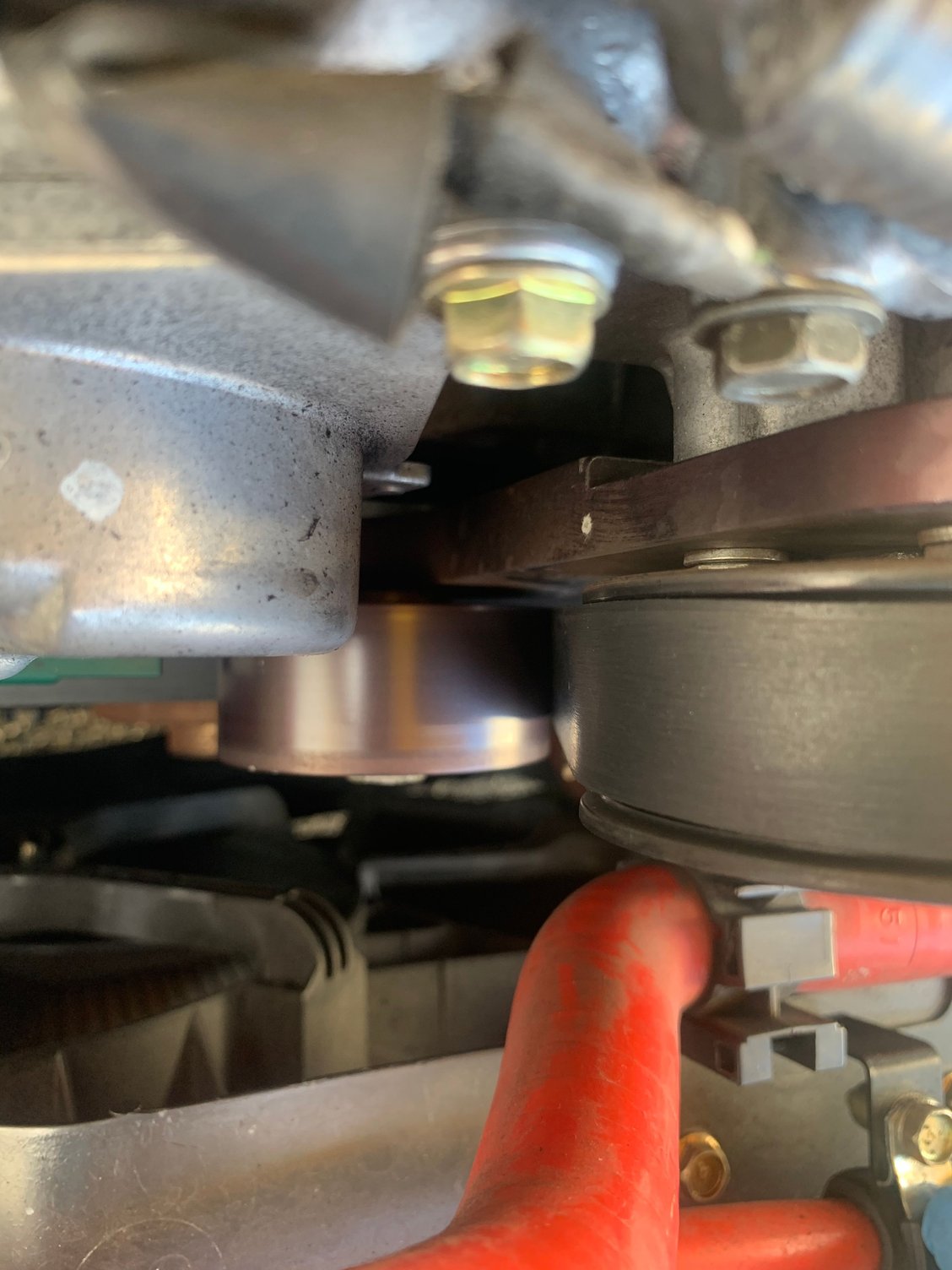

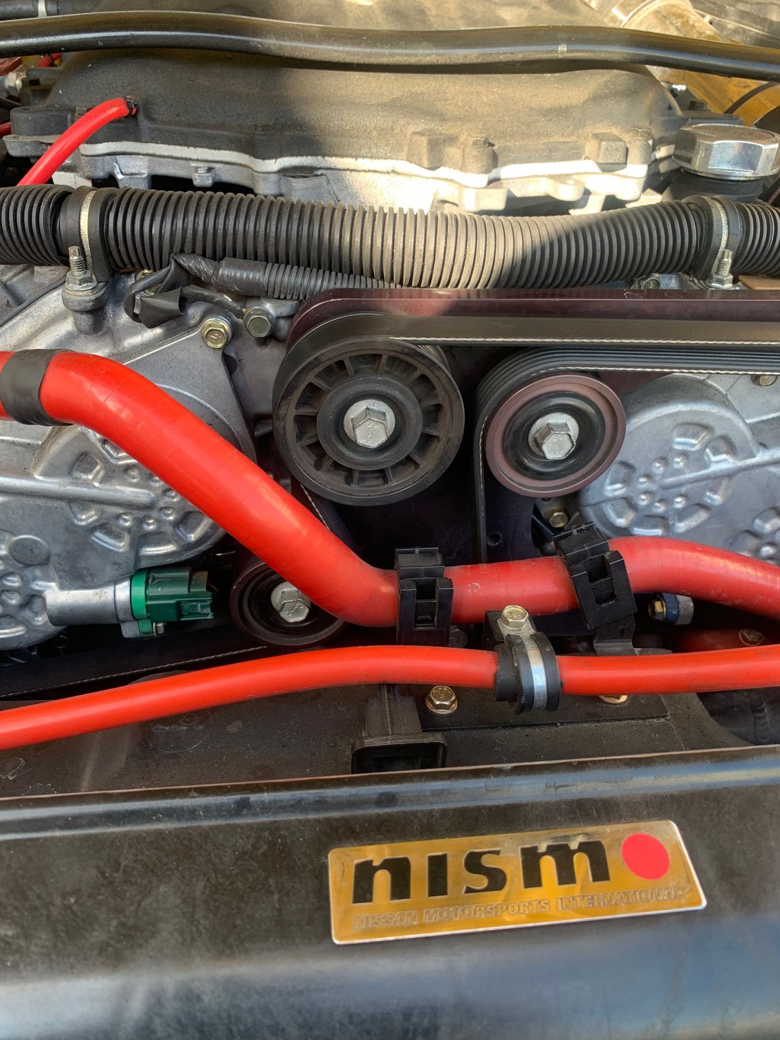

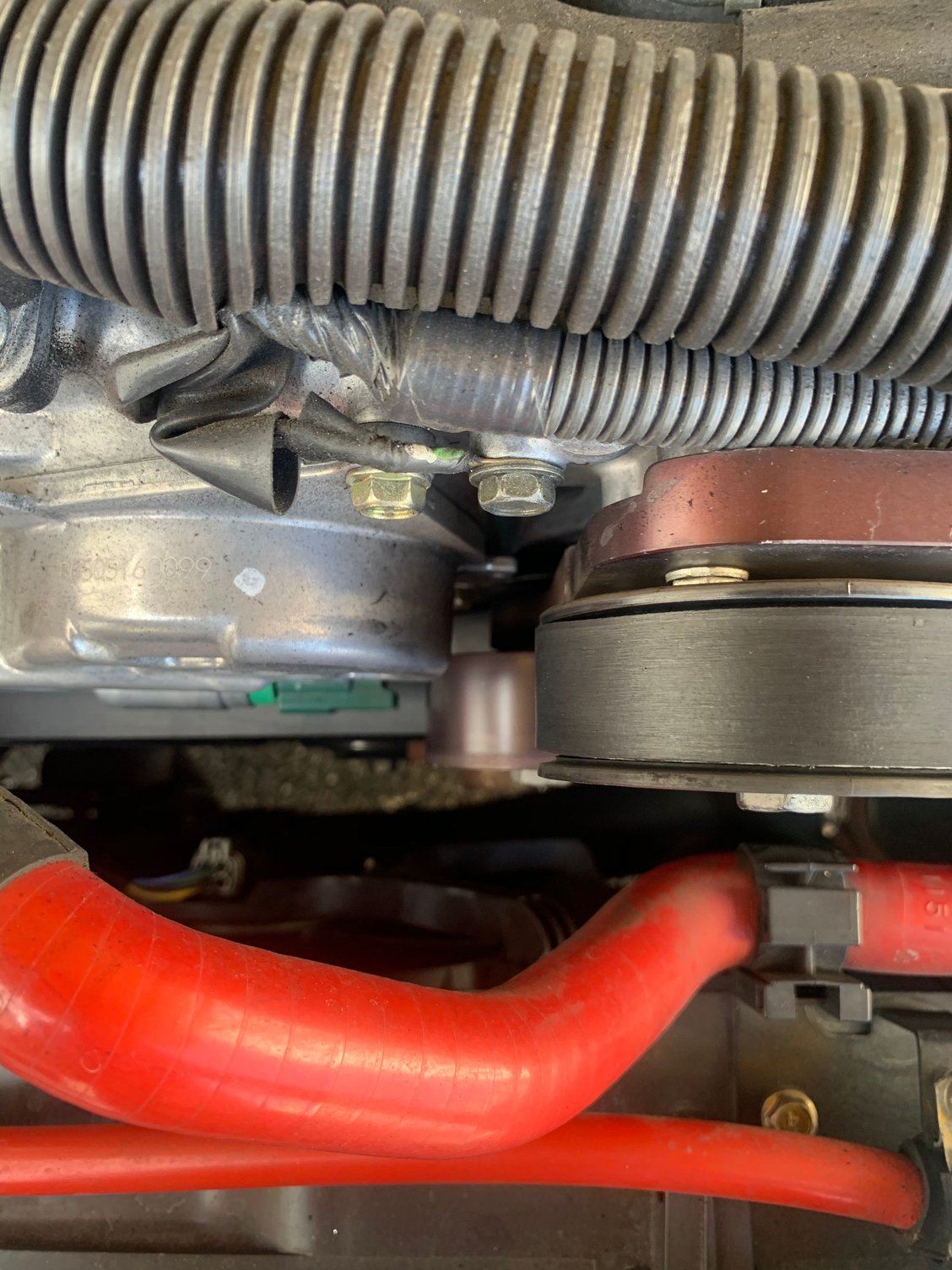

Oh oh. I think it’s the serpentine belt. Your right. I have some pics and maybe I have smooth pulley that failed.
Before I start the car up, this pulley is lined up perfectly with the belt. Once I turn the car on and turn it off, the belt moves across the smooth pulled and ends in the position pictured. Could it just be too loose? The smooth pulley jiggles around a lot.
Any input? If you think I need to replace it, know if a part number? Think loosening would help it or would it just be too loose?
Here you can see how it’s unaligned

Old Nov 21, 2020 | 11:36 AM
0taku's Avatar
0taku
Joined: Oct 2013
Posts: 321
Likes: 89
From: Central Texas
I would definitely add in extra tension if the belt seems loose.
I also recommend switching to a Gates Fleetrunner belt. It can handle tension a lot better and feels like it doesn’t slip nearly as much as other belts. (I have zero idea on the new Gates RPM series belts)
Before I ran into belt breakage at 18psi due to a bad power steering bearing failure, the Gates fleetrunner can take a serious beating. (Limped the car home with only two ribs left.)

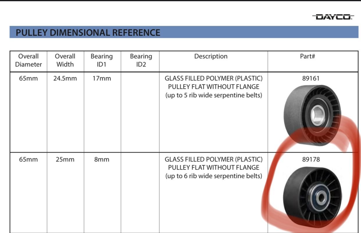

I took out one of my smooth pulleys that was causing the belt to move. The bearings are deff shot. It’s moving once the engine starts which is causing the belt to shreds on one of the fla he’s pulleys pictured. It’s probably also causing the belts to slip
you guys know if I can pick up this 2.5inch smooth pulley locally or if it’s a dayco part?
Backtracked from when I was looking for the same thing.
Hope this helps.

Hey thanks for that part number. It says it’s 3inches. I have a 2.5 inch smooth pulley.
I have the revup vortech which has a different mounting plate design and pulleys. Let me know if you guys know the part number I need or If I can swap them all to something different.
I was able to pick up a pulley, but I got another one that’s showing some wear. It’s pretty hard to track down these darn pulleys for cheap. I was able to grab a vortech one for $50 on eBay.
That’s strange, it says the diameter is 2.5in. I guess they might’ve changed it.
