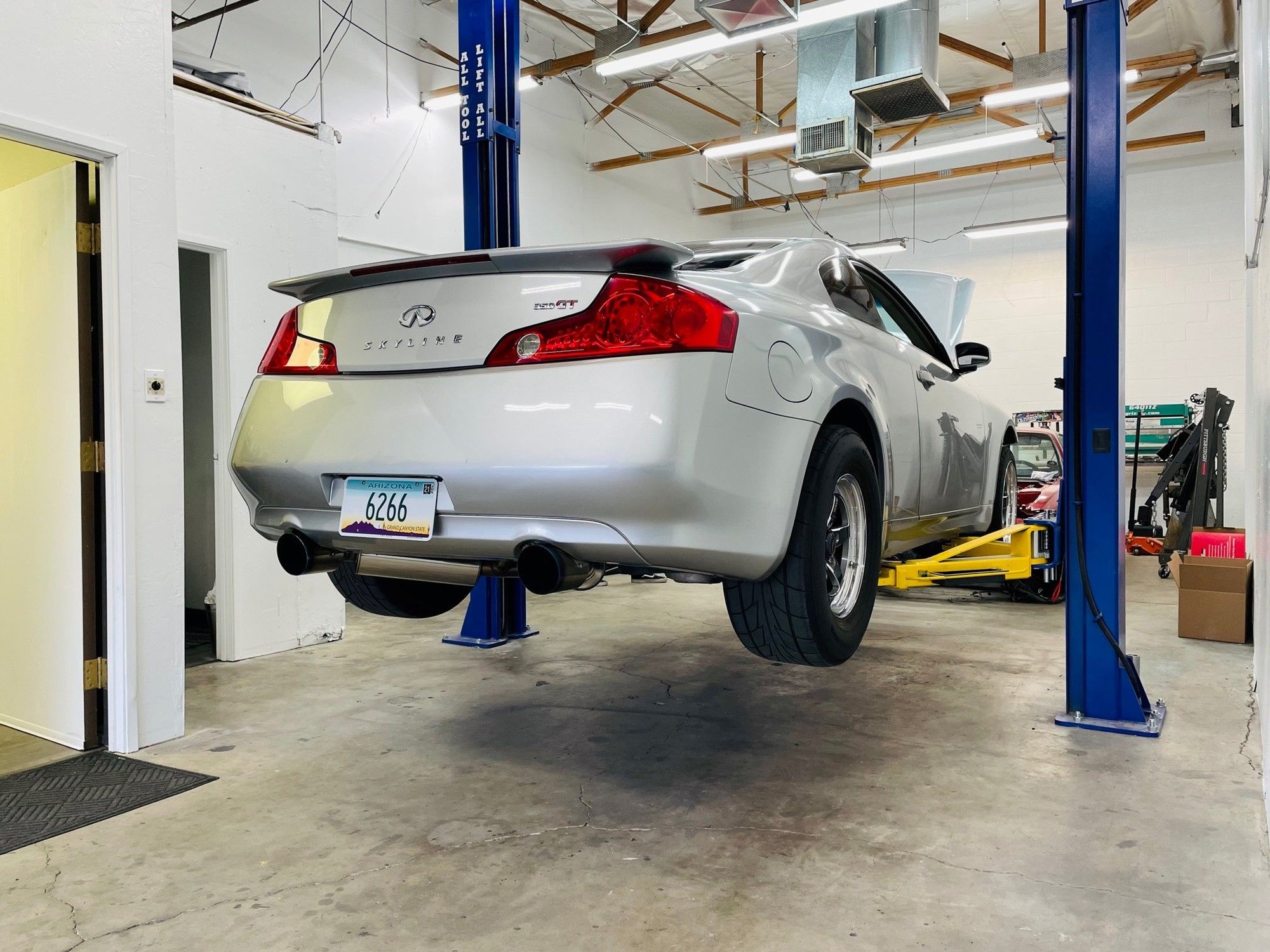

Quick update for the new year... After nearly eleven years of owning my PowerLab turbo kit, I've decided to make a substantial upgrade to the system. A few months ago I purchased a brand new GEN2 Precision 6870 turbo with an S compressor cover and a 0.96 stainless v-band in/out exhaust housing. And after a few weeks of collecting all the necessary parts to upgrade the turbo, I finally dropped the car off at my local fabrication shop (Wild Child Innovations) for a new up-pipe and a 3.5" down-pipe.
I'm upgrading from a Garret GT35R/Pure 6266 hybrid turbo with a 3" down-pipe. The car was previously make just over 650whp at 20 psi. Looking to turn the car up to 750whp with the stock camshafts/valvetrain for now.

Torn down and headed to fab shop

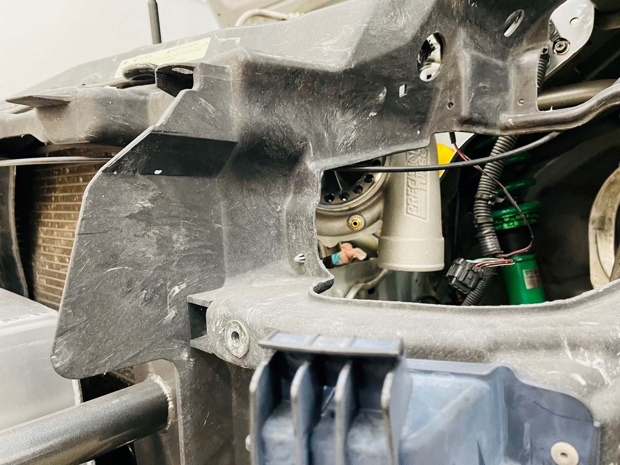

New up pipe's completed and turbo's mounted

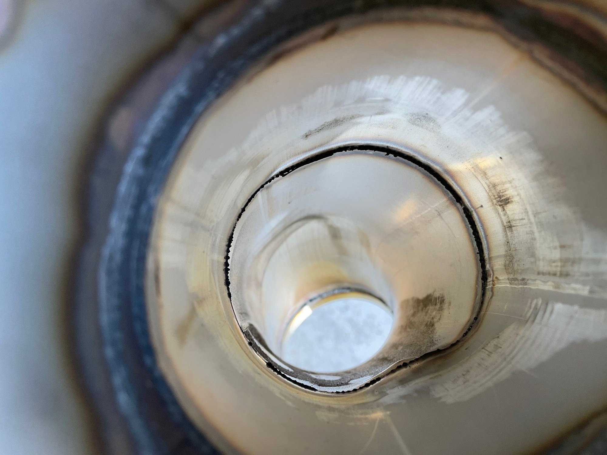

Well guys, I got completely hosed by the fabrication shop (Nick Gross @ Wild Child Innovations in Tempe, AZ)... the work was completely unacceptable and unfinished, this is just the tip of the ice burg...
This is the v-band assembly he added to the crossover pipe feeding the turbo:

were those mig'd?
that sucks ... did you tell him youre unhappy with the work?
what's the next step forward?

If you want welding like that send it to me...I can do that with my 0 experience and a stick welder.
Real talk though, that is super shitty of the dude. Like can the dude not TIG or did he just take the easy way out and MIG without back filling?

especially a piece that is gonna be seen by EVERYONE when the hot side is off!
any of that **** gets through your turbo & IC it's bad news...
