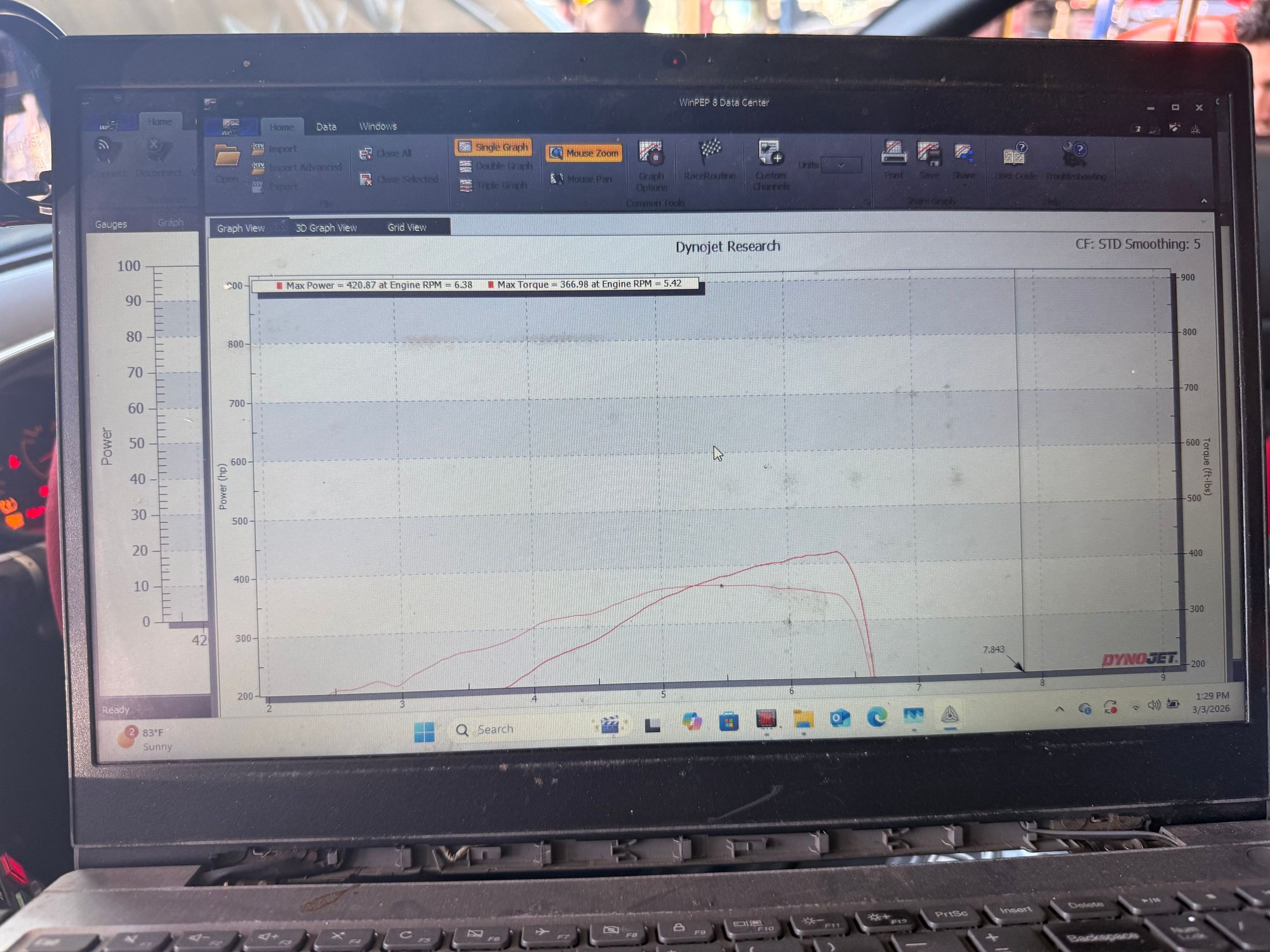

If this helps, here is my graph. Kinetix V+ Plenum and DC sports headers, 100mm pulley 93octane.

Why is the graph scaled so high 😆 the torque curves actually seem pretty similar, yours is just *more* obviously lol. It doesn't seem to have the dip that I do around 5.3k, I tend to notice it when doing a pull and then it feels like it picks back up towards redline. It's not that bad, I just wish it didn't have the dip.
